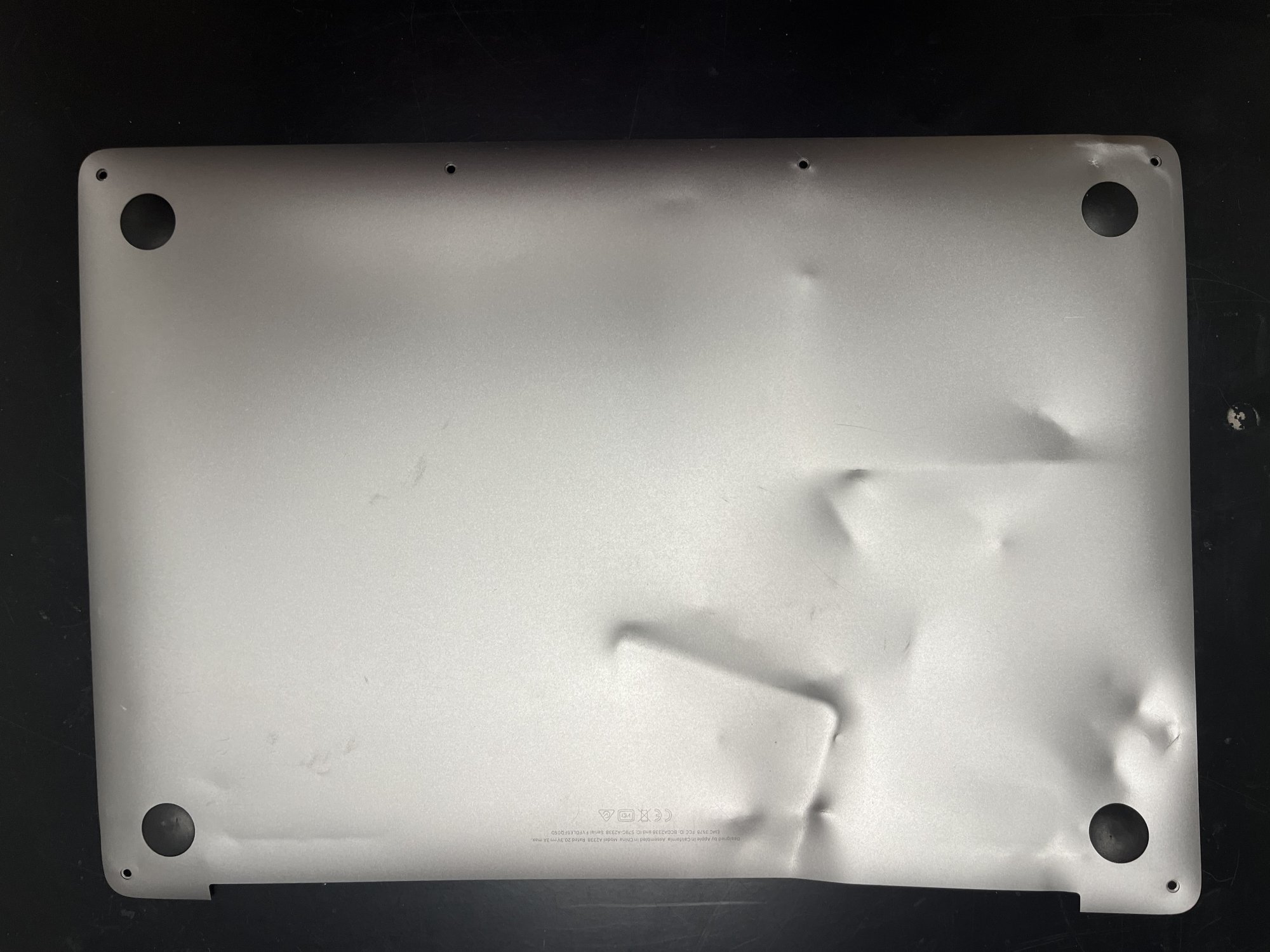

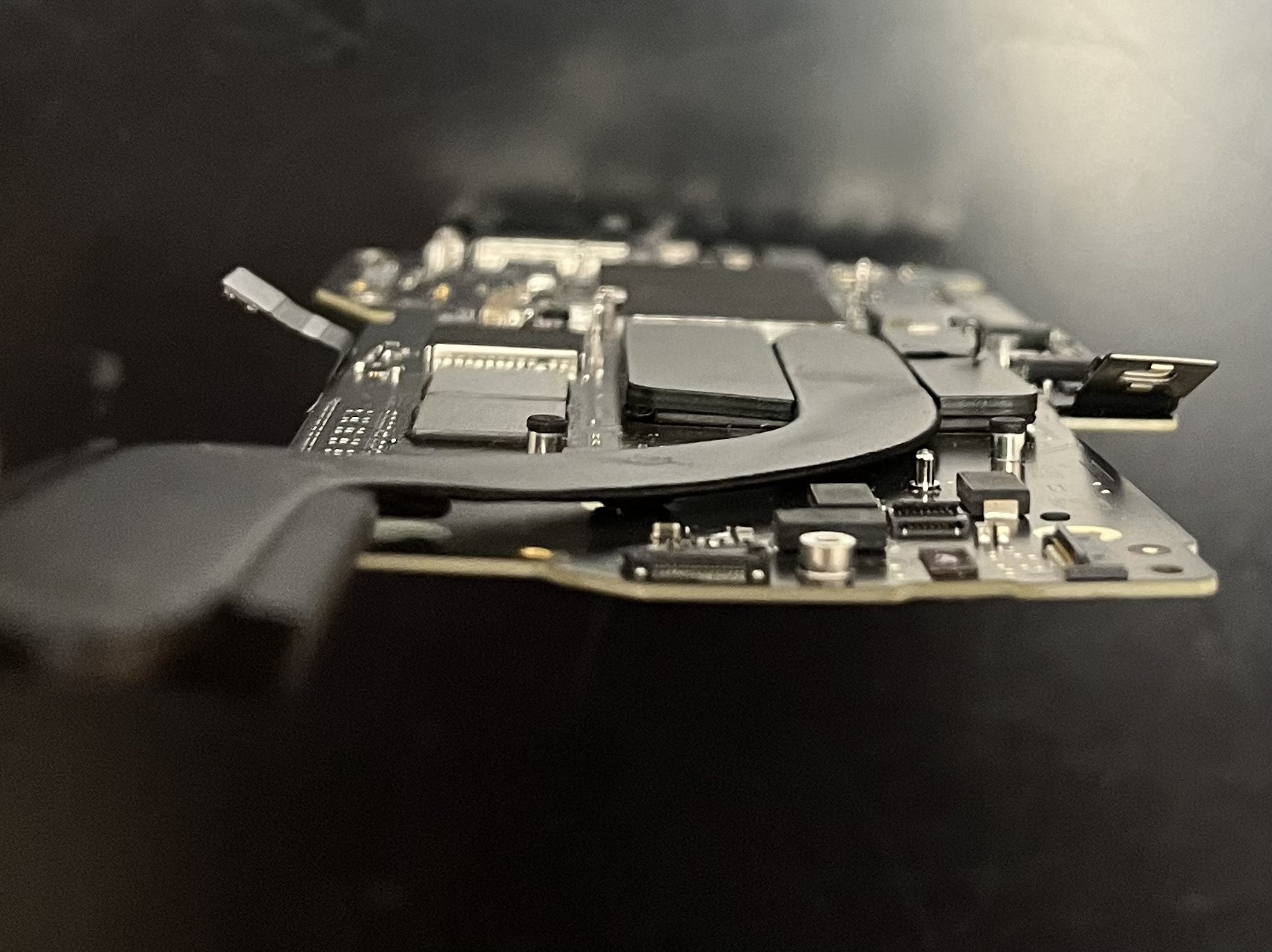

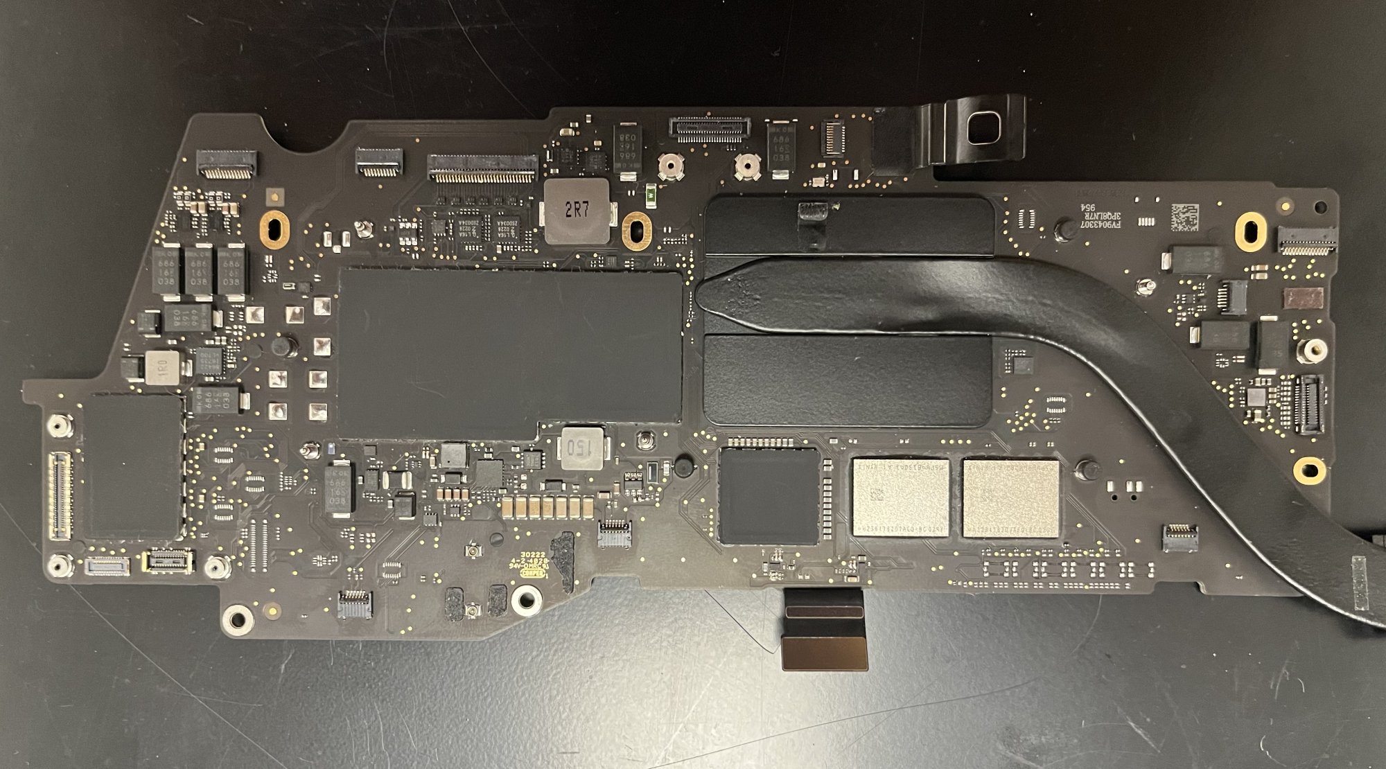

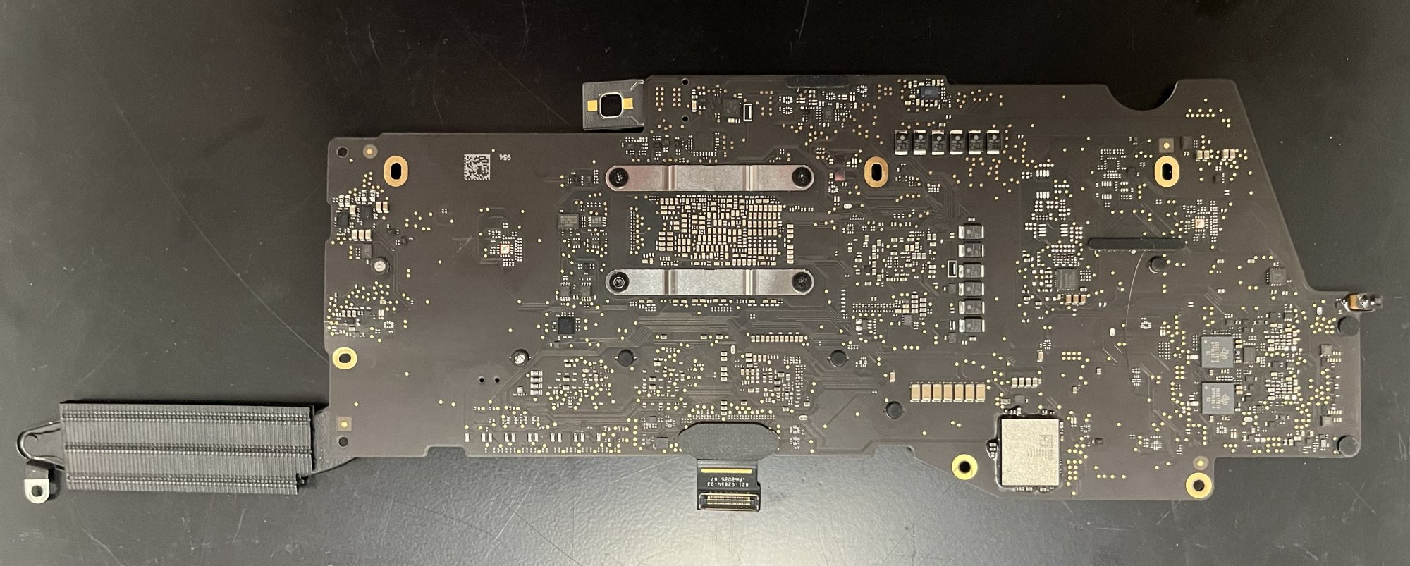

This laptop fell out of a car. Not really sure to what extent it was ran over, but it does have a large indent on the bottom side. With this being an M1 Late 2020 Macbook Pro, I cannot simply remove the drive to retrieve data. The logic board has a slight bend, particularly where the heat pipe is, as that is where the impact seemed to be made. Does anyone see any irregularities (aside from the obvious bend) that could help give me insight on the root issue? I do not see any definitive cracks or shattered components. Thanks.

We do not need it to work for long, just long enough to get the data off of it.

Indeed, backups are great. For the record, I'm trying to recover this for a friend. A data recovery service would have to repair the logic board to get the data out if I'm not mistaken... good for security but would cost a lot of $.
Yes. No boot & no sign of life. We do not need it to work for long, just long enough to get the data off of it.

Correct.
Apple said:
The Secure Enclave includes a unique ID (UID) root cryptographic key. The UID is unique to each individual device and isn’t related to any other identifier on the device.
A randomly generated UID is fused into the SoC at manufacturing time.
Apple said:
sepOS uses the UID to protect device-specific secrets. The UID allows data to be cryptographically tied to a particular device. For example, the key hierarchy protecting the file system includes the UID, so if the internal SSD storage is physically moved from one device to another, the files are inaccessible.
Apple said:
Internal storage with FileVault turned off​
If FileVault isn’t turned on in a Mac with Apple silicon or a Mac with the T2 chip during the initial Setup Assistant process, the volume is still encrypted but the volume encryption key is protected only by the hardware UID in the Secure Enclave.
