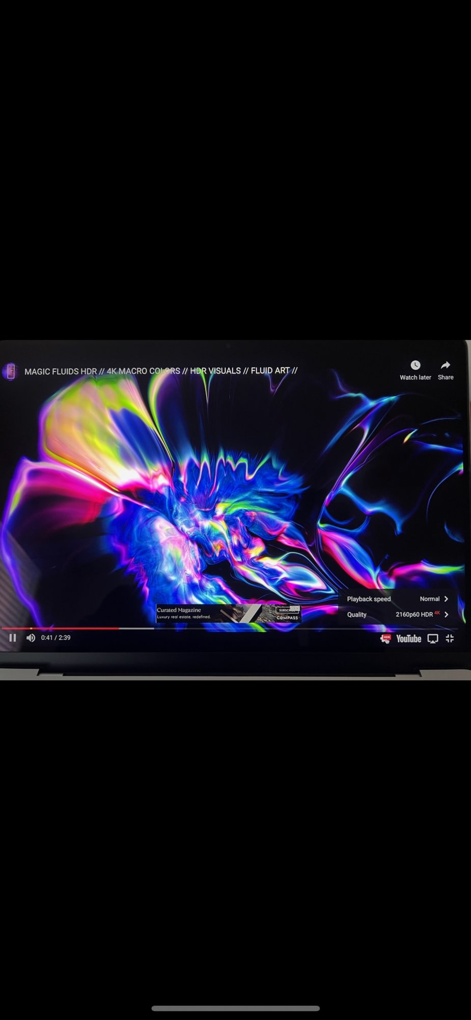

Safari/DEVELOP/User Agent = Google Chrome Windows… YT 2160/4K/HDR worked…..boom, crash, panic. 
Safari/DEVELOP/User Agent = MSFT Edge…. YT 2160/4K/HDR….. boom, crash, panic…
So… basically, 2nd machine straight out of box has same behavior

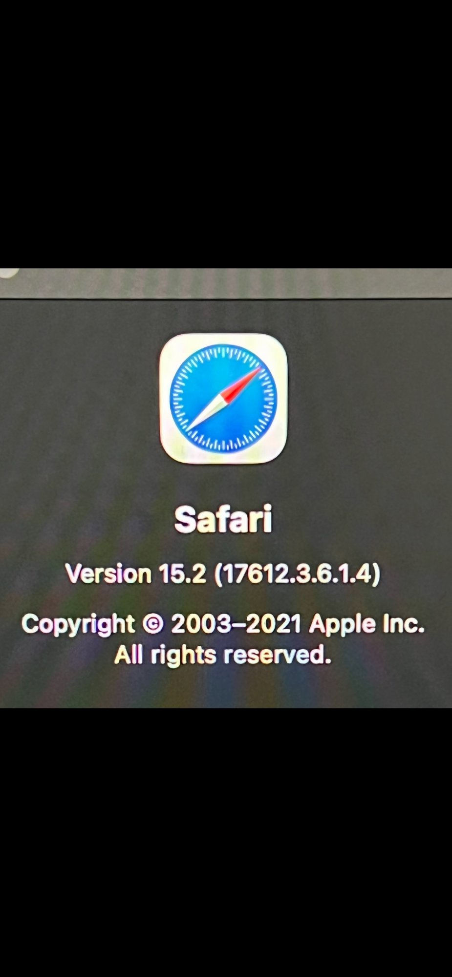

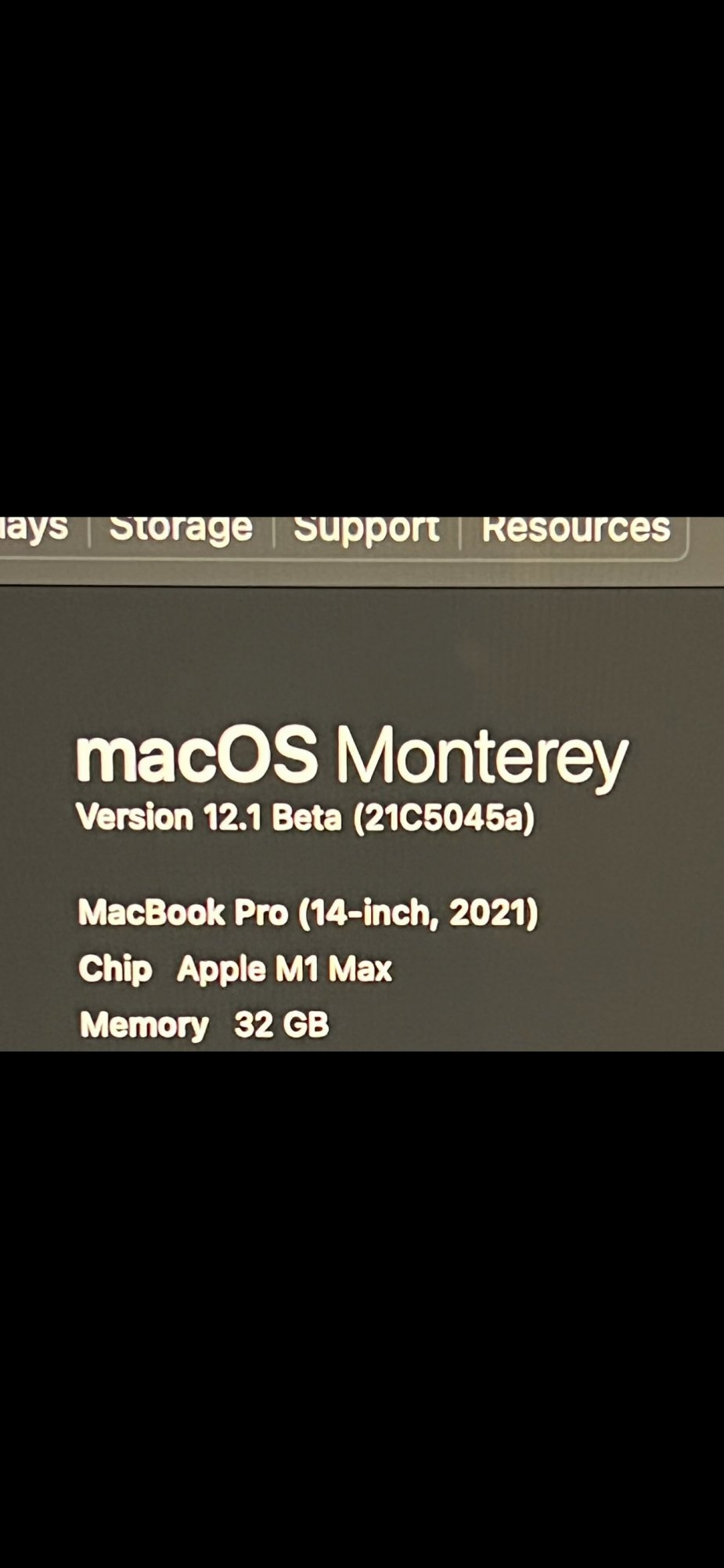

Enroll in PUBLIC BETA program for Monterey OS.
Install Monterey 12.1 BETA 4 (21C5045a) which included Safari 15.2 (17612.3.6.1.4)
Shut down, reboot, check for updates (none) head back to YT… for more HDR trials
Safari User Agent = DEFAULT…. No HDR on YT
Safari User Agent = Google Chrome Windows.. YT 2160/4K/HDR…. SUCCESSSSSSS… tried for 2 days to make it fail, and I failed…. It worked with every different HDR video that crashed it before…
Safari User Agent = MSFT EDGE… YT 2160/4K/HDR…. AGAIN SUCCESSSSSSS… tried to make it fail, and again I failed…. It worked with every different HDR video that crashed it before…. With Agent EDGE, I got a warning from Safari I was using an outdated profile, but no weird happenings.
SO – Monterey 12.1 B4 with Safari 15.2 was stable, and although I could ONLY get HDR using the non-Safari User Agent, I had zero crashing…. But wait, there is more…
