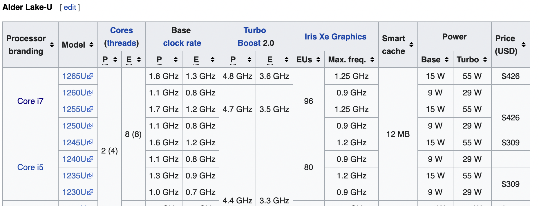

Just to add a bit more:
That's a screen shot of Intel's offerings in ultra-low power CPUs. Notice anything? The chips with higher base clocks are always consuming more base power. This is due to that voltage increase needed at higher frequencies.
