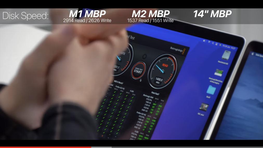

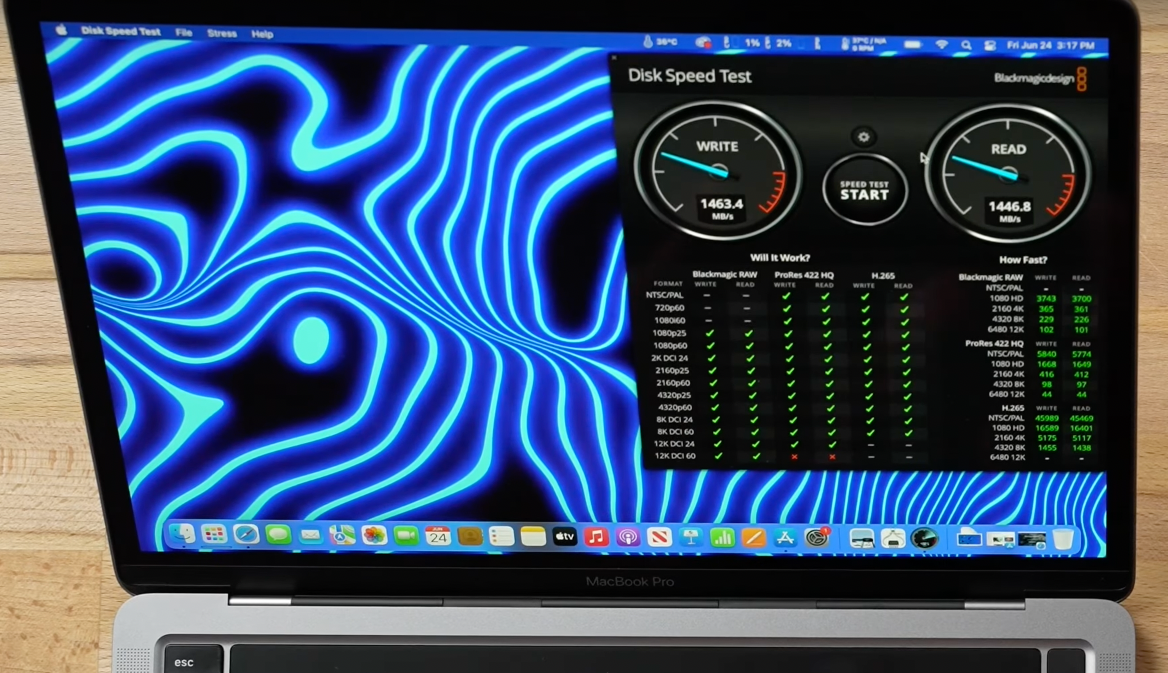

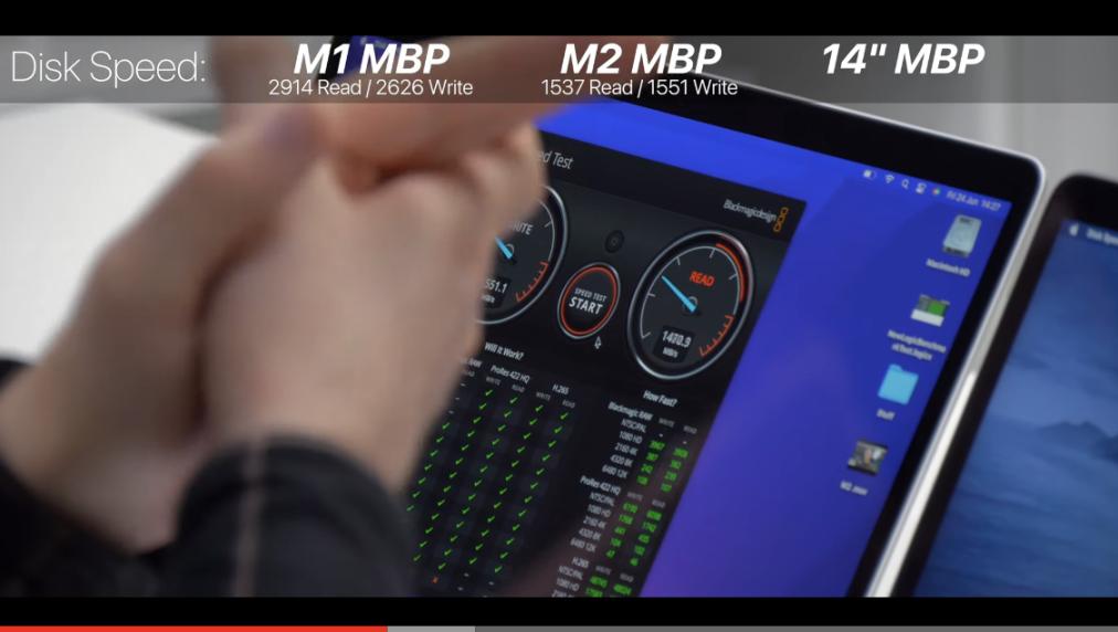

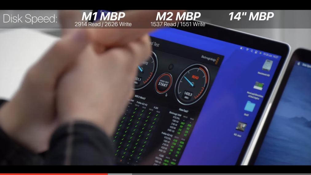

Okay, there are a couple YouTubers who have done BlackMagic Disk Speed Tests on the M2 13inch MacBook Pro, and have found that the speeds are SLOWER than the M1 13inch. I've done some investigating and discovered what I think the difference is.

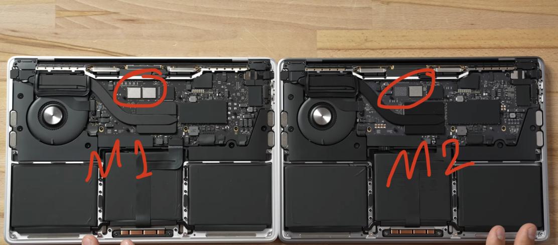

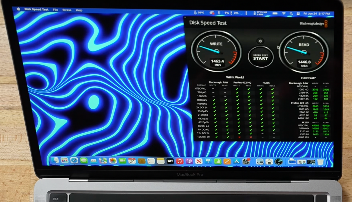

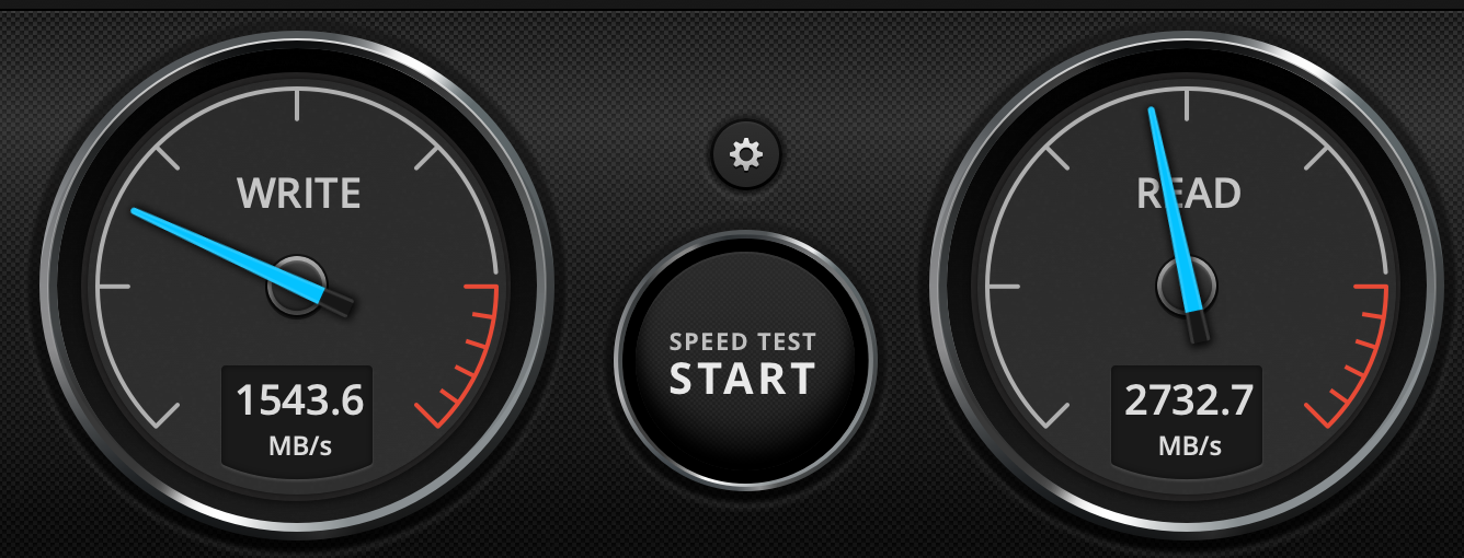

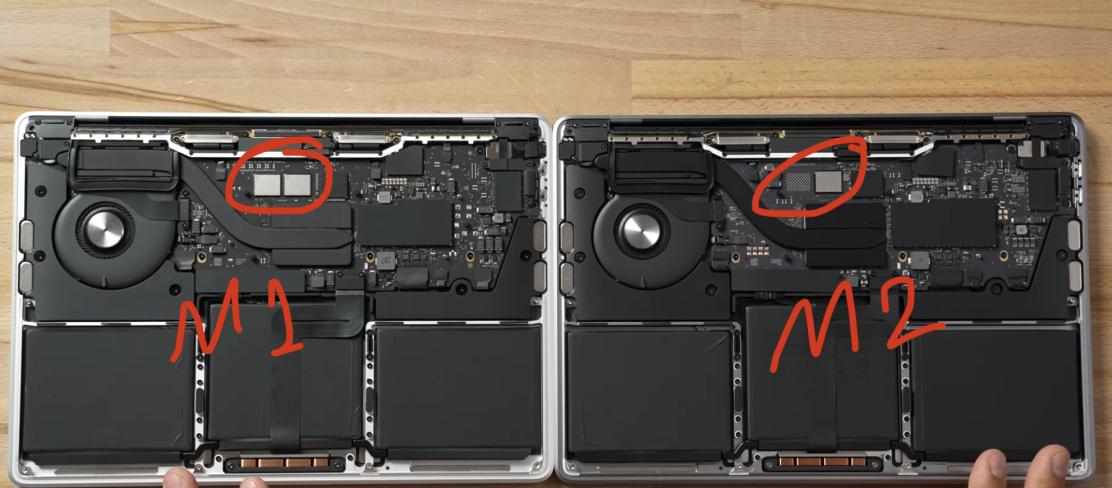

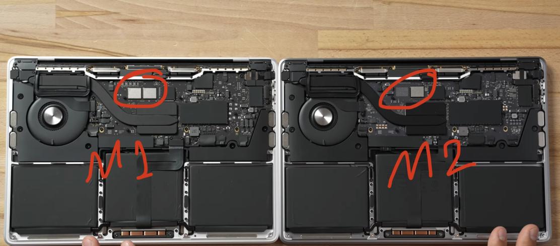

MaxTech got a write of 1463 MB/s and read of 1446 MB/s, give or take a few MB between each run. His model is a 256GB. He opened it up, and showed that Apple is now using one 256GB NAND chip for it, while the M1 has 2x 128GB NAND chips.

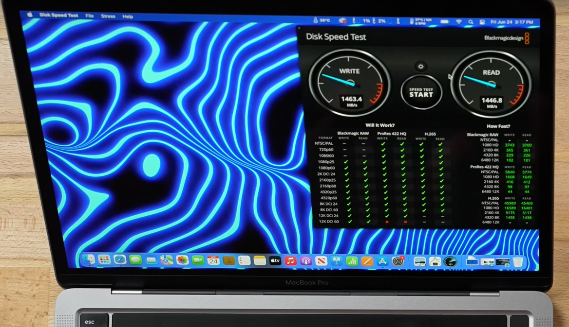

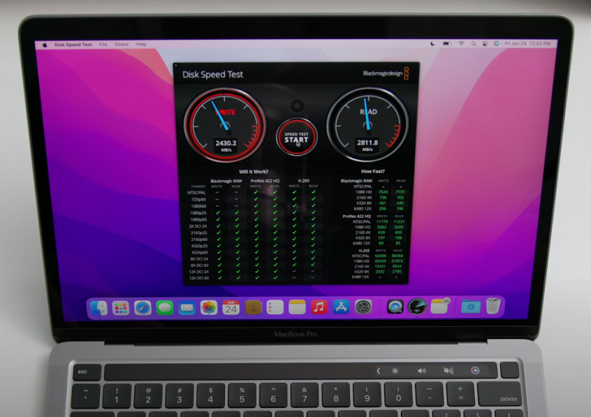

zoneoftech also got similar results on his 256GB model.

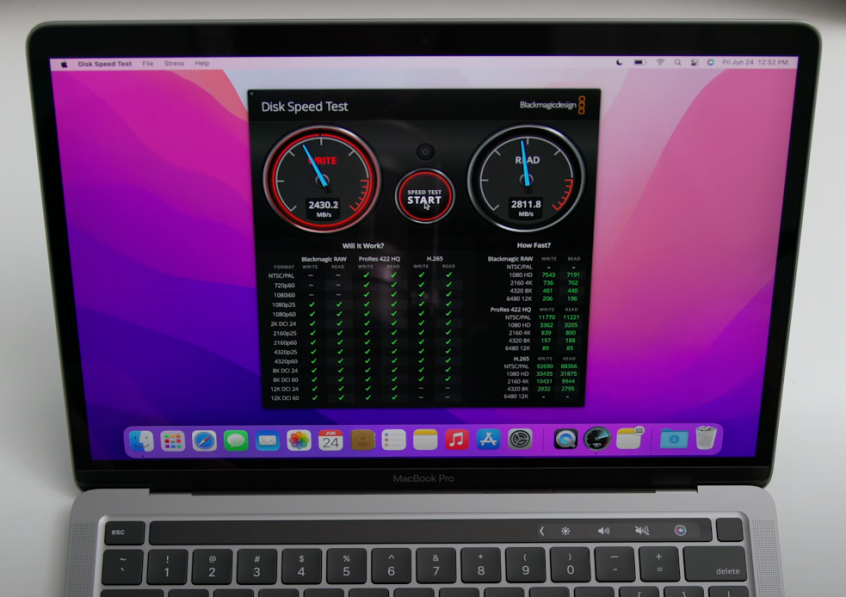

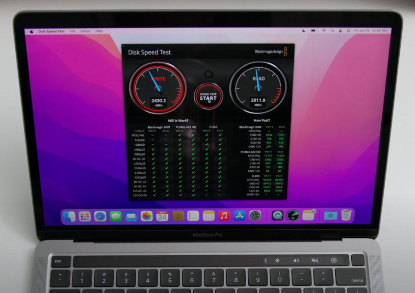

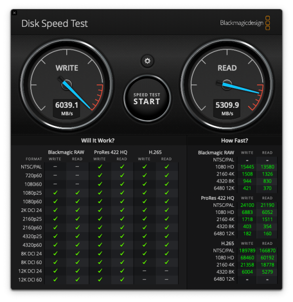

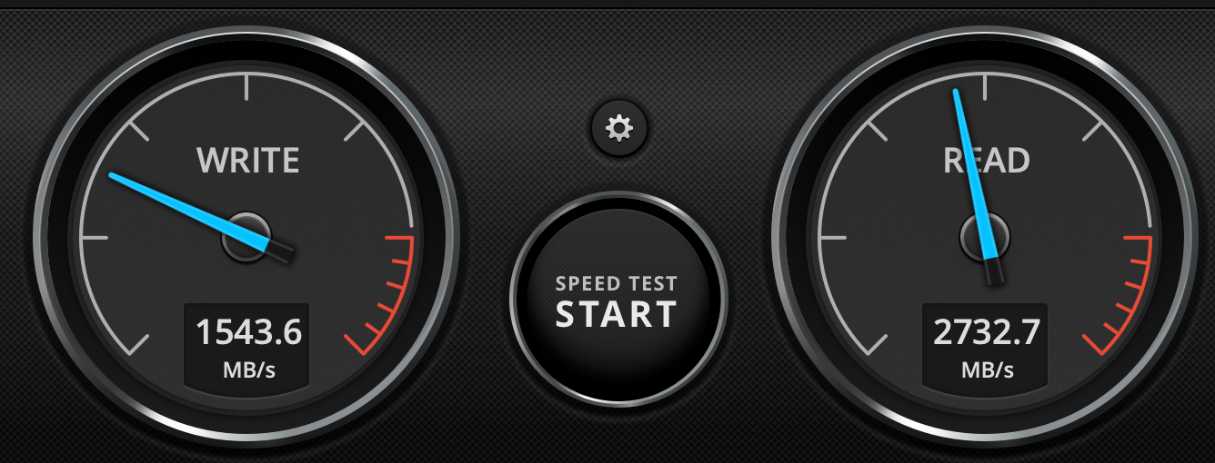

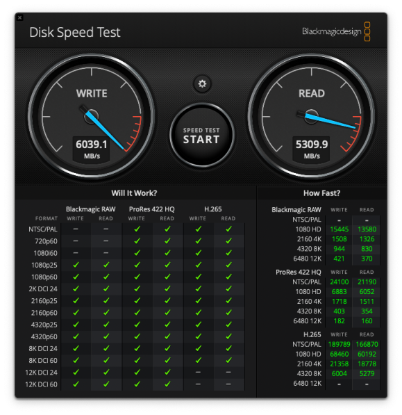

Meanwhile, zollotech got very fast speeds on his 512GB M2 model.
So basically, it appears Apple is using a single NAND chip for 256GB models, and likely 2x 256GB chips for 512GB models, which is the reason for the faster speeds with 512GB. It's likely Apple is using 2 NAND chips for every capacity over 256, so as long as you get a model with 512GB or above, you should not see a reduction in speed.
MaxTech, for one, is already using this to say that Apple made the M2 machine worse. For the 256GB model, yes. But someone pointed out to me that 128GB NAND chips are being made much less anyway, and the majority of them are made for phones. It may just be a supply issue that caused Apple to go with single 256GB NANDs.
Most people, I would think, would get 512GB or above anyway.
I think you underestimate. The standard retail configuration for non-Apple resellers is the 256GB. Which means all those stocked/bought at Best Buy, Nebraska Furniture Mart and similar is what the majority of people end up with.
You're probably right. So, my hope is prospective buyers see this and if 2000MB/s+ read and write is important to them, they will get a 512GB model or higher.

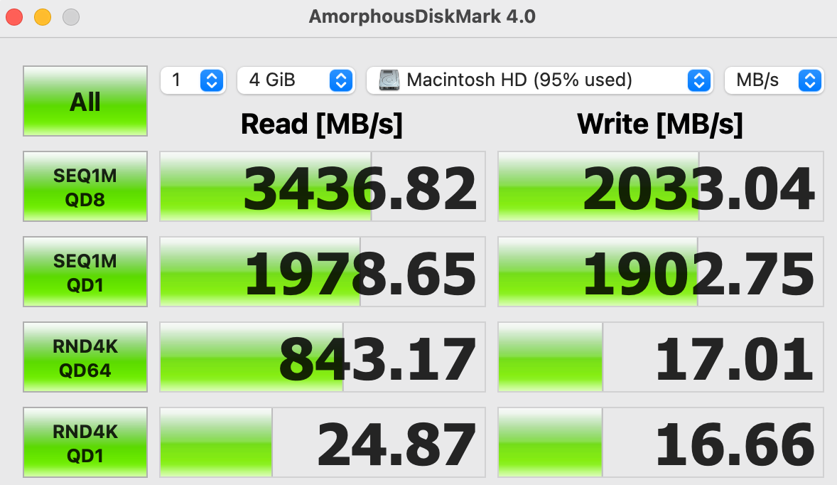

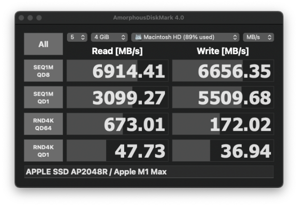

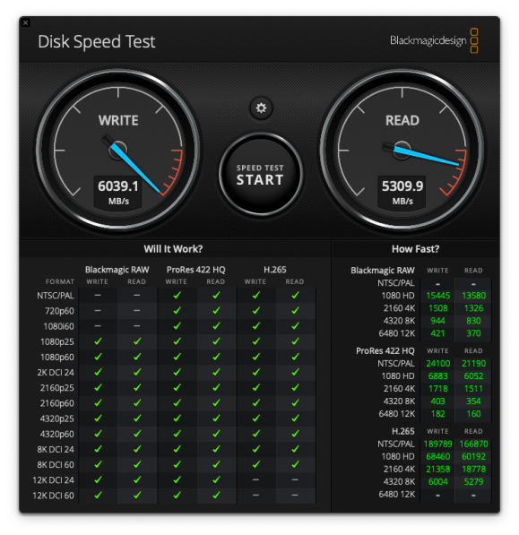

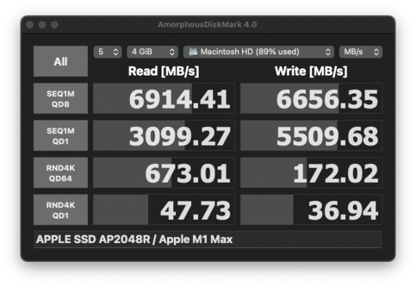

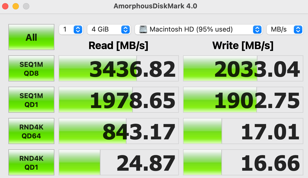

Does anyone else get significantly different SSD read/write speeds between Blackmagic and AmorphousDiskMark tests?
I set both to 4GB on my 2018 MBP, and the results are as follows:
Are you using the same test data samples on both these apps? Amorphous shows 4GiBx1 and it should be the same on Blackmagic to get an accurate assessment.
In any case, modern SSD speeds tested with Blackmagic are completely pointless since it only test sequential read and write speeds. Sequential R/W performance is the least important metric when gauging day to day performance of a SSD.
Yes, AmorphousDiskMark only does powers of 2, and Blackmagic does 1..5, so I set them both to 4GB.

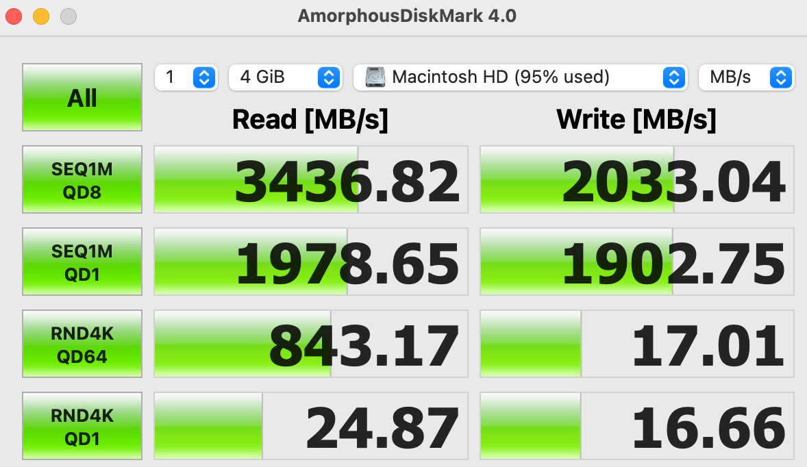

I'm guessing that when you swap back memory when switching to an app or to tabs that you've not used in a while, those are multi-MB sequential reads. The sequential writes happening in the background probably aren't critical, but I'd guess that the sequential reads are.
Reactions: yitwail

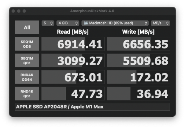

I also have the same discrepancy on my M1 Max 16inch.

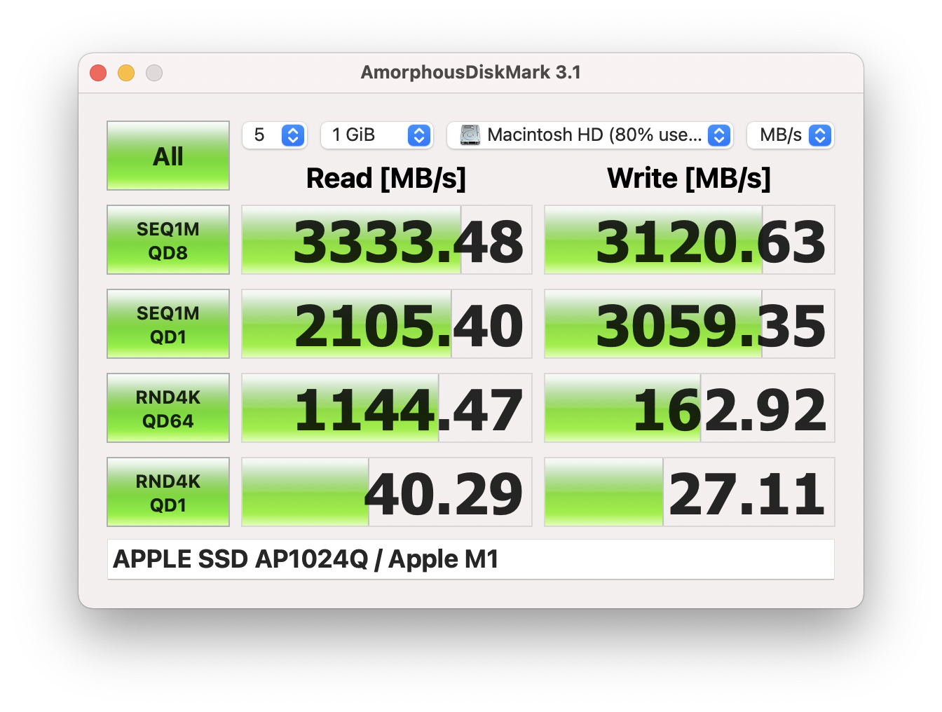

Now this is very strange - I found a blog post here https://blog.greggant.com/posts/2021/03/25/amorphousdiskmark-is-crystaldiskmark-for-mac.html that shows that the RND4KQD64 read performance on an M1 Air is better (1144 MB/s) than on the M1 Max MBP 16 (674MB/s)....
Although the blog post is for 1GB and the benchmark from this thread on the M1 Max is at 4GB, so I wonder if the M1 Air was returning cached data from RAM... If so, then maybe all of these benchmarks are useless.
