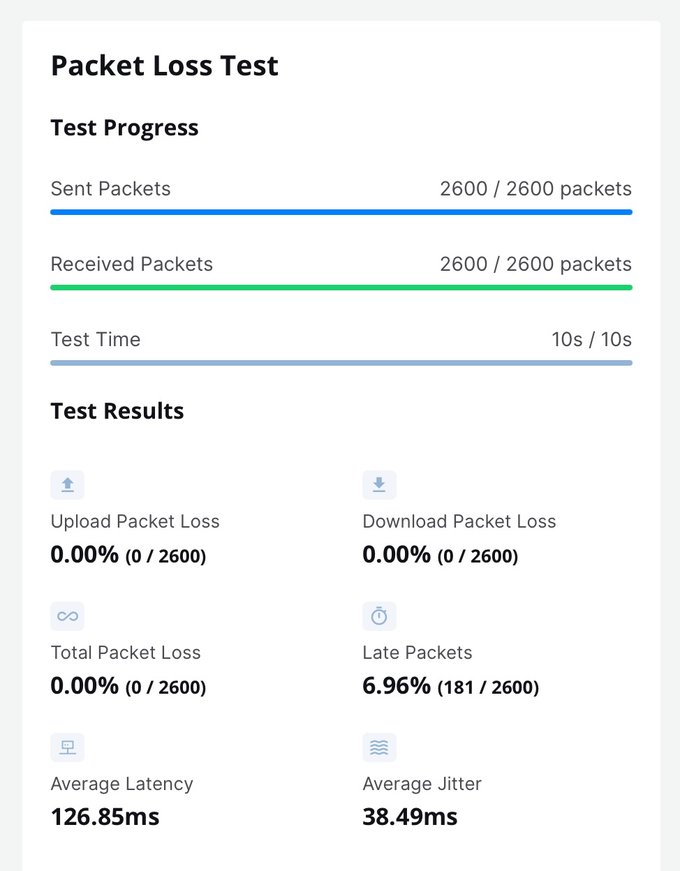

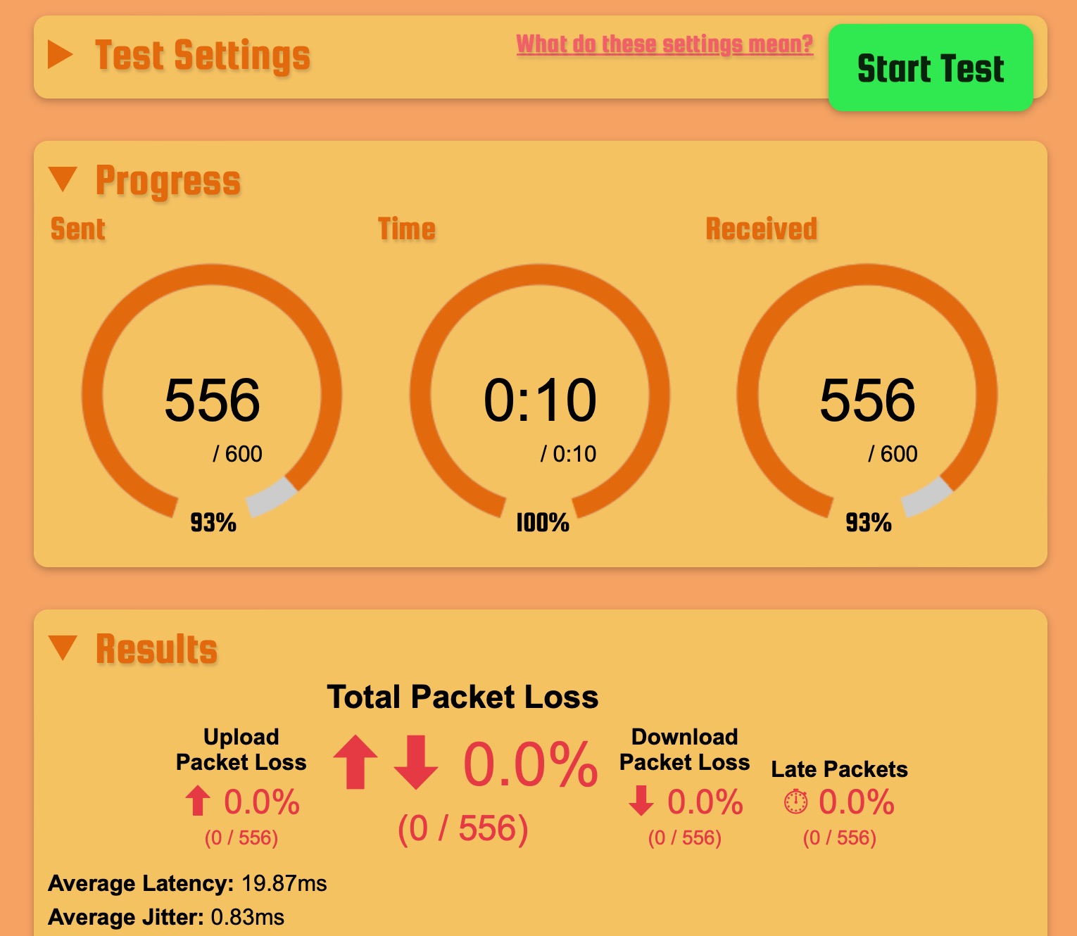

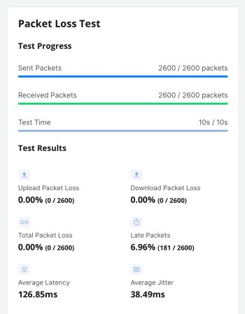

Hey everyone, got my base spec M2 Pro Mac mini yesterday, at my local Apple Store.
This morning I tested my unit, curious to see if I encountered the problem described here, but I am happy to say that my 1gb Ethernet connector is working perfectly fine. I ran various packet loss tests using this and this websites, and I got 0%. Screenshots attached, if it helps.
Don't know if this might be useful, but I live in Italy so my unit is a Europe market one.
