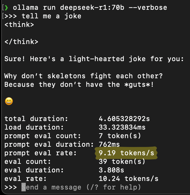

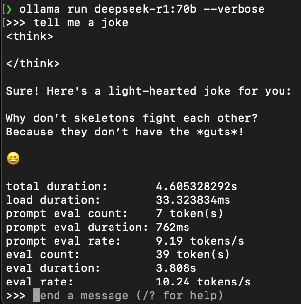

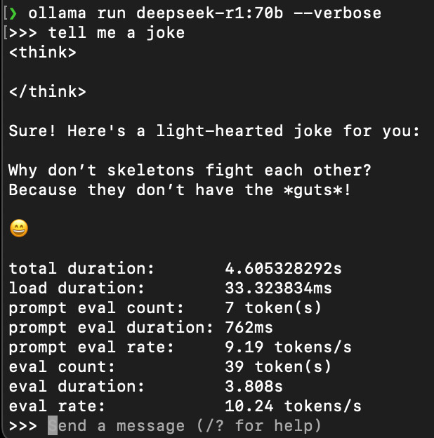

As for performance, with llama-3.3 which has 70b parameters, inference speed was about 10 to 12 tokens/s. It's useable. Anything below that would be too slow.
But when you run a large model for the first time, it would take some time to load.
For deepseek-r1, the 70b model was slower, barely touching the 10 token/s mark.
Because of the reasoning process, it's usually much slower to give answers. For the simple `tell me a joke` test, there is no thinking process, so it's relatively faster.
If you ask it a more complicated question, such as a math question, it would struggle more.

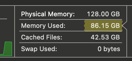

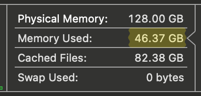

For memory usage, during inference, the 70b models could use about 40G-50G memory. After the completion, the memory would be released. Ollama seems very good at managing the usage on-demand.
During inference:
After inference:
