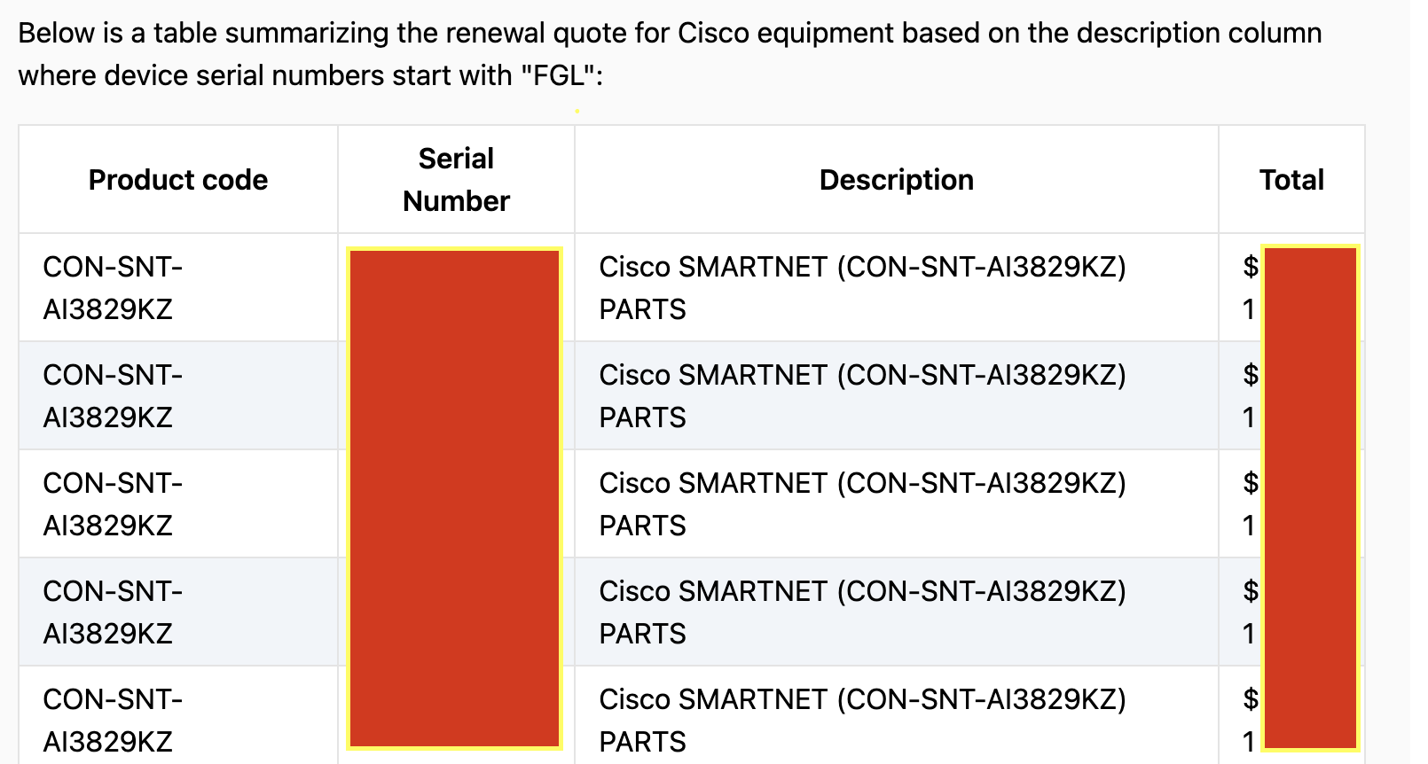

Just last week, I had a quote with a bunch of columns in it for some renewals and I asked the LLM to do this with the PDF file dropped into it:
attached is a renewal quote for a bunch of Cisco equipment. in the "description" column, the device serial numbers are listed, they start with the pattern FGL.
please create a table consisting of the following values: product code, Serial number, description, total
The serial numbers were not the only thing in the column they were contained in (description column had other info as well). The quote contained much more than the table, disclaimer, terms, company logo, contact details, etc.
It nailed it, it even picked up serial numbers I didn't tell it about because they didn't start with FGL - it figured it out:

Could I have done all this manually? Sure, but the local LLM did it in a matter of seconds (12 seconds from PDF to table - model: deepseek-r1-distill-llama-8b). It would have taken me an hour or so and I would have made mistakes no doubt.

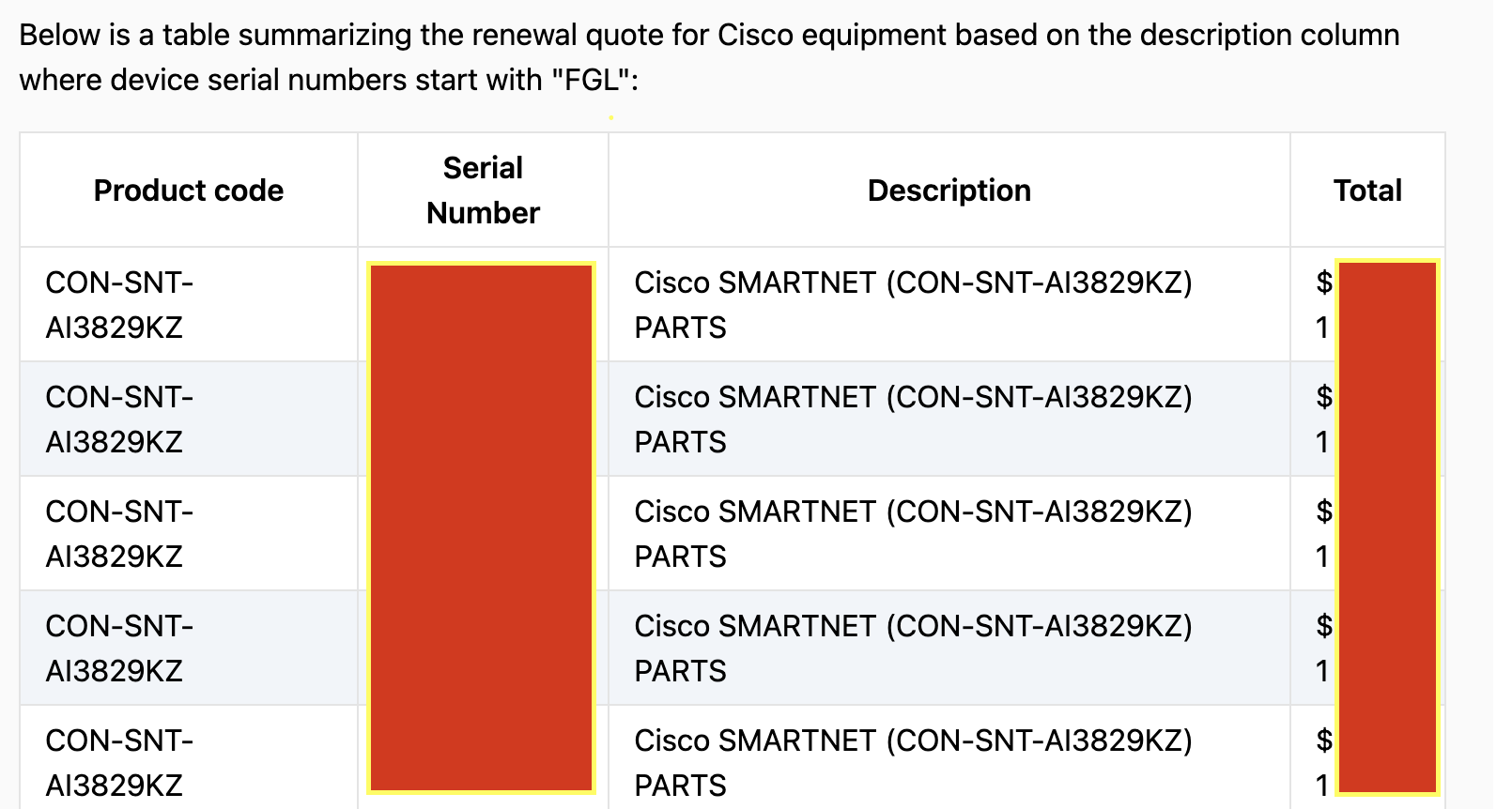

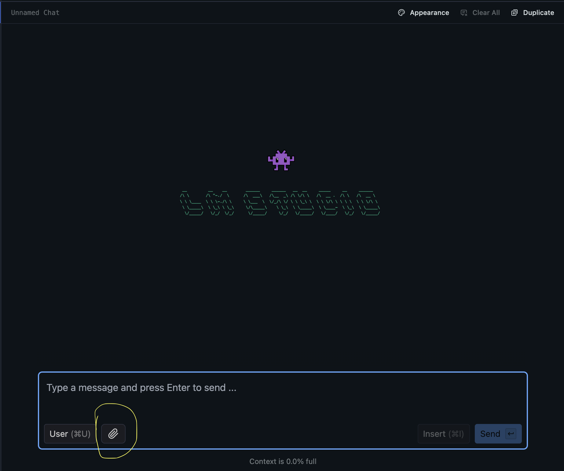

How were you able to attach files for the LLM to work with?
I am using LM-Studio, BTW.
