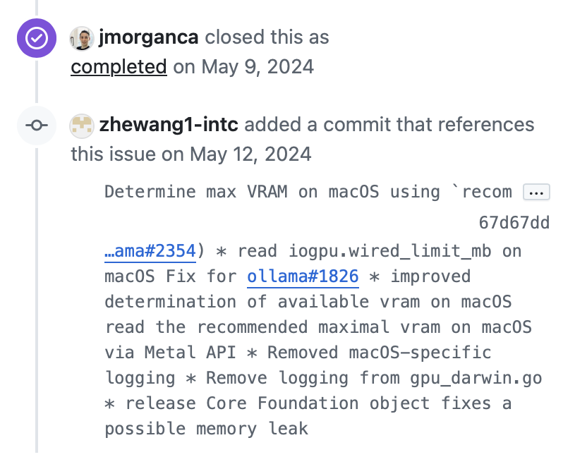

I don't really know the true limit using sysctl iogpu.
Some people say running headless and login remotely using ssh will permit more memory to the GPU.

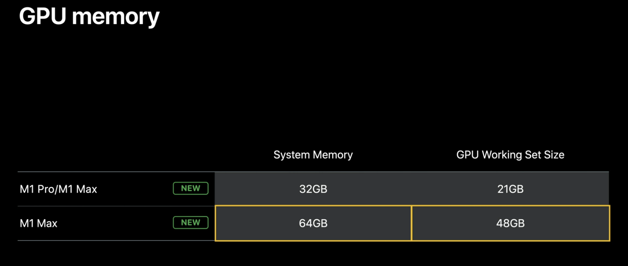

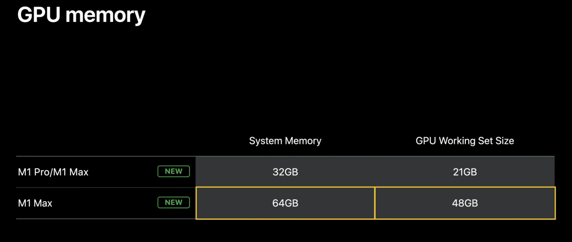

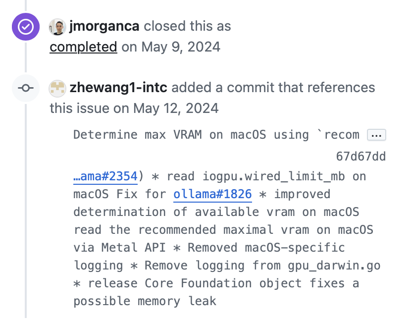

That's out of date information. It can be adjusted using sysctl iogpu on the Terminal. SeeView attachment 2479686
Just because you can adjust it doesn't mean the other info is out of date. If you don't adjust it the previous information is accurate. In games like Shadow of Tomb Raider the VRAM of my M1 Max with 32GB RAM is shown as 21. throAU said they see 48GB as VRAM out of 64 so Apple's information is still valid unless you have a link to new information.
It's out of date, because mac LLM software allow you to use more than the default 75%. (Not talking about games in this thread.)
Reactions: flybass
