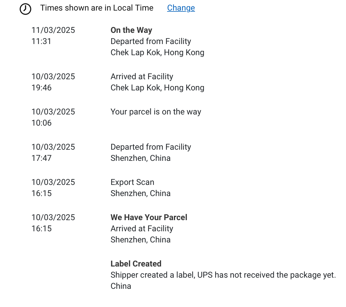

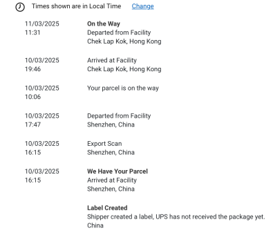

Changed again ...
On the Way
Departed from Facility
Dubai Airport, United Arab Emirates
