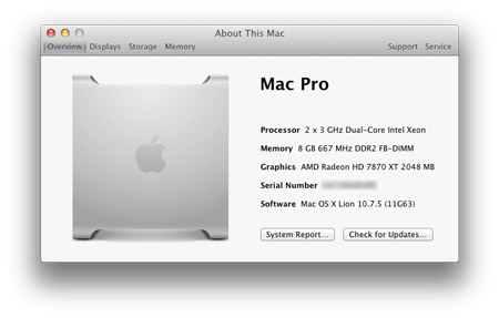

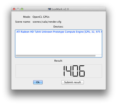

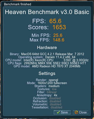

Finally got it to work!
It's alive! :D
Got my 7870XT to work in 10.7.5. Sapphire drivers ofc. Had to add DID to ATI7000Controller, because Lion version does not contain it.
Used Chameleon 2.2 r2233 with GraphicsEnabler=Yes and AtiConfig=Hamachi.
Acceleration works, card recognized properly in ASP, in GLView and Luxmark as Tahiti Unknown Prototype - but it works.
Cold bug is present, FBrotate trick does not work, maybe it's Lion incompatible... So power button is the way to go.
Some screenies below.

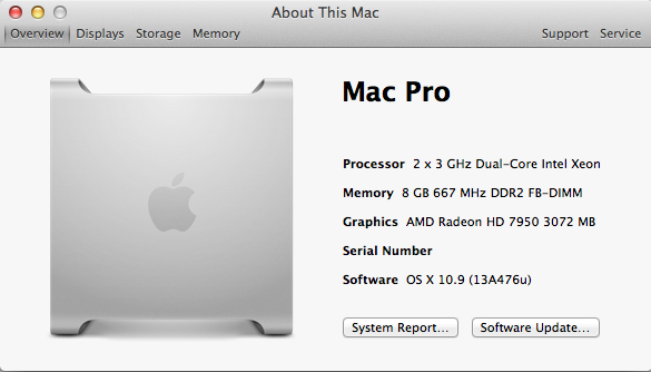

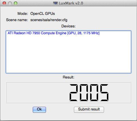

I've tried flashed 7950 in Mavericks last night.
Updated my Chameleon to 2247 as well.
Basically it works, but:
– Graphics Enabler=Yes gives cold bug but all acceleration types do work
– Graphics Enabler=No - no cold bug QE/CI doesn't work. OpenCL works.
I'll do some more tests in my spare time. This machine runs 10.6.8 as main OS, other ones are just for testing purposes.
aphexz: do you have QE/CI working without Graphics Enabler in 10.8.4? Check: translucent menu bar and ripple effect in Dashboard (it must be running not as space).
Edit: I currently use dsdt and MP 3,1 model identifier in smbios.
