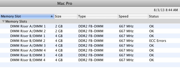

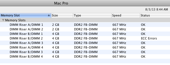

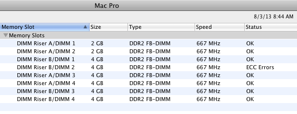

Remember to check System Information (formerly known as System Profiler) for ECC errors.
Great suggestion, will do asap

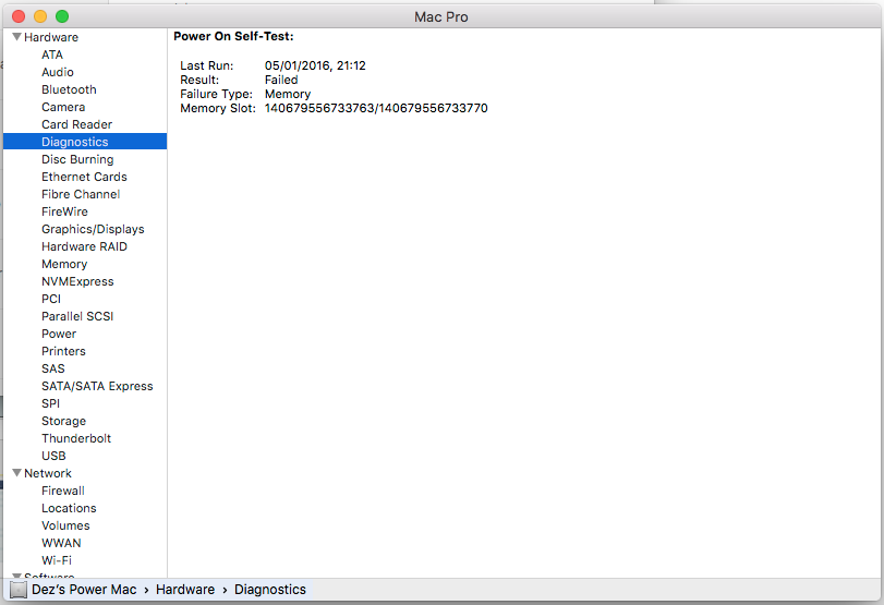

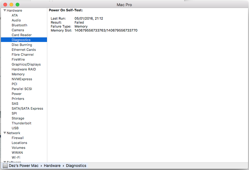

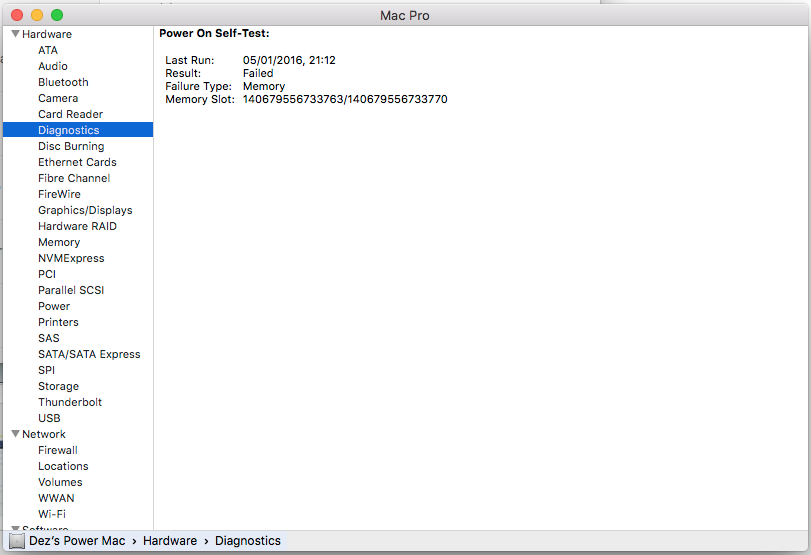

machine check errors along with your ram not showing up, points directly at RAM failure, my Mac Pro 1,1 did the same thing when i had some FB-DIMMs go bad, usually when i noticed there was missing RAM after a kernel panic, going to the diagnostics tab in system profiler told me that it there was bad memory sticks, as well as the diag LED for the bad sticks would light up
Thanks a lot. I'll go to that diagnostic tab after the next crash and see what it says.
[doublepost=1500000489][/doublepost]
Everything looking OK in there at the moment, I'll see if I can force a crash and then see what the RAM is doing.
