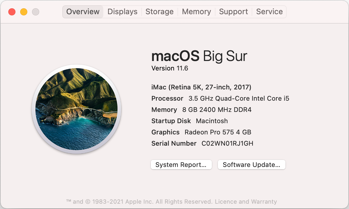

iMac:

If that is YOUR iMac - I think your game would probably be helped out with more RAM. 8GB is a bit on the edge now, and doubling that is a reasonable purchase, with a quick upgrade (probably less than 2 minutes, even with no tech experience)
Reactions: Gst95
Yes, that is my iMac. Like I said, the game runs reasonably well actually (at 60fps with high settings at 1080p resolution), it's more the heating issue I was concerned about. However, it's not as noticable on the iMac than it is on the MacBook (though I guess that's expected since it's a more compact device).
Maybe upgrading the RAM would be a benefit (seems pretty straightforward watching videos), but I can't see it being a priority at this moment since I'm trying to save a bit of cash.

I really am just guessing that adding RAM will help on the iMac -- but, you have 16GB on the MBPro, and only 8GB on the iMac.
