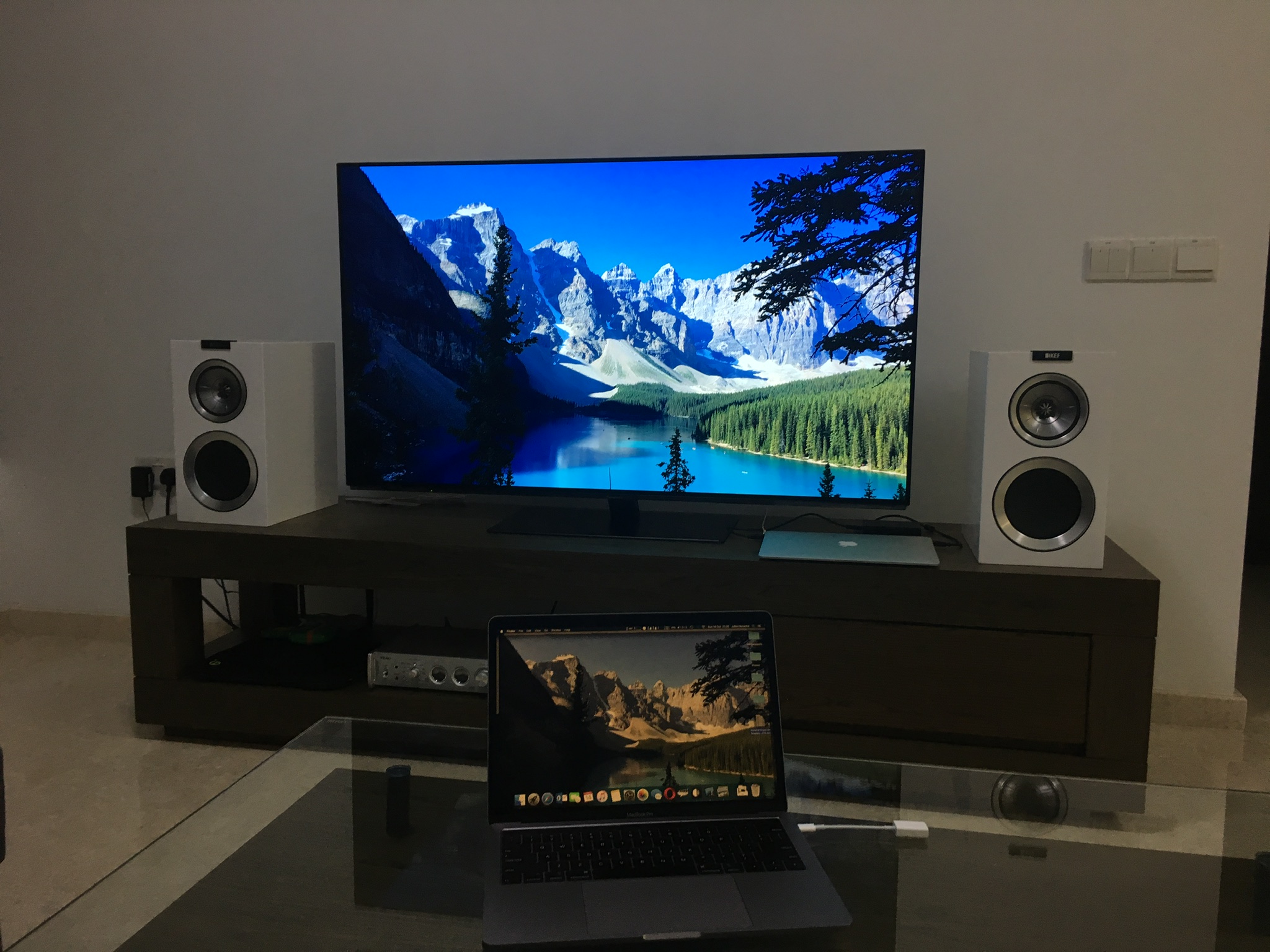

Unfortunately, I have a trouble with connecting my Mac mini 2018 with an LG 4K TV. "No signal" was showed up.
Environment
  • Mac mini 2018. Detailed specs are below.
  • LG Electronics OLED65C8PUA 65-Inch 4K
  • HDMI 2.0(4K@60Hz) cable
  • MacBook Pro 2014
  • LG 27UK850-W
Summary of compatibilities.
  • Mac mini was compatible with LG 27UK850-W with both HDMI and USB3.
  • LG Electronics OLED65C8PUA was compatible with MacBook Pro 2014 with the HDMI cable.
  • Screen Sharing from my laptop to Mac mini. Mac mini recognized the TV as "LG TV".
Summary of incompatibility
  • Mac mini seems to be incompatible with the TV.
Since MacBook Pro 2014 is compatible with the TV, Mac mini should be compatible with the TV.
Any feedback is appreciated

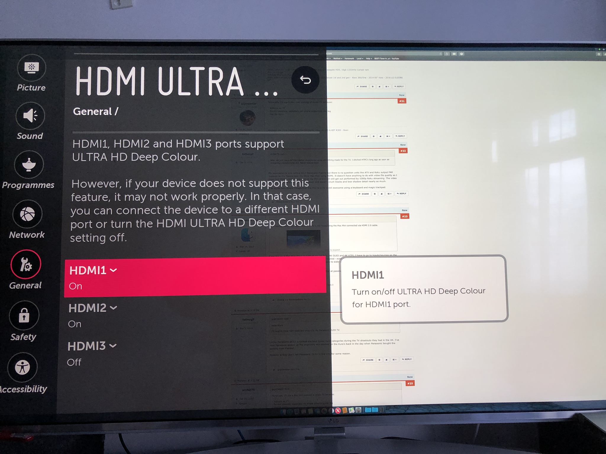

I get this on a Mac Mini 2014 on both of my LG TV's (4K OLED and 4K LCD), I have to go to inputs/sources on the remote and click HDMI 1 (or whatever port it is connected - even if the connection source is greyed out I click OK / the centre nub on the remote). It seems the LG needs to wake up to the signal. Also I tap a few keys on my wireless keyboard, then turn on the TV.
I use a HDMI - HDMI connection cable that works fine at passing 4K content from a PS4 Pro.
I am having the same issue with new mac mini 2018 and new LG OLED 65C8PUA through HDMI. TV screen as a mac monitor was quite normal from boot till I put password. Once RETURN Key was pushed after entering password the tv screen turned blank briefly and "No Signal" shows up. I disconnected all the cables, including TV Power Code. No luck. Connected to other HDMI ports but no luck. Cable box and OPPO blue ray are working fine with all the HDMI ports. Only Mac Mini is not working. Connecting Mini to my Samsung 4K was no problem. I called Apple Tech. She said Mini is ok but LG TV is the cause. I'll contact LG.
What does the mini output via HDMI, is it 4K60p or something else? Have you tried changing the input on the LG to ‘wide color’ (I can’t recall the exact name LG uses). It could be a color space mismatch that’s causing it. My MM is coming tomorrow and I have 2 LG OLEDs. So I’m curious too even though I don’t envision leaving the MM hooked up to it.
