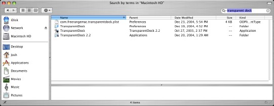

Hows the best way to do this.
1. how should i reset the dock, if i unstall w/o reseting will it it update the dock to normal or should i reset from with in the program
2. should i just drag the folder to the trash or do a search get rid of everything that comes up?
I did a search and this is what came up....

I really don't know since I don't install those sort of things. Does their website give any clues? I'm sure they've had enough questions about compatibility by now and how to remove it temporarily.
