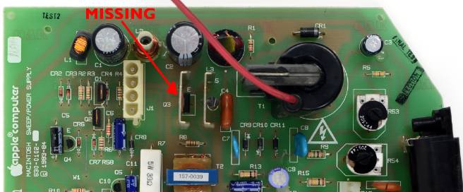

transistor Q12?
Hello, cheers from Italy.
...I hope you solved all...
I see you have same model I have.
I need instead some help: i opened my mac plus and i found the transistor Q12 (under ther transformator) broken... Now i am not able to read the model to find a spare part, and I own not the electrical scheme of the analogue board. Can you please indicate to me the model of this component (e.g. BC108) looking at the analogue board of your mac plus?
Thank you in advance.
Tom
Tom
You have a 240/120V capable version, often referred to as an "International" analog board. They can be changed from 240V to 120V via a jumper.
The power supply circuit is a little different on the "International" version, so don't get confused by schematics for the 120V Only version.
Q12 is an SCR. It's a E0102YA and should be equivalent to a NTE5400 or 2N5060.
In any case, there is probably more than just this component failed.
Thank you for the answer!
Where might I found the electric scheme for the several mac plus models?
My analogue board report the INTERNATIONAL print on the components side.
I found only this component broken with not traces of fire/burns and the "t1 6a 250v" fuse broken. I have no idea about other failed components.
Sincerely,
Tom
Sincerely,
Tom
I don't have any reference for the International version.
What I can point you to is the 120V only version, but the component numbers are different. For example, your Q12 is actually Q10 in the 120V version.
The fuse is a 1.6 Amp 250volt DELAY type m205 fuse.
Replacing only Q12 and the fuse will most likely destroy MORE components. If you've not had experience repairing switch mode power supplies, I'd suggest getting expert help locally.
Along with that SCR and fuse, the main switching transistor, bridge diodes, and some other components associated with the SCR are probably also shot.
It sounds like the main switching transistor shorted, but before the fuse blew it took out a number of other components.

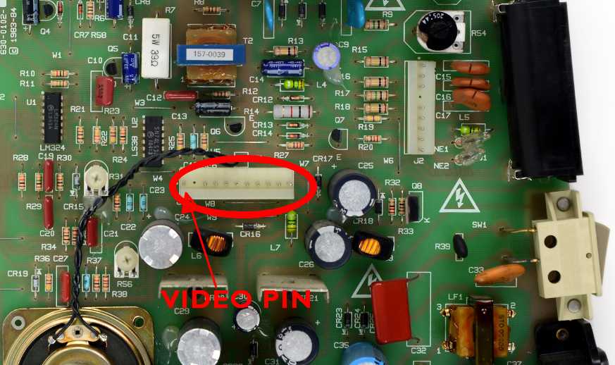

Hey everyone and greetings from Germany,
I've bought a Mac Plus about half a year ago and everything worked fine. But a few days ago as I tried to boot it up, I the display kept black. It seems to be the same problem as Daniel had at the very beginning of this thread, but in my case I wasn't able to solve it with a thump on the left side.
It stays black but sometimes it flashes up as MacTech68 described it. I was even able to see the 'Sad Mac' Icon one time.
So what can I do to solve this problem?
Like Daniel, I'm quite new in this area and I don't have the skills to do complex repair work on my own.
I'm really looking foreword to your answers,
Louis
P.S.: I really tried to write a good text and I hope it worked 😉
Louis
I'd be pretty certain that you do indeed have the same problem with the video pin on the video connector - it was a very common problem.
All the usual warnings apply with regards to opening and servicing one of these machines.
If you read through this thread - as you appear to have done - you will find tips regarding resoldering the video connector. This one in particular:
Yup, just remember that there is a small trap with that video connector.
It's keyed by having one pin removed (2nd pin location from one end). this leaves the video pin (often the one that causes this fault) sitting out by itself and is often missed when these boards are re-worked. I saw quite a few like this.
If you're not happy doing this yourself, please seek somebody local who may be able to assist, such as a TV repair tech (a dying race indeed).

I recently obtained a Macintosh Plus. My problem is similar to the one Adalbert described. Turning on the system produces a completely black screen and repeating clicking sounds that occur about every half second. Some of the clicking comes from the floppy drive, while I've assumed that the rest came from the speaker. From what I can tell, the case has been opened before - three of the five screws were missing, and it looks like someone might have attempted to solder the yoke connector, as the solder is a slightly different color and there are scorch marks around the four points. I did some prodding with a multimeter, and as far as I can tell, each of the pins for each connector is solid... or at least my testing seemed to indicate that. The capacitors appear normal to me, and except for what looks like corrosion on the top metal piece of the flyback transformer, everything looks visually okay. It's not even that dusty inside. Every once in a while, after adjusting connectors, I'll be treated to at least a partial, if not complete, Mac chime, but there's still nothing that appears on the screen. I'm not sure where to focus my attention. I'd really like to restore it if possible.
...Every once in a while, after adjusting connectors, I'll be treated to at least a partial, if not complete, Mac chime, but there's still nothing that appears on the screen. I'm not sure where to focus my attention. I'd really like to restore it if possible.
I'd be looking at resoldering the video/power connector on the power/sweep board. As noted earlier, make sure you also resolder the first pin on that connector which is actually the video pin.

Broken/cracked solder joints on the power/video connector can cause a pulsing/ticking machine and a loss of the video signal causing a black screen.
However, you might want to try checking and adjusting the +5volt rail using pin 6 of the power/video cable and the chassis whilst adjusting the "Voltage" potentiometer. Pin 6 is the blue wire.
It's amazing how much hassle that connector can cause, and to many, give the appearance of "the solder is fine, it's not that.".
It never hurts to go over that thing.

Oh. It seems that you are missing the Horizontal Output Transistor and it's heatsink. (I'm assuming you didn't remove it).
The attached pic is what you SHOULD see.
This is pretty bad news. Since you'd need to source one AND a heatsink AND we don't know why it was removed.
oh, and apologies - I don't know why I said 13 pin. 🙁 You are correct, it has 10 pins (in 11pin spaces)

That... is extraordinarily unfortunate. I didn't know to look for one, and never realized that something was missing from there. Now that you point it out, it's quite obvious.

Well, it's a tough call. That particular part (when it fails) can be a sure sign that the Line Output Transformer (LOPT) is shorted/failed. That's the large part with the red fly-lead and anode cap that attaches to the side of the tube.
So, if we said that somebody identified the BU406 as faulty, and was sourcing one when it was decided to chuck the machine, then we might assume the LOPT is shot too. 🙁
Can these parts be replaced? Yes.
LOPTs seem to be available via eBay,
http://www.ebay.com/itm/121089795069
and you certainly should be able to find a BU406 or better yet, a BU406D.
As for the heatsink, I've come across a 6025DG by Aavid Thermalloy which should fit and MIGHT do the job, but you'll need to purchase heat-sink compound/grease for good thermal transfer. (and a small, short nut & bolt to attach the BU406)
http://www.newark.com/aavid-thermalloy/6025dg/heat-sink/dp/45M6138
You'll need to factor all these and extra costs, such as your mouse, keyboard, cables, floppies etc, before deciding to go ahead. There is a chance that the LOPT is ok, but you risk destroying a BU406 to find out. PLUS - we don't know what other faults the board may have.
