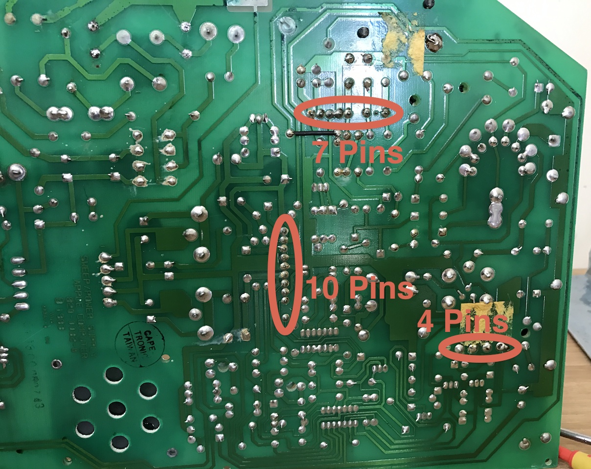

Sorry for the late, late, late reply, Robbin. Welcome to the forum! 🙂
Intermittent faults that appear to come and go with a 'tap' to the casing are invariably these (Click for larger):
This is as the board would appear with the screen face down.

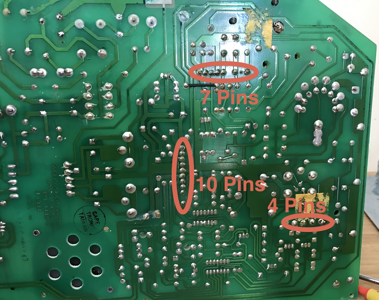

[doublepost=1509991835][/doublepost]Thank you so very much! The diagram is quite clear.

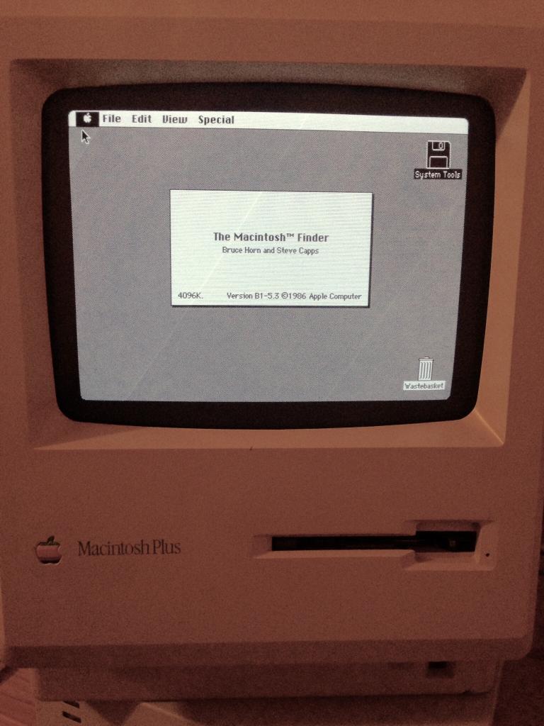

[doublepost=1522435430][/doublepost]EUREKA! 🙂
After a long time since my last post, I finally made the effort to fix the screen problem.
With a magnifier, I examined all the solder joints that had been pointed out.
There were no apparent cracks, so I decided to melt the solder on them all.
I also lifted the connection to the tube several times, just in case there was any corrosion.
I actually thought it was all in vain, so when I turned it on, I was prepared for the worst.
So you can imagine my joy when it came on as it should. It has been turned on and off
quite a few times now, and I've even given it a few hard slaps to see if it would induce the problem.
I'm quite happy now 🙂
Thank you very very much!
Robbin Rohner
