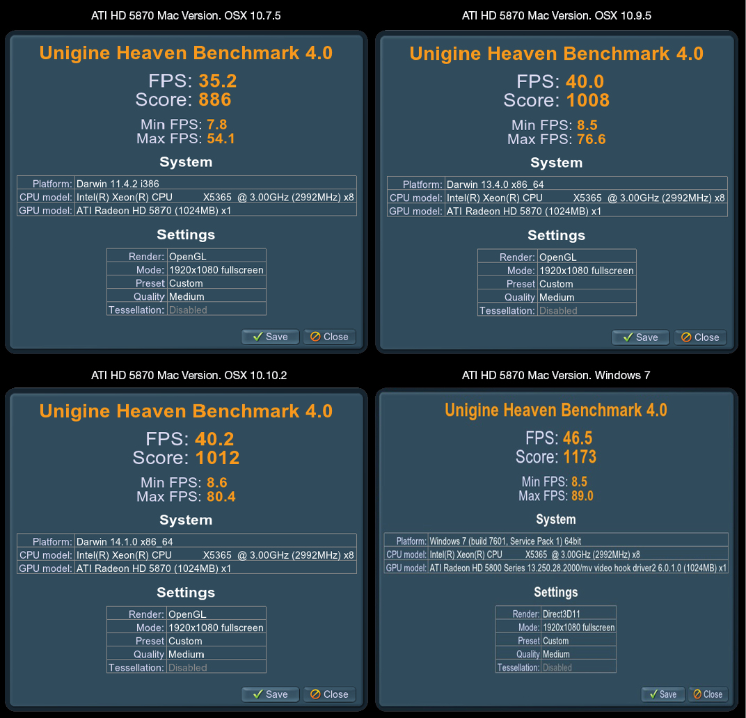

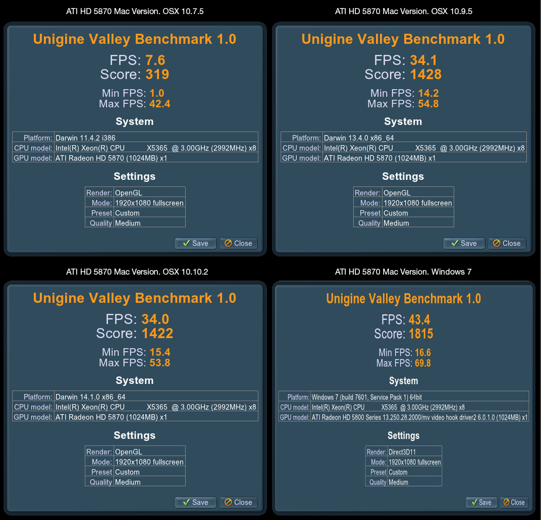

I've been doing loads of benchmarking before picking a new card for my Mac Pro 1,1. I've uploaded the results of 4 OS's and it's nice to see a bit of an improvement in the new OS X versions, which in itself is a simple upgrade that gives a nice bit of a performance boost. I think I'm going to stick with 10.10.2 as my main OS.
I have some questions. Looking at Valley why would 10.7.5 give such poor results? Also, with this being a Mac card why does it perform the best under Windows 7?
My Specs:
Mac Pro 1,1 > 2,1 firmware
2x Quad Core Intel Xeon X5365 3GHz CPU's
32GB Ram
ATI HD 5870 Mac Version
OWC SSD
I've gone with Medium settings in Heaven and Valley with AA turned off (Settings used elsewhere on this forum for these kinds of cards).

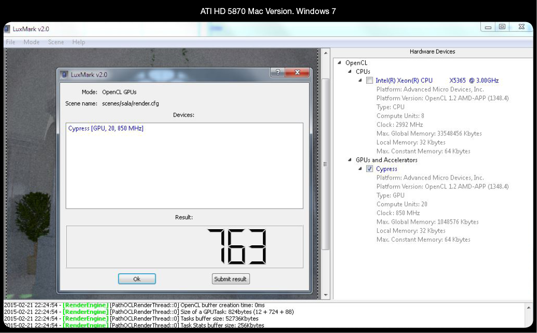

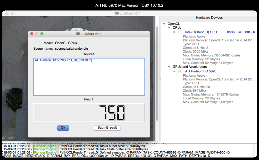

Also here's some results from LuxMark Sala.
I couldn't get it to run under 10.7.5 with it crashing every time. Anyone know why that would happen?
I assume it's because the drivers for Windows see a lot more updates.
I always noticed this when encoding HD video using the same software under Windows and OS X, both using CUDA. Under Windows it would always perform better.
