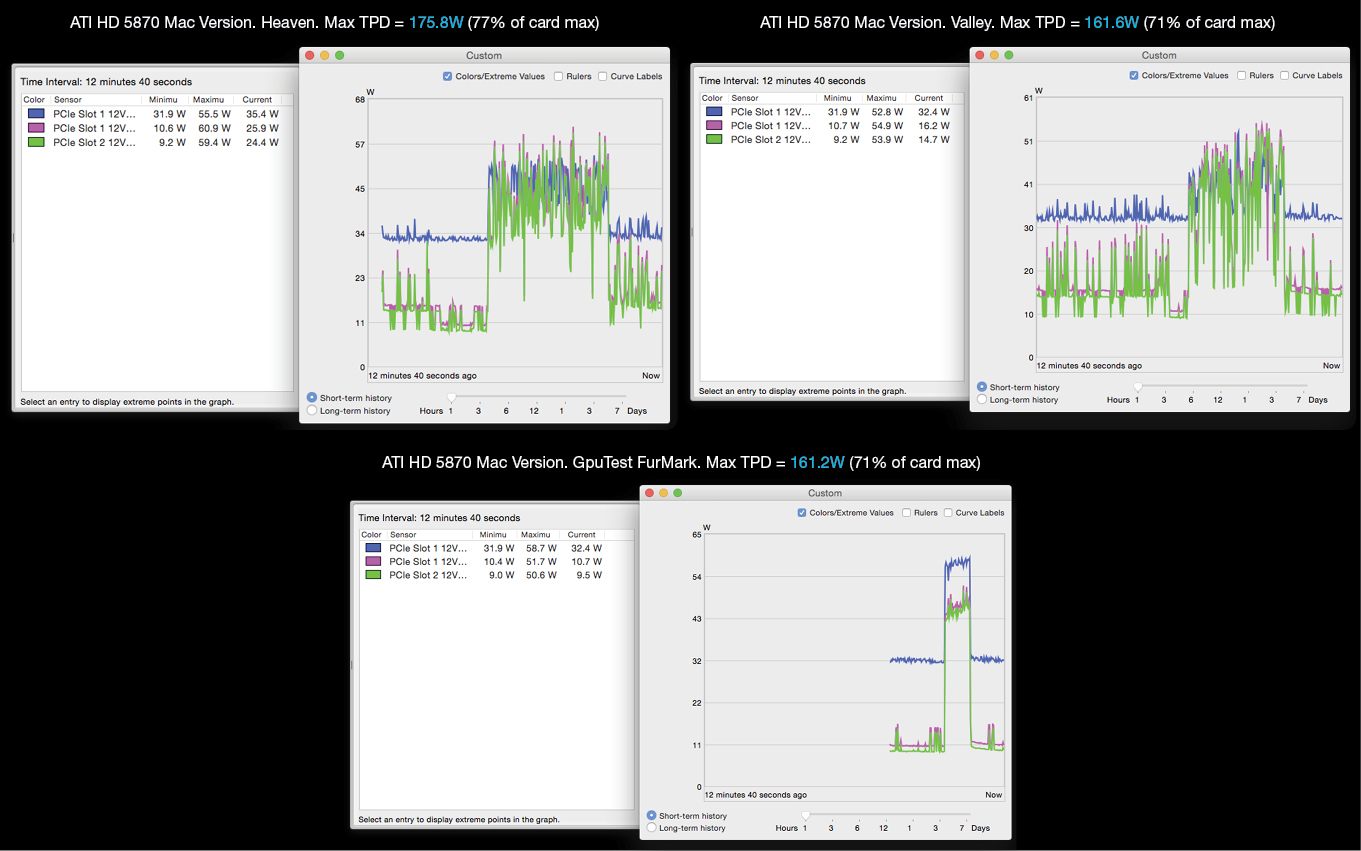

I was thinking about that as well when I was testing and did monitor the power draw coming off the card. What I noticed was that even in the hardest stress tests it never got close to 100% TDP. The 5870 is rated as 228W and I was seeing less than 80% of that.
So it kind of seemed like maybe the system had capped the power not to go too high? Have you ever monitored the power to see with your cards?
I was basing possible cards off that, even though I don't know at all if it will apply to any other cards. Agree there is a bit of a risk but 250W isn't that much higher than 225W, and even if they pull 90% of the total that still sits within 225W.
Another thing I've seen is pulling some power from the Molex connectors if needed. I've got no dvd drives in mine and a HD slot free as well.

Yes the 5870 is completely safe as you can see from my charts it never ever gets anywhere close to the 228W, the max it ever got under full stress load was 77% of that at 176W. I did a lot of testing and really pushed it with the stress tests and thats all the watts it was using.
This is why I am wondering do all cards perform this way? If so then it's highly probable that a 250W card would never use that much power, probably more like 200W at full stress. So it could be ok to use a card up to that power level in a Mac Pro.
I've been trying to find out more real life info but not many people have monitored the power draw of their cards in these mac pros.
I'm sure most cards never hit their max TDP but it is not something I would risk personally. It is a much safer route to stick with something that only had two 6pin connectors. You never know when the card might spike up and try to draw too much power and either damage the card our the board. If you really want power right now the best bang for the buck it's probably the GTX 970 with the 960 or a 750to as a budget card. The only down fall with those is the lack of native driver support for the Maxwell cards.

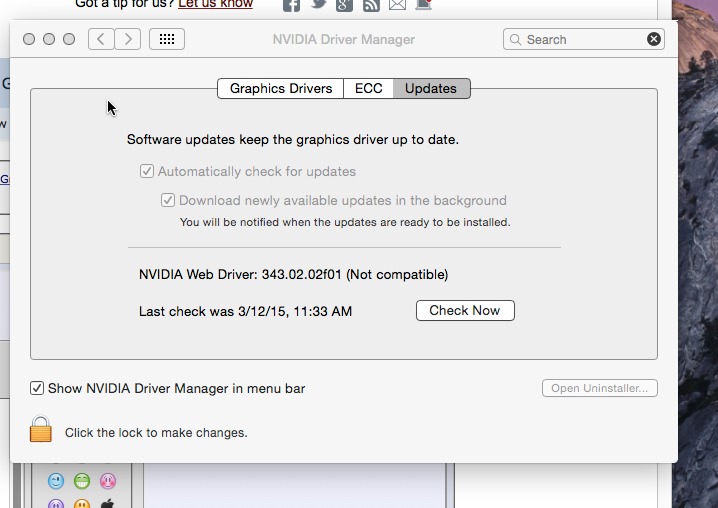

I just found out that my web drivers are no working anymore after the updates that I had done today, so my GTX 570 is not gone, the issue are the updates and an extra security update included, please take a look:
I am on a Mac Pro 2,1 with OS X 10.10.2, which are the latest OS X drivers that I can use now?.

This is the updated driver from Yesterday
http://us.download.nvidia.com/Mac/Quadro_Certified/343.02.02f03/WebDriver-343.02.02f03.pkg
The security update changed the build number for OS X which is why the driver reports as incompatible.
