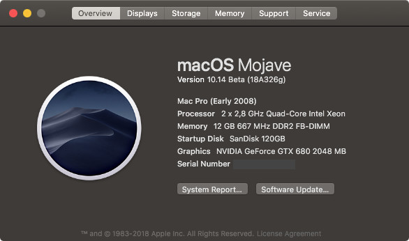

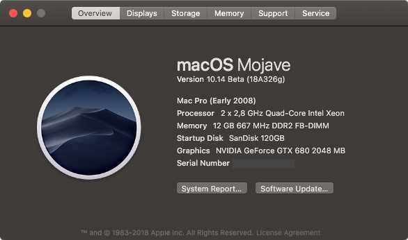

Don't go with AMD GPUs on the 3,1. Since High Sierra, AMD cards needs SSE4.2 - Mac Pro 2008 Xeons don't have it.
GTX680 it's the only option here with boot screens, but you can use any Kepler or post-Kepler card.
Reactions: crjackson2134
I have the NVIDIA GeForce 8800GT 512 MB
Is there a better faster card?
Yes, eVGA GTX 680 for Mac - but almost any PC GTX680 can be flashed to support EFI/boot screens. Check the Confirmed and Possible Flashable GTX 680 Models thread.
Btw, GTX680 works with the native driver, out of the box, have Metal support and the most important: works on the 2008 Mac Pro.
It's even supported on Mojave.

Not officially, but you can patch the installer and run 10.13 on it. Take a look on the
macOS High Sierra (10.13) Unsupported Macs Thread.
It's easy with a EFI flashed GTX680.
