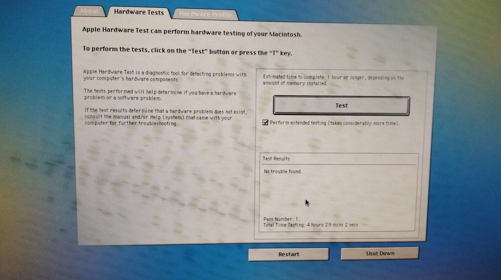

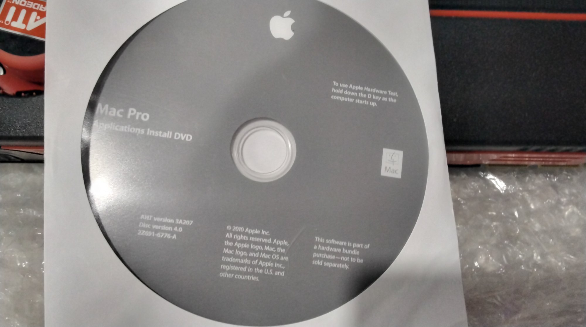

Thank you for this I will try to do the test tomorrow. I have my original Apple SSD 512Gb with Mojave not OpenCore can I use that?

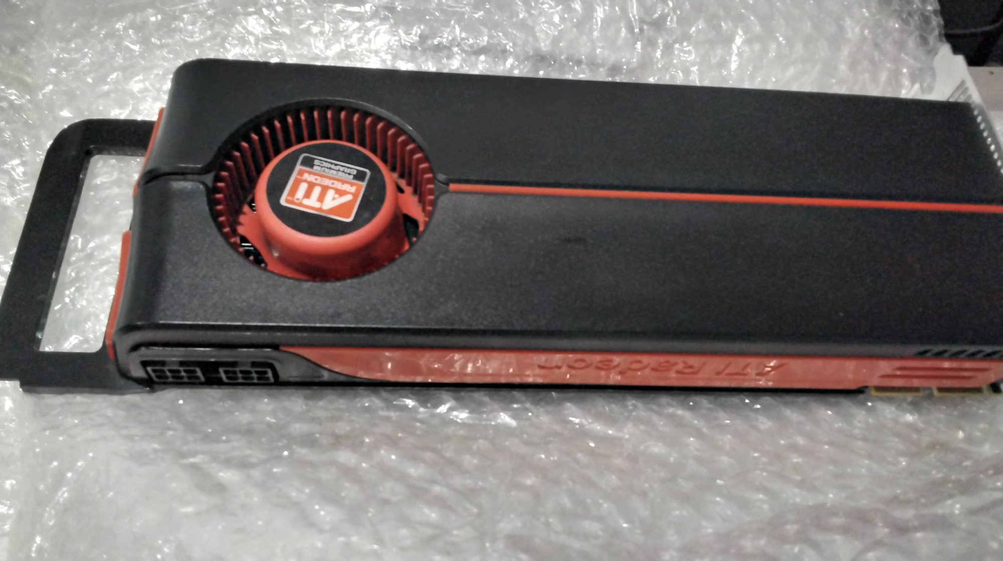

No I have not run the any hardware tests but now i will try, I have the ATI HD5870 and the original Apple install hardware test will this be okay?
Original GPU

Hi, I put my original GPU a HD5870 in the Mp5,1 and used my official Apple SSD that is installed with Mojave (no OpenCore) today and it loaded fine that was a surprise. I performed Apple hardware test using the official CD using my original HD 5870 Gpu with an old mac screen that seems to work after 10 years in a damp place I was surprised and it passed the hardware test.

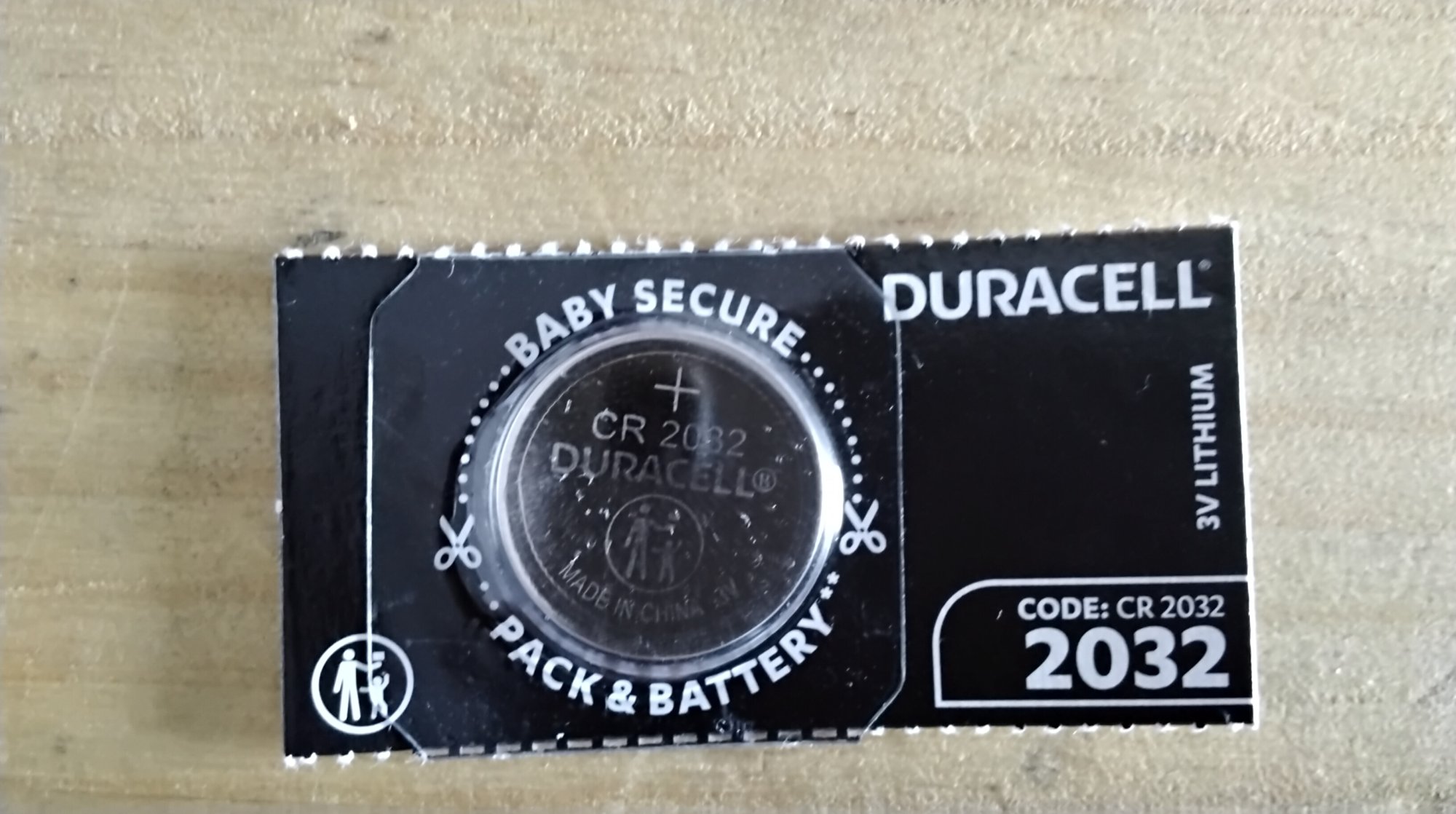

Do you think I need to replace the battery even if the test has not mentioned anything? I did clean the Mp5,1 today as best as I could. I didn't check the boot rom I need to do that in Mojave, right now I am in Monterey opencore.

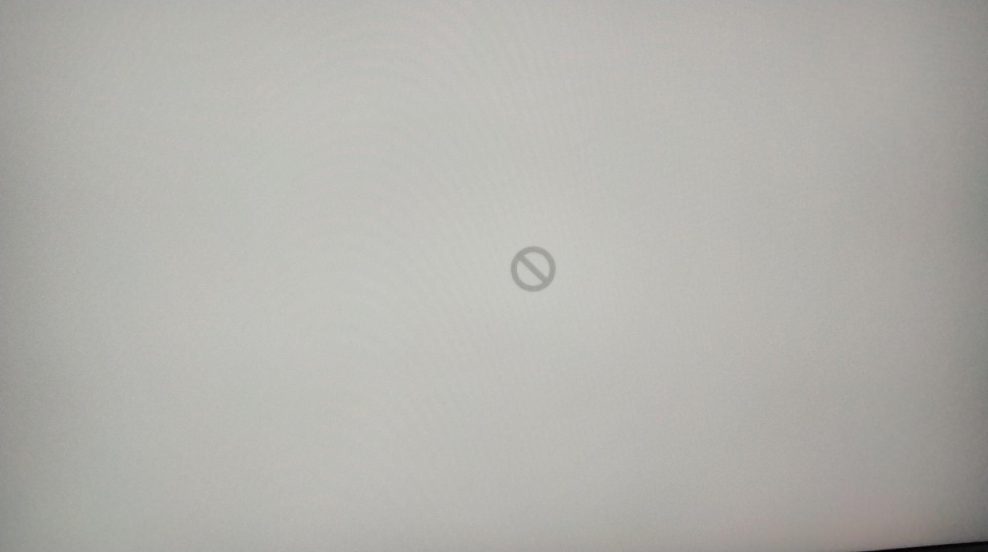

And why would the SanDisk Plus 480GB SSD cause errors such as a Prohibited sign to appear after 1st reboot and midway through 2nd stage? it always appears there. could it be the ssd fault or my Opencore configuration?

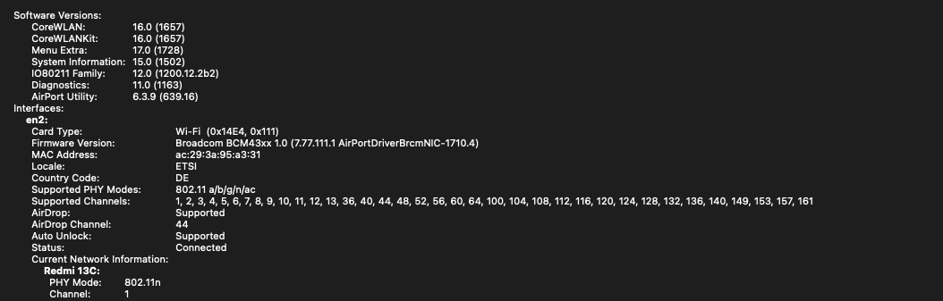

Can I ask would my Broadcom BCM94360 Wifi Blue tooth dongle work in Sonoma?
Did you measure the BR2032 voltage? AHT/ASD only detects a completely spent battery, one that will cause all sort of issues (below 2,95V) will not be detected since the MacPro does not have a RTC battery voltage sensor.
Take some steps back, install Mojave and see if it also happens with 10.14.6.
Apple removed the 94360 drivers from Sonoma, OCLP installs for the internal one, but is not a good job and requires tweaking since is not a Mac Pro standard config and OCLP is not exactly good for upgrades, even if is one very common with users.

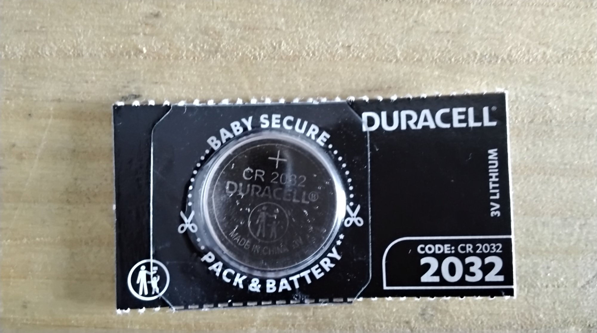

Hi tsialex, and thanks once again for the help, I have not checked the voltage of the BR2032 I don’t think I have the means but I did buy a CR 2032 Battery and I will install it if necessary. is that battery okay?

Regarding the WIFI/Bluetooth card as long as the BCM94360 card I have has a workable WIFI and maybe a little bluetooth in Sonoma that would be enough for me. can OpenCore provide at least the very basic use of WiFi and Bluetooth?
No.
CR2032 have a different chemestry from BR2032 that does not support the temperature right below the GPU. A CR2032 will works for tests and diagnostics, fail overtime and can even leak if you have a hot GPU - buy the correct BR2032.
Not with Sonoma, use the search on the MacPro forum and see the current modification needed for it to work. Again, can't help you with this issue, you'll need to do your homework.
Ok Thanks, i will try to find the correct one in Spain, like this one
hopefully they can deliver it to me. There are no shops where I live that sell the the BR2032.
Okay so I won't have WiFi or Bluetooth in Sonoma with the BCM94360 card I have that would be a big problem then, thanks for your advice and recommendations I will try to find information on mac rumours about the wifi and bluetooth problems regarding Sonoma and those BCM94360 cards
