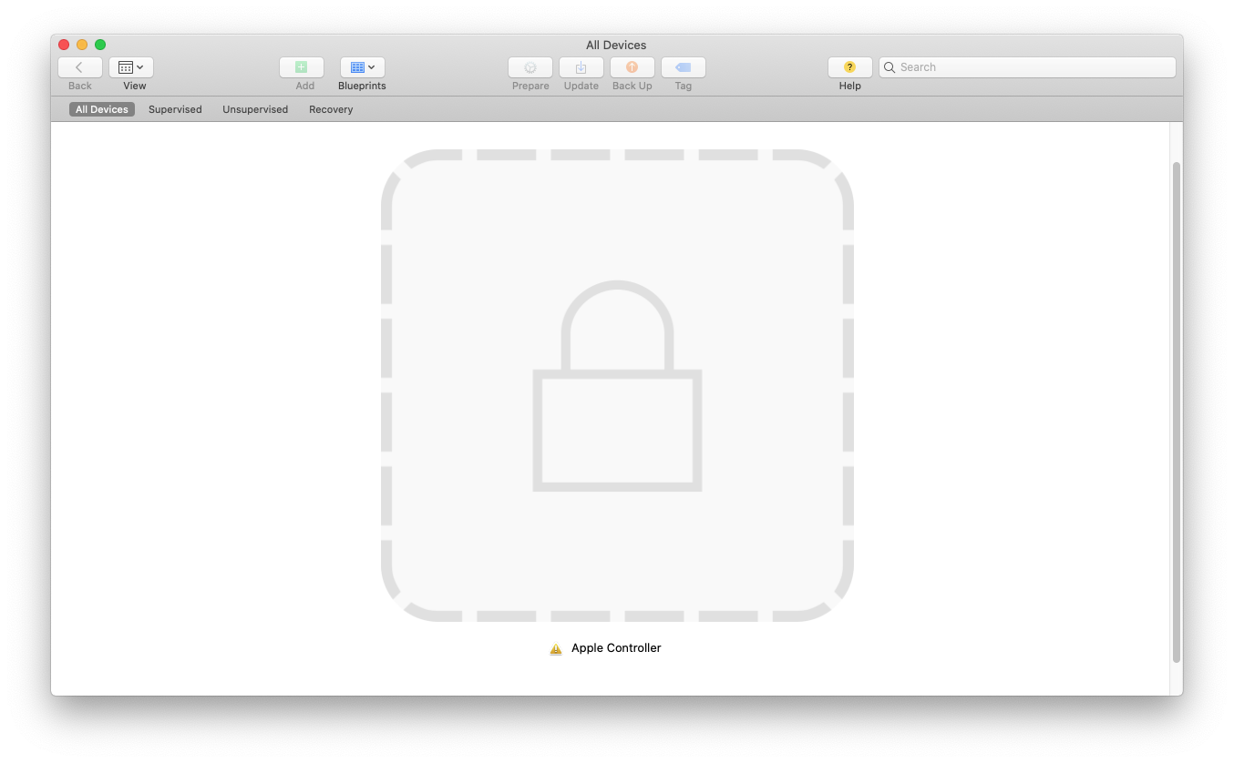

I end up with a Padlock on the Apple Configurator 2 after every attempt at revive or restore and I don't know what that means since there's not much detail about that online.
Is there anything else I could try or does anyone know the reason for the Padlock on Apple Configurator 2 and what it means if the laptop keeps going back to it after every attempt at restore?

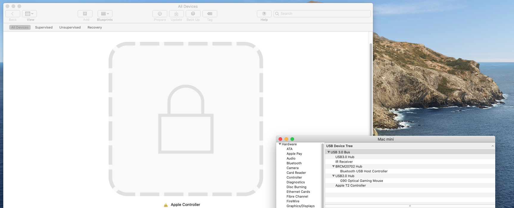

What I see after every revive or restore with not other error / alert

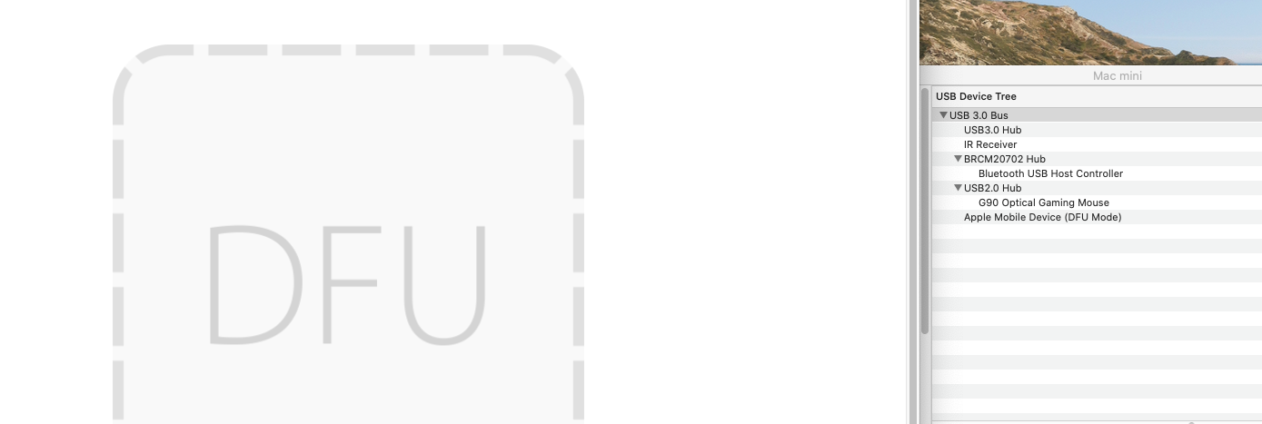

What I see in DFU mode in the USB Tree
What I see after revive and restore and also If I randomly just plug it in

It simply means you didn't use the method to enter DFU mode. If the Mac boots up normally you will always see a padlock.

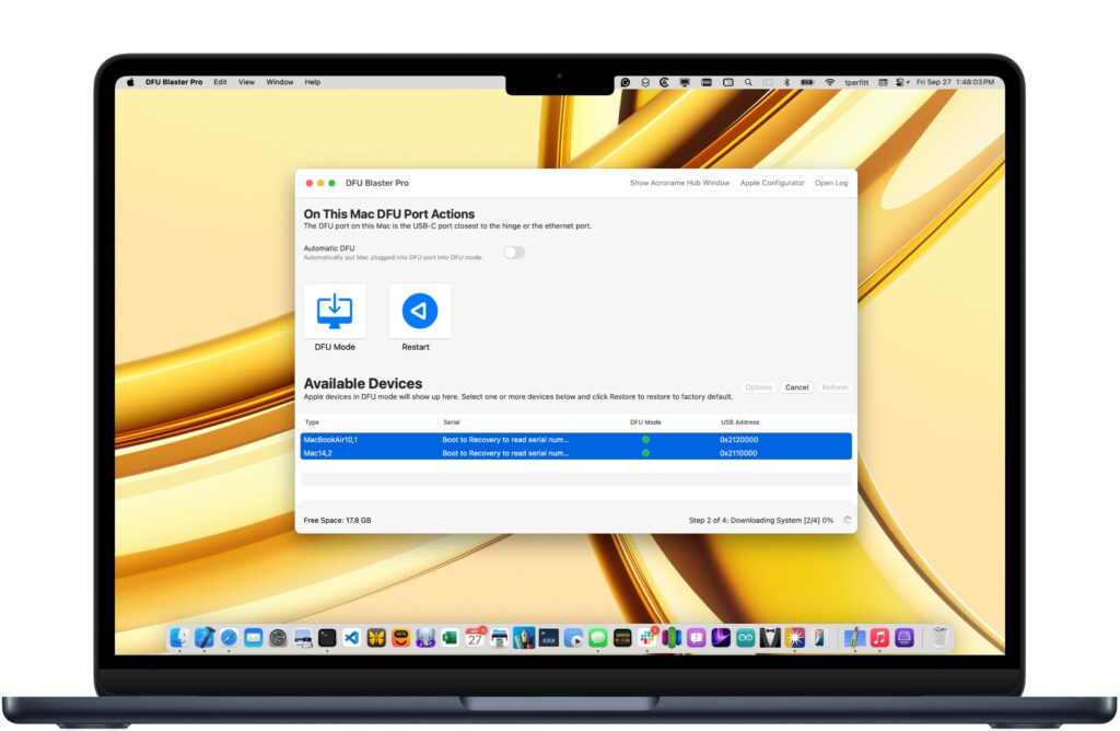

There's a tool you can use to put a Mac into DFU mode called "DFU Blaster Pro":
IMPORTANT:
This costs about $50 to buy, but you DON'T have to buy it.
It also runs in a "freeware mode", with limited functions.
BUT... those limitations STILL permit you to establish a DFU connection to "the target".
I've had problems in the past getting into DFU mode.
This app helps.
