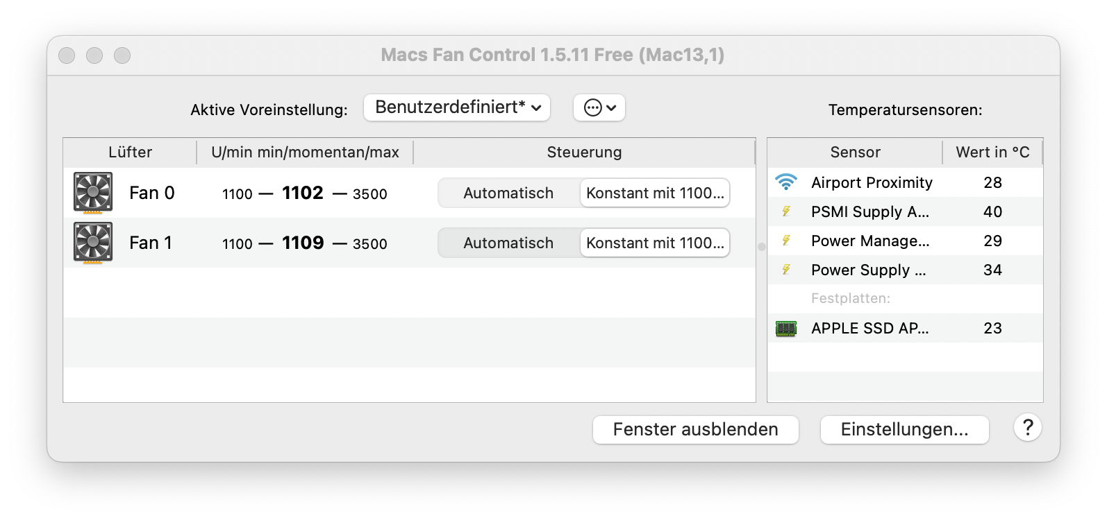

On my Mac Studio Max I get 1300 rpm in idle, which occasionally distracts and annoys me. (When it is not taxed I wish my machine to be silent.)
I now set up Macs Fan Control to constant 1100 rpm, which makes a night and day difference.
So far it also does not seem to heat up any components. Maybe this could even be a long term solution.
I am wondering if maybe the Mac Studio Ultra defaults to 1100 rpm on idle. This would maybe explain why the Ultra version is reported to be more quiet by some users.

My Ultra fan runs at about 1325 +/- 5 rpm at idle. I ran Cinebench R23 multi-core test, 20-cores at 100% for 10 minutes and the fan went all the way up to 1344 rpm max. Yeah, a maximum increase of 24 rpm !!!
BTW, the Cinebench R23 score was 24,099 and 24,112 on the two runs.
So I'm guessing you have to really get the GPU's cranked up to increase the fan speed significantly above their idle speed.
The Power Manager Die Average temperature increased from 31C to 45C at the end of the 10 minute 100% CPU test. The PSMI Supply AC/DC Supply 1 temperature increased from 42C to 75C. I ran the test twice about 5 minutes apart and got virtually identical results.
All temperature and fan speed results from Macs Fan Control 1.5.11.
