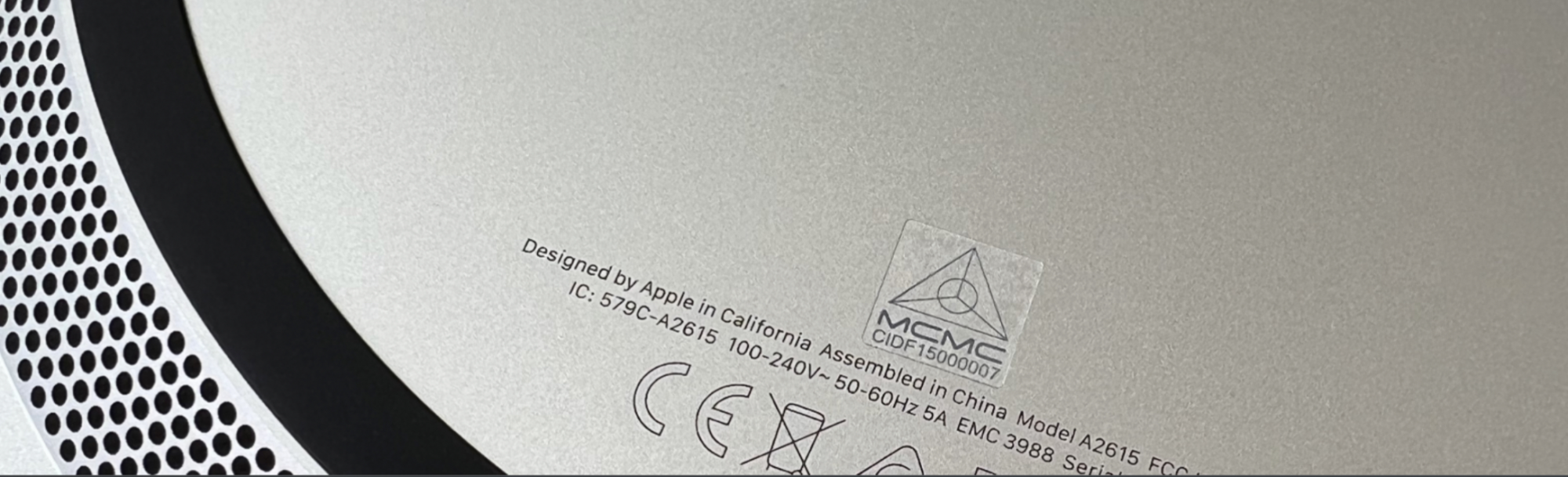

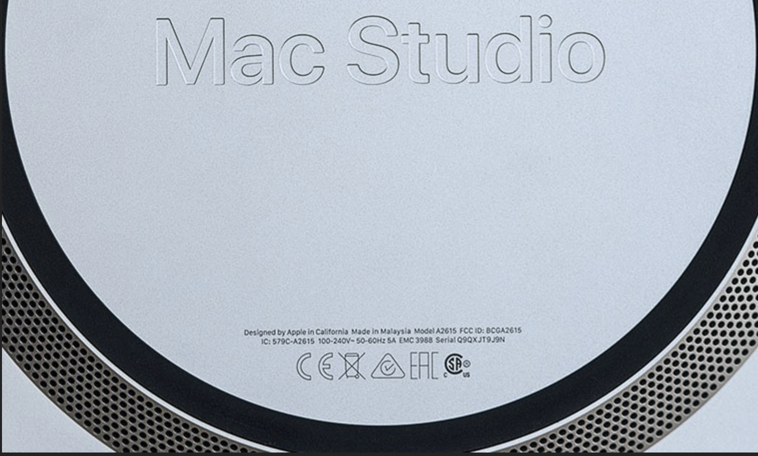

i don’t have my Mac Studio yet, but I did see some posts on the net showing some units with “Made in Malaysia” and others with “Assembled in China,” so perhaps that could explain different sources for the power supplies in the tear downs? Or it could be due to Max vs Ultra.
Edit: MCMC Label on the ”China” unit = Malaysian Communications and Multimedia Comission.

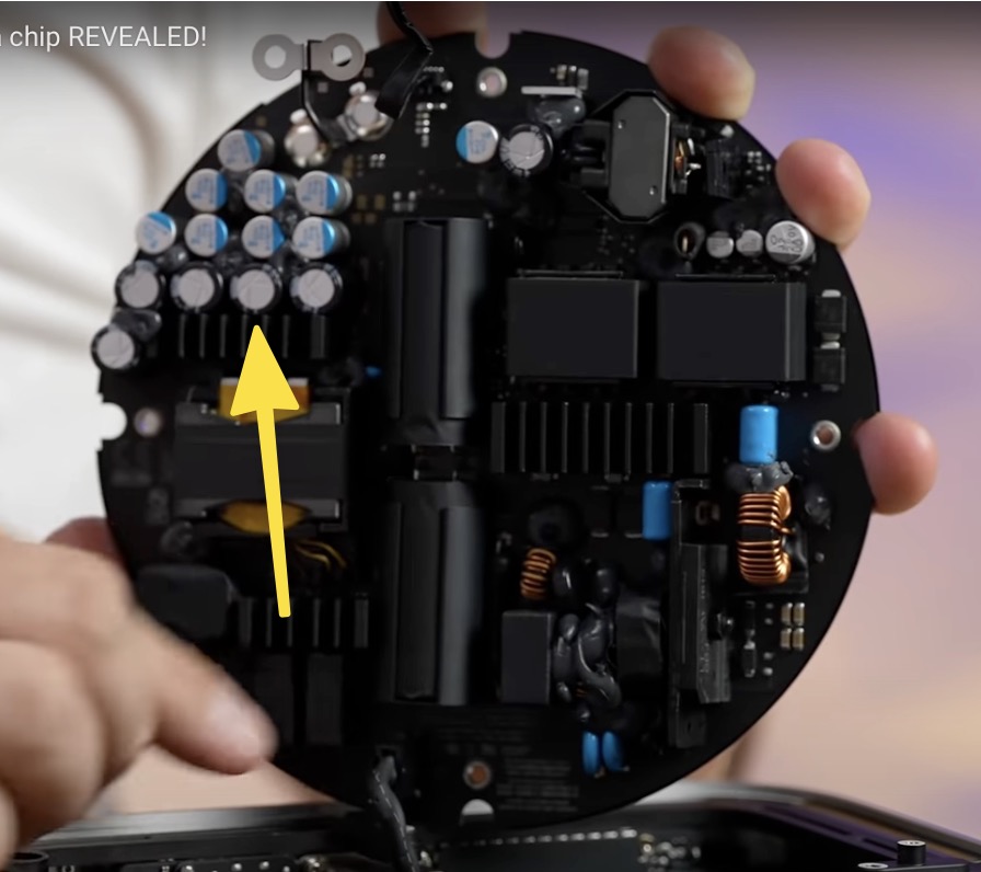

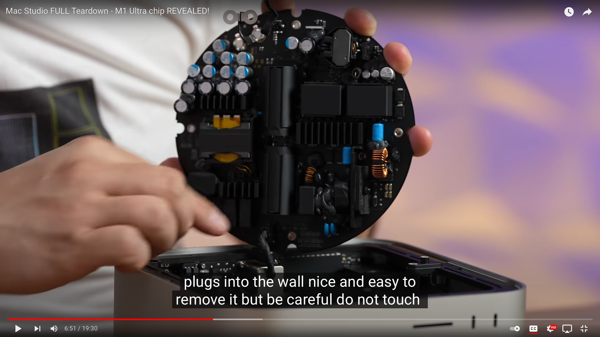

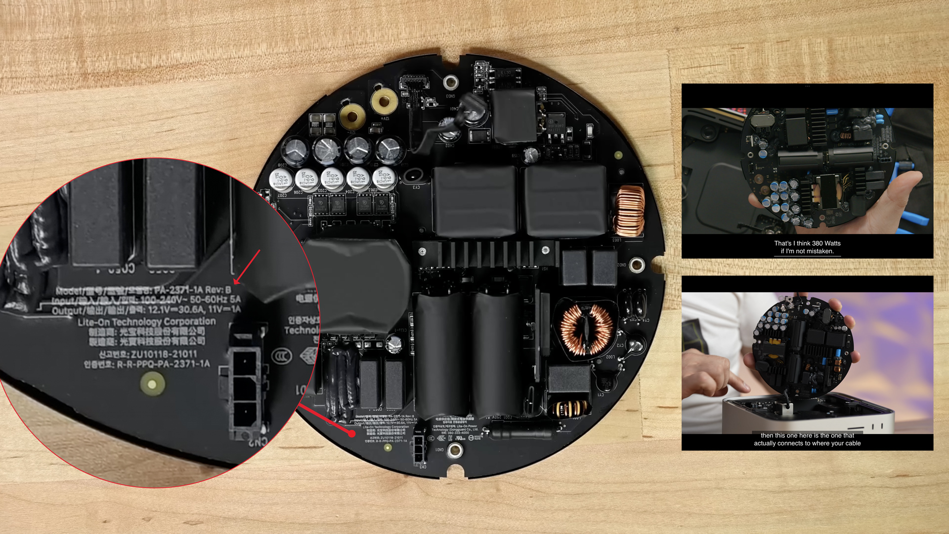

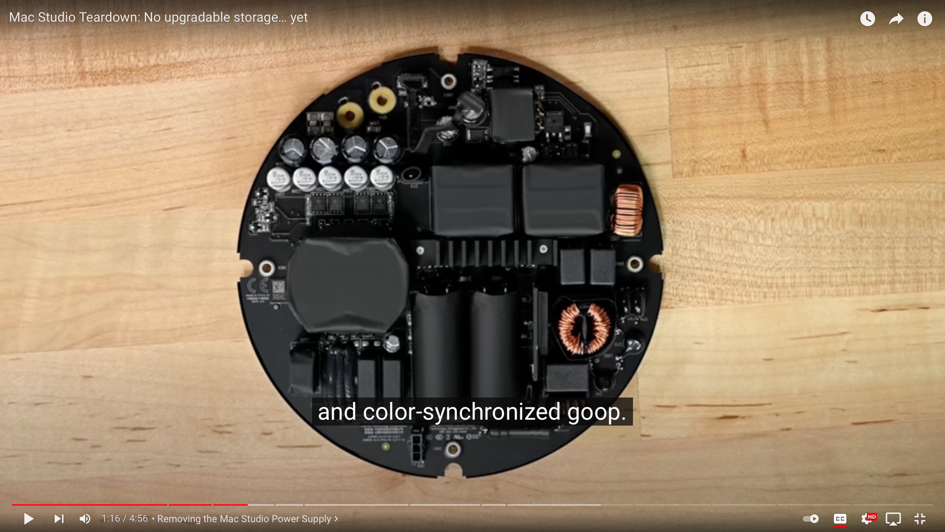

Has anyone else noticed the power supplies in the Max Tech Mac Studio teardown (an M1 Ultra) and the iFixit Mac Studio teardown (a M1 Max) are different? According to the Apple Spec page the electrical specs of both models are the same (370W).
So are the power supplies different because one is a M1 Ultra and the other is a M1 Max even though they have the same total wattage specs? Or are they meant to use the same power supply board and there was a design change to the power supply board late in preproduction, and some of both models were built with an older version of the power supply board? It's pure speculation, but if so, that could possibly explain why some units have the high-pitched whine and others don't have it at all.
I'm looking at the Mac Ultra teardown and everyone has a different power supply. Apparently there are two kinds. 😳

The two power supplies being vastly different is also very odd, unless they are specific to the Max / Ultra. That much variation does suggest a revision, if the CPU is not the differentiating factor.

I find it very suspicious that we have pictures of two different power supply designs in the two tear-downs. While its possible they created different power supplies for the M1 Max and the Ultra (which would require more current for some supplies) the fact that both are rated at the same 370W makes it seem doubtful they designed 2 different power supplies for that reason.
It's speculation, but it seems possible they did a redesign of a common power supply late in the game, but still produced some units with the 1st design. That could explain why we have whine in some Studio's and none at all in other units. If I recall the M1 Max's have been much more susceptible to whine than the Ultra's, and that could be where most of the boards with the 1st design ended up because production volumes were probably higher initially for the less expensive Max. Again, this is all speculation based on just now realizing there either still are, or have been, two different power supply designs in production units. Just speculation with too few facts.

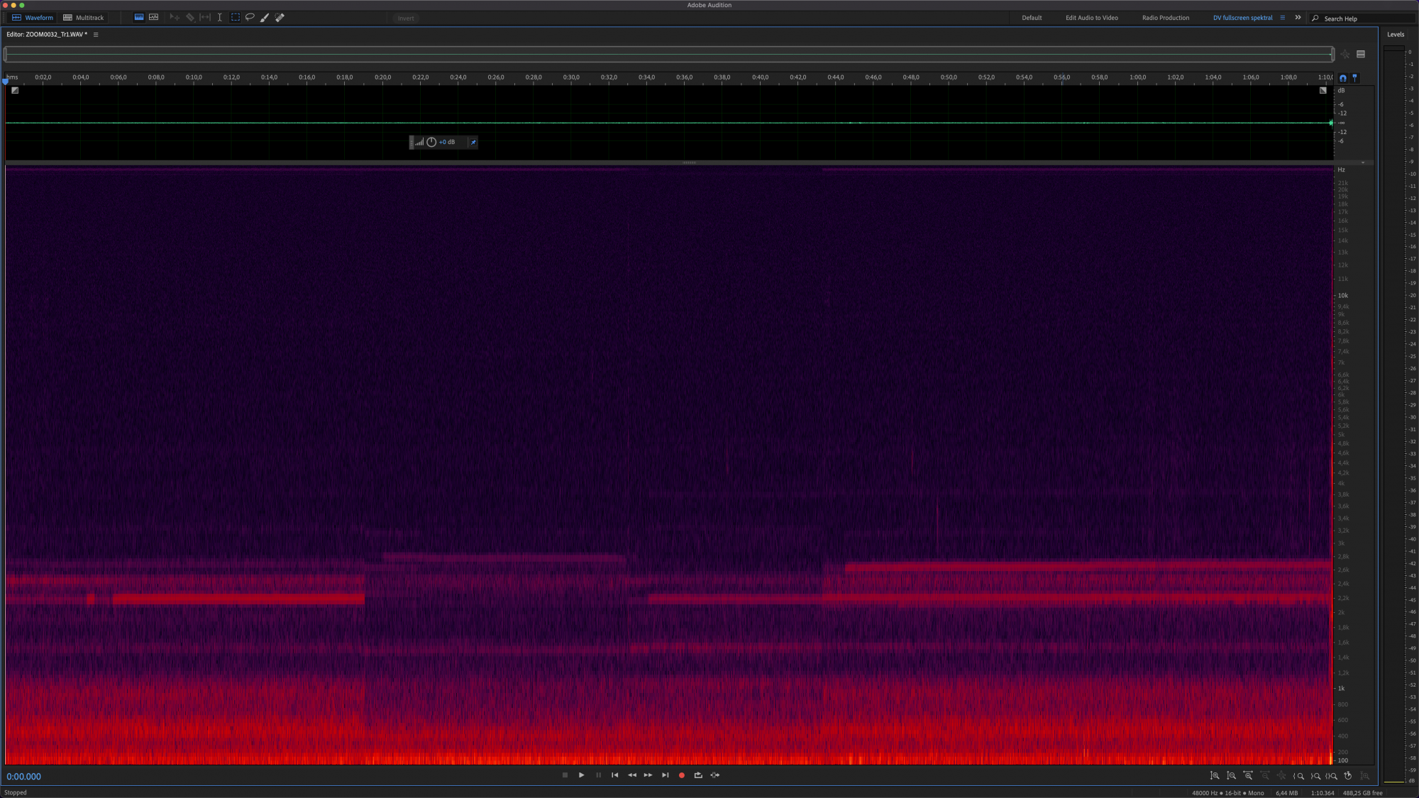

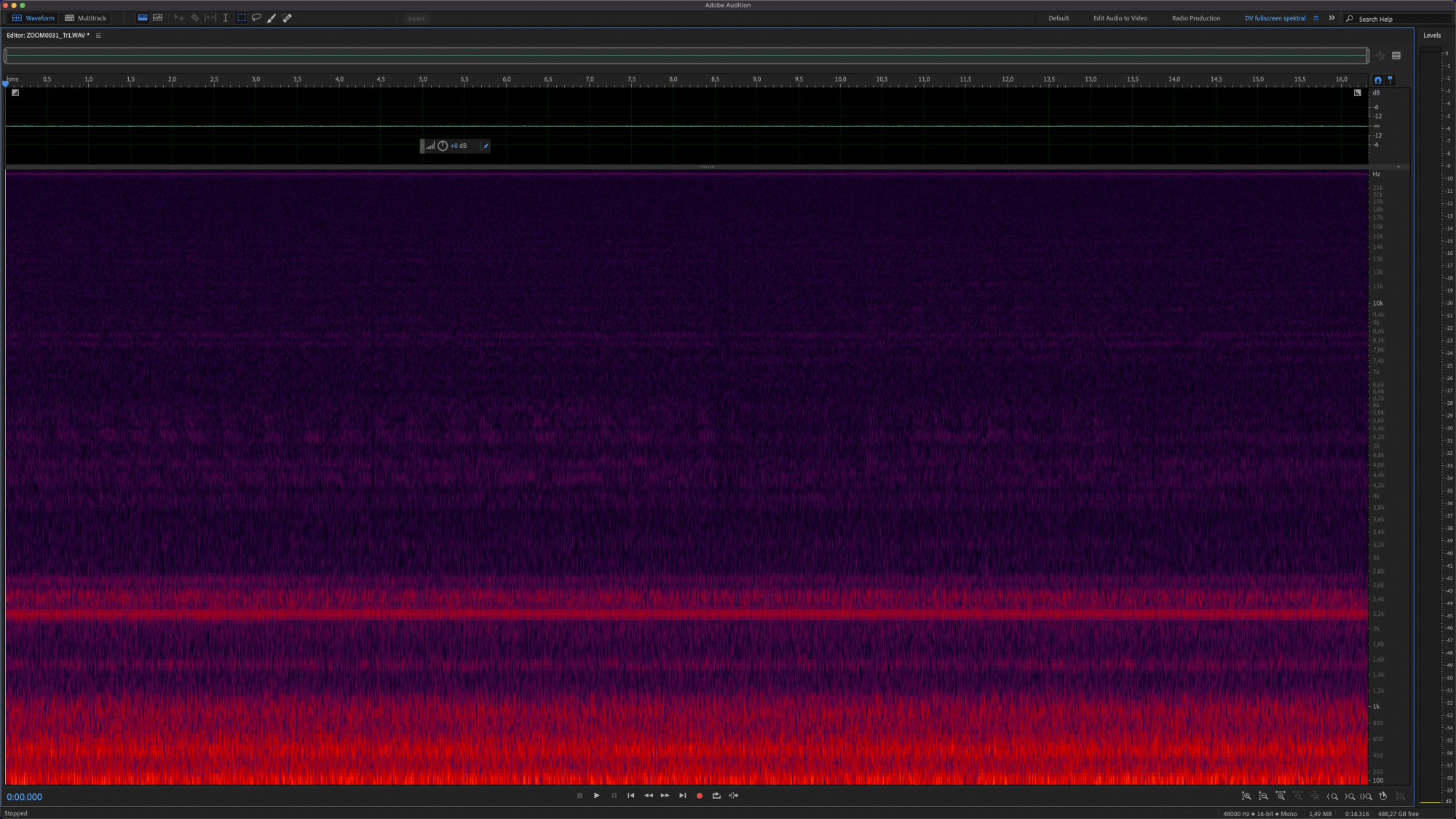

Neither the CPU nor the GPU has any effect on the whistling. With the GPU, there is a subtle chirp that is completely different.
I remember the Vega 56, there was definitely more chirp in the renders.
  • studio GPU.wav
    1.5 MB
Reactions: jtkiley
Here is the CPU benchmark. I clogged the holes, one half at a time. Towards the end I uncovered everything and the fan made even more noise/whistling.
  • studio CPU clogging of holes.wav
    6.5 MB
Reactions: jtkiley
