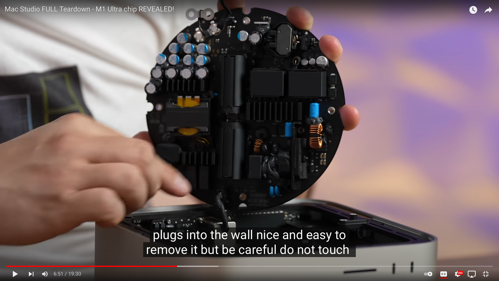

Has anyone else noticed the power supplies in the Max Tech Mac Studio teardown (an M1 Ultra) and the iFixit Mac Studio teardown (a M1 Max) are different? According to the Apple Spec page the electrical specs of both models are the same (370W).
So are the power supplies different because one is a M1 Ultra and the other is a M1 Max even though they have the same total wattage specs? Or are they meant to use the same power supply board and there was a design change to the power supply board late in preproduction, and some of both models were built with an older version of the power supply board? It's pure speculation, but if so, that could possibly explain why some units have the high-pitched whine and others don't have it at all.
LTT just did a video on the Mac Studio and theirs (both Max) have a different PSU. Maybe one of them is causing the coil whine.
I discovered that there were 2 different power supplies from previous teardowns of a Max and an Ultra, and posted those pictures a few days ago. I guessed that might be why some Studio's have the whine and others don't, but that would require that both power supplies were used in both models. This is the first confirmation that is true. So yeah, that makes it even more suspicious that one power supply has whine and other doesn't. I guess we will have to wait for people to start tearing down Studio's known to have whine to see which power supply, or supplies, they have.
Everyone including me would assume there must have been different power requirements in Max vs Ultra that they would've needed different PSU, despite both rated at 370W.
Linus' video accidentally proved otherwise by ordering the same SKU in different time frame to get the two PSU, and the first thing he did was to swap them and it worked. Then from the iFixit teardown we saw clearly the fine print on one of the PSU says "Rev. B".
Coupled with the fact that we have people returning their first Studio with noise issue, got a 2nd unit and reported to not hear anything close to the 1st one. So yes we can pretty much assume if not confirm that there are noise issues exclusive in one PSU and it is a lottery which one you get, or at least initial orders had that problematic PSU.
