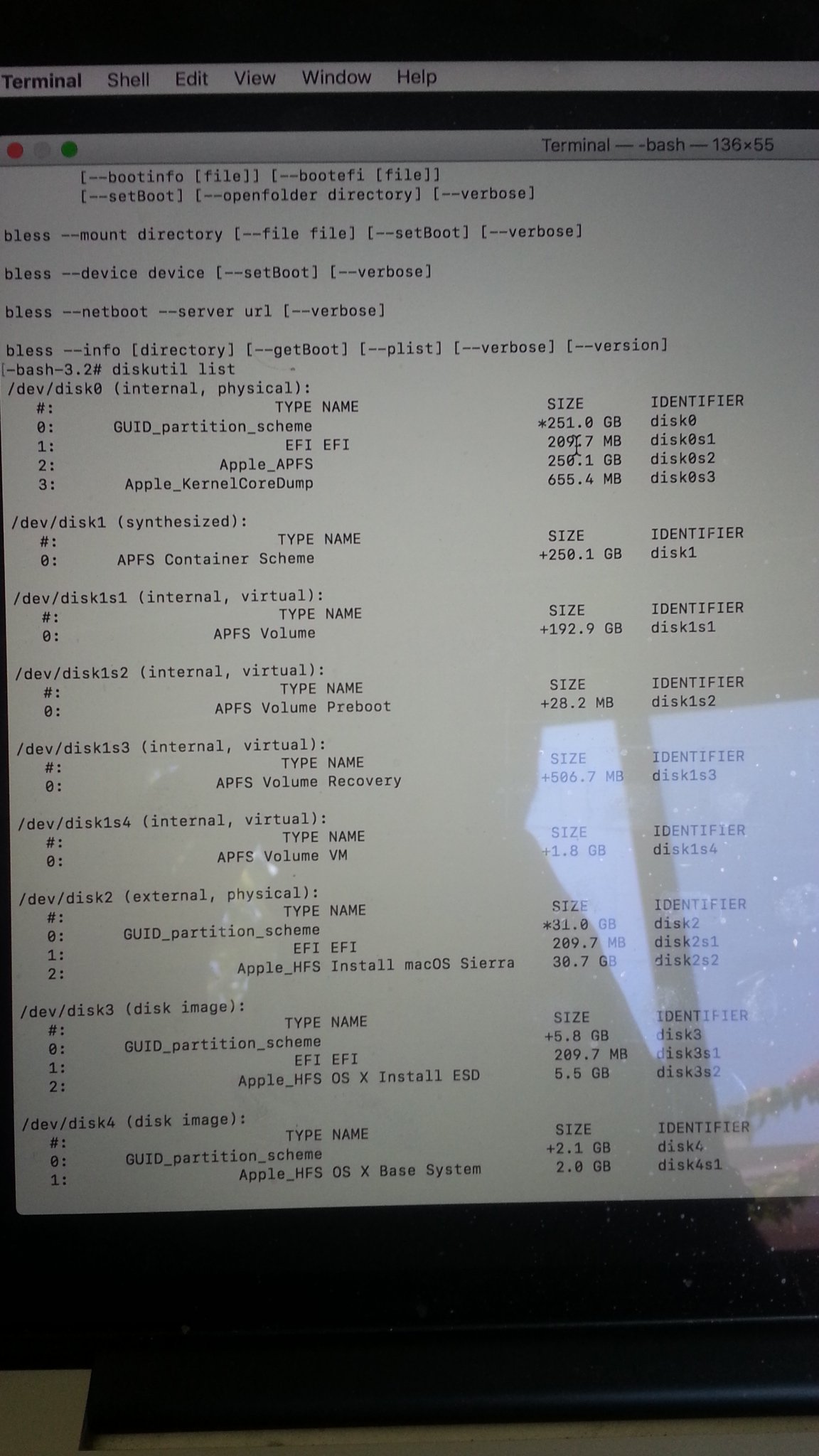

Instead of shutting down normally I kept the power button pressed and forced a shutdown. After that my mcb wont boot.
It was an apfs drive and was in the process of encrypting. I am on High Sierra.
I tried recovery and all sorts of things but nothing.
I booted with recovery usb and in terminal I see my drives but for for some reason they became virtual drives (disk1s1 disk1s2 disk1s3 disk1s4). The computer is trying to boot from disk0 which there is nothing there.
Is there a way I could move those virtual drives as my disk0? The capacity is correct of all those virtual drives which means nothing was deleted.

Its frustrating though cause i see the drives as virtual but can't read them cause i guess sierra which is the external hdd os that i installed can't read apfs?
Is disk utility able to delete partitions and recreate partitions using guid instead of apfs?
Yes, if you use disk utility from High Sierra - e.g. you could create a High Sierra install media on USB and boot/recover from there.
