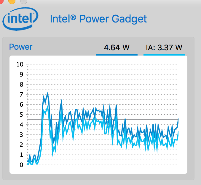

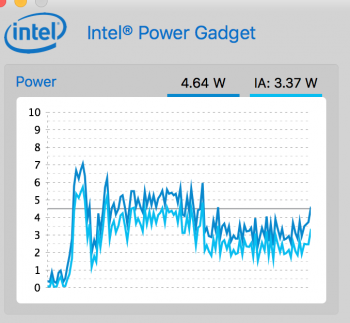

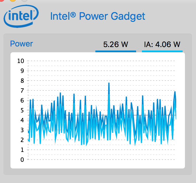

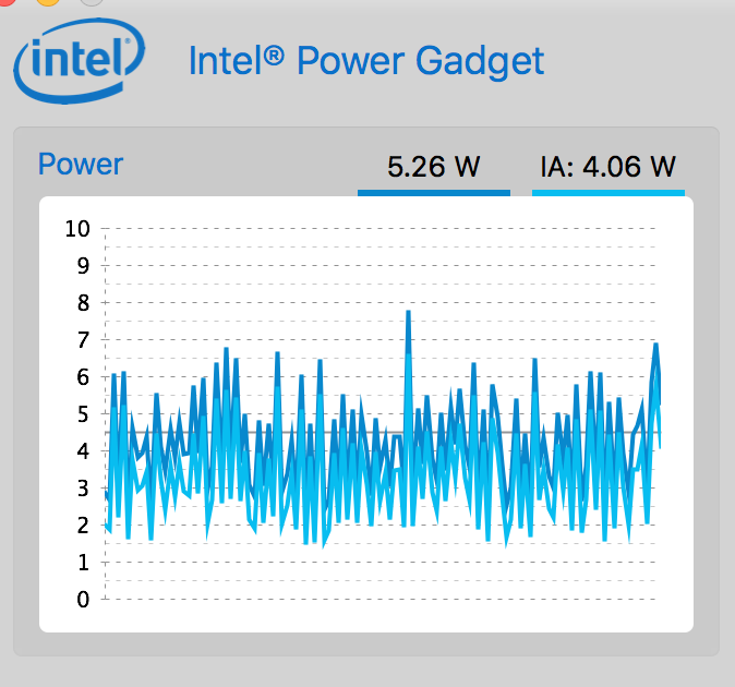

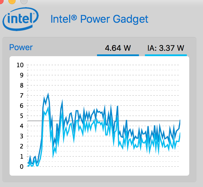

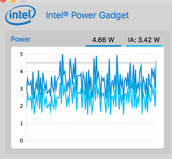

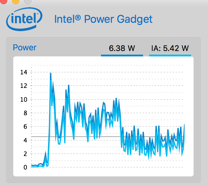

I don't know if this is of interest to anyone, but I tried opening the Photos app on both machines with the Power Gadget open. The m7 seems to jump to a much higher power consumption and stay higher for longer? All I did was open Photos (both libraries fully downloaded and synced) and leave with just that app running on screen.
The m3:
These show the idle state before launch (0W-1W), the peak during launch (7W) and the second image shows the state idling with just Photos on screen (2W-5W).

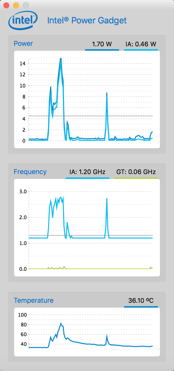

The m7:
These show the idle state before launch (0W-1W), the peak during launch (14W) and the second image shows the state idling with just Photos on screen (1.5W - 7.5W).
So the m7 doesn't seem to get things done and power down more quickly?

It doesn't seem like that according to the screenshots. The m7 is drawing double the watts, and idling at a higher watt usage. Am I missing something?
According to the screenshots yes I agree. But I certainly wouldn't evaluate a true processor comparison based on one use-case and 2 screenshots posted by the OP.
True. Wouldn't a higher clock pull more wattage though? I'm not a electrical engineer so I'm just guessing
Yes. The m7 should be a better binned chip, though, so at the same clock speed it should pull a little less power than m3. On the other hand the higher turbo will likely negate this so ultimately the m7 might have slightly lower battery life than the m3 and m5 (at least based on earlier Macs with CPU upgrades).

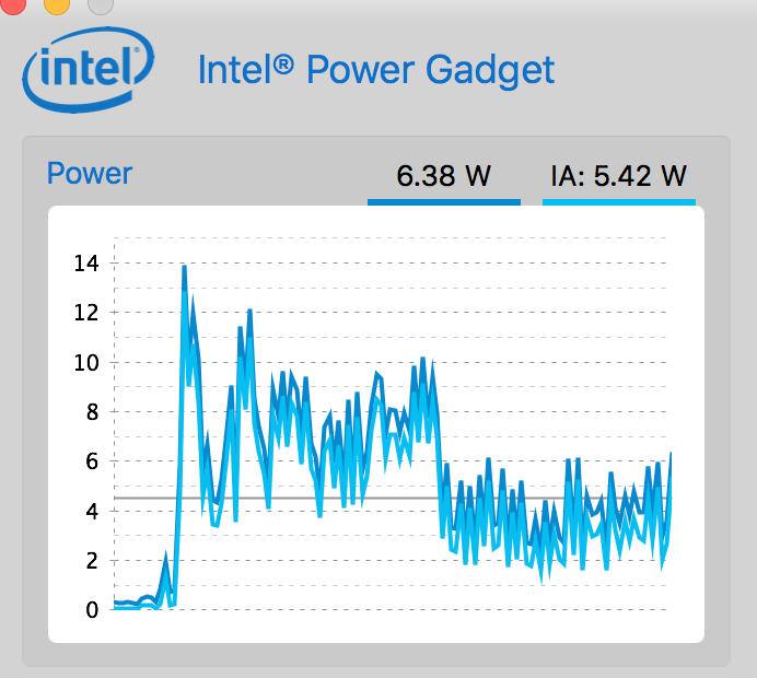

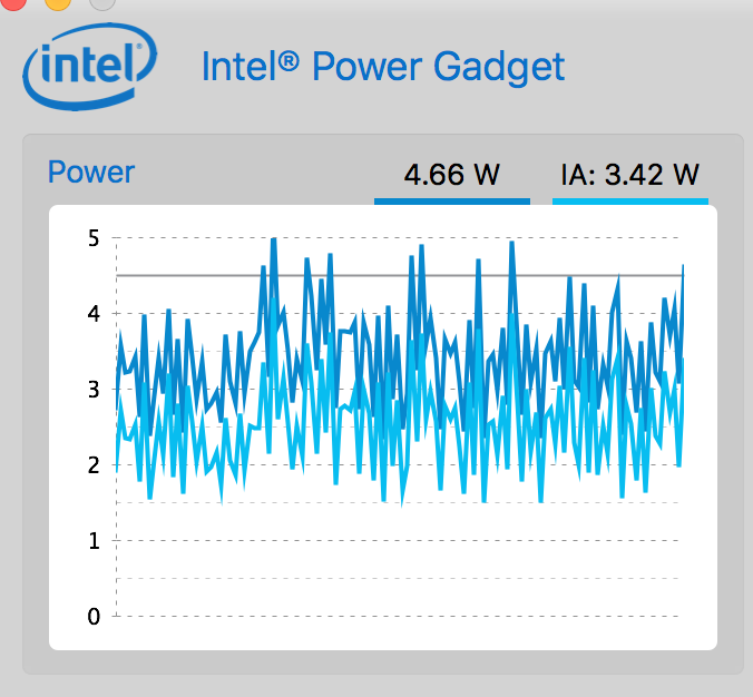

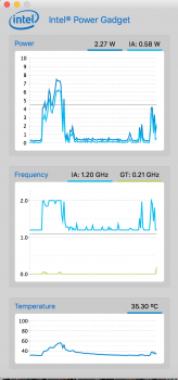

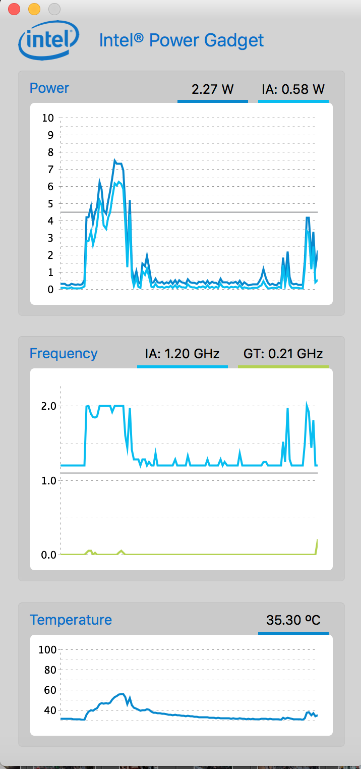

One final Power Gadget comparison, opening Lightroom. Once open it was left idle to see how quickly things returned to a low power state.
m3 on the left, m7 on the right.
