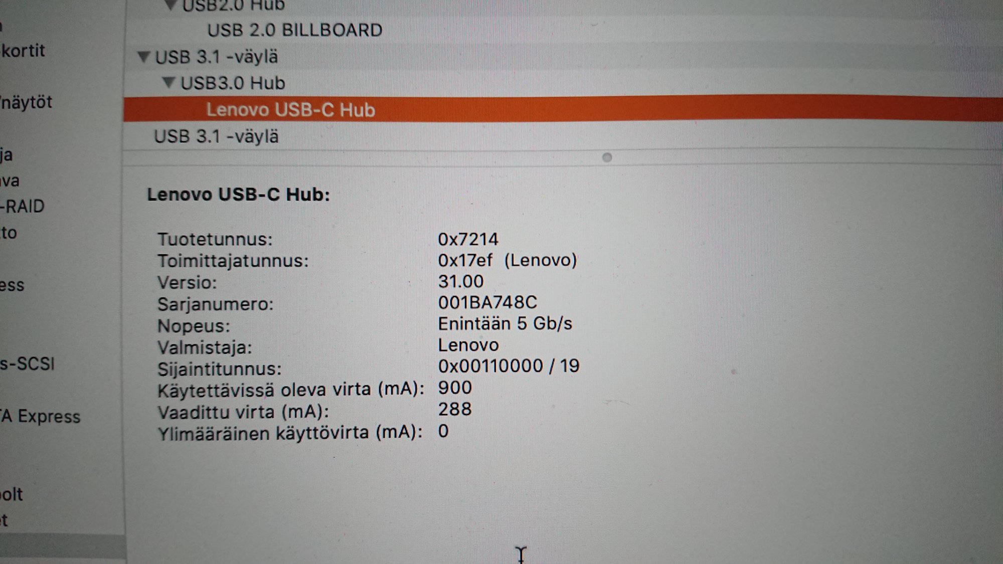

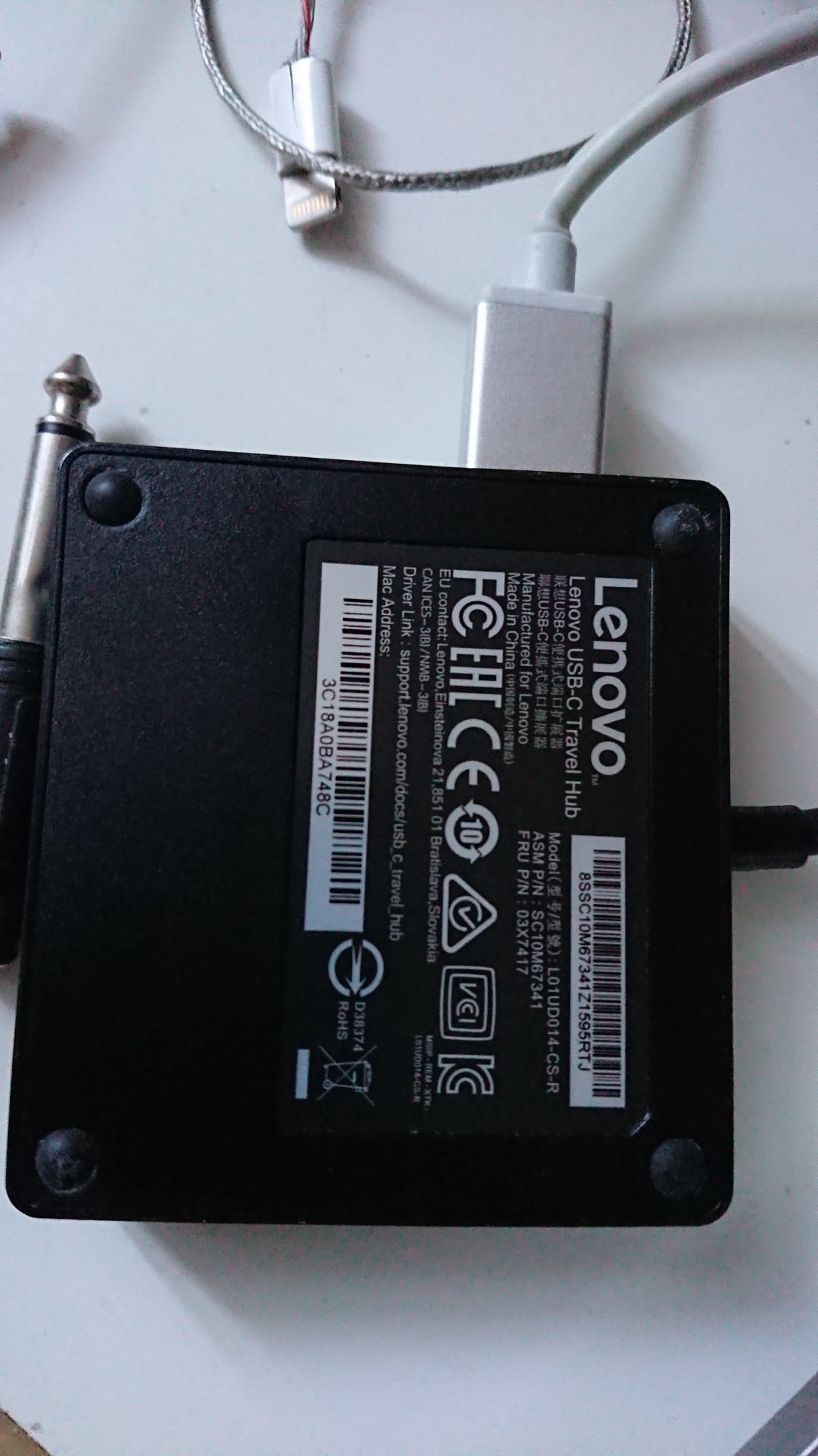

Helping one with a Macbook 13" Touchbar that bought a Lenovo USB-C Travel Hub for to get all needed ports. It was the only USB-C DONGLE they had in the store they went to.

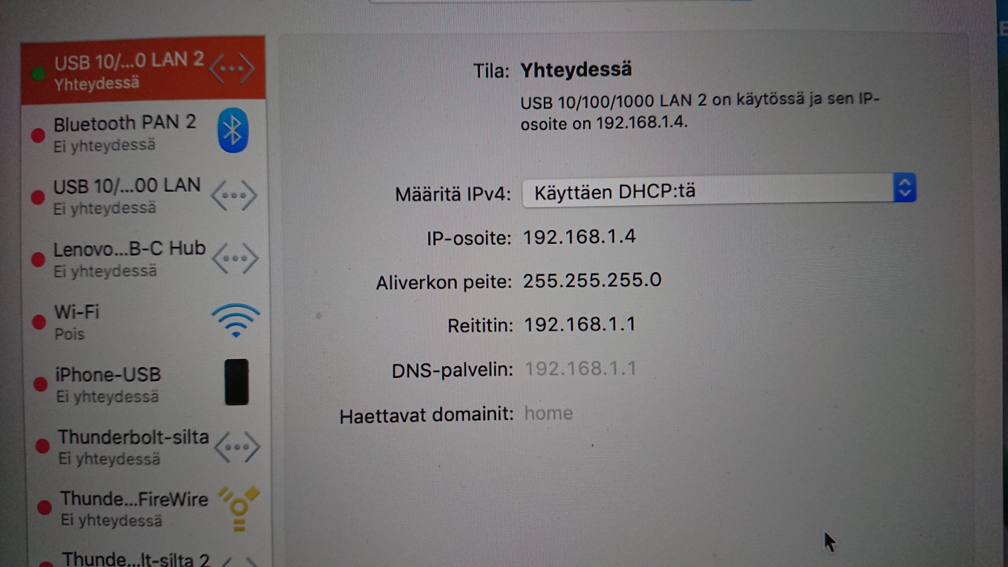

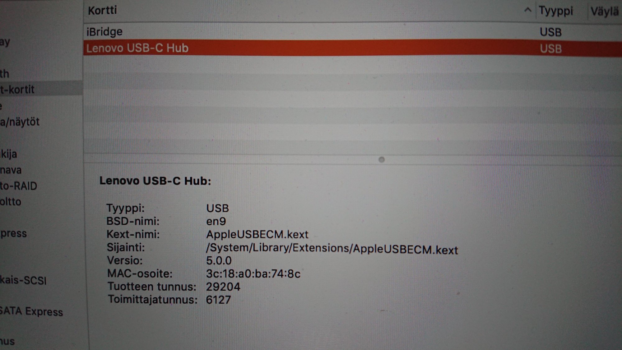

Issue is that with ethernet it get IP address and more from the router but it does not connect at all. Cant ping router, cant ping googles 8.8.8.8, surfing do not work. Browser just trying to load but nothing is happening. nothing... But connecting a macOS USB-ethernet adapter to the Travel Hubs USB-A port works with no issues.
Dont know what to do how to fix this. Drivers/kext issue?
Is there a known issue with the Travel Hub? At Lenovoes on product page a review says it works on mac.
Can it be the MAC pass-through that causes the problem?
Yes... I did take photos of screen instead of screenshots.

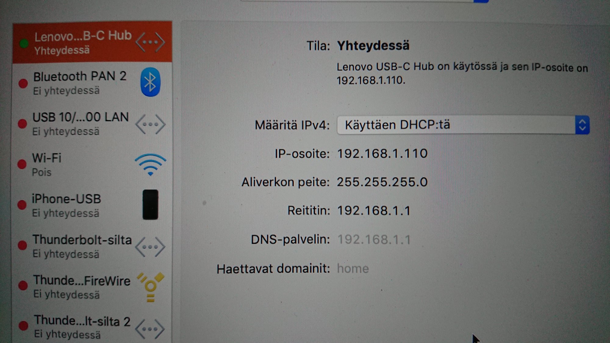

Found the problem. Under Network I removed the adapter, unplugged it and then plugged it in. It was once again added and now works. Dont know that the error was. Maybe some VPN or old firewall software of some sort that have changed some settings.
