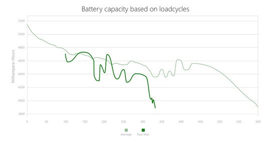

After noticing the battery degradation on my Early 2015 12" rMB last year, I bought AppleCare earlier this year, just before the 1 year warranty ran out. Glad I did, as the condition deteriorated to about 75% max charge before 350 cycles. So I decided to bring it to a repair shop.
There wasn't much debate, they just switched the bottom plate, which included the glued-on battery. Attached is a Coconut Battery chart for reference. It shows the amount of degradation that was enough for AppleCare to fix it with no fuss. They had some proprietary Apple tests, and those too reported a problem.
Hopefully this new battery can hold its condition better ... but if it doesn't, it'd better die before May 2018, because that's when my AppleCare runs out 🙂

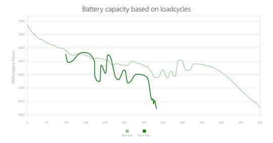

Thanks for the attachment.
It looks as mine is taking the same route as yours.
I am at 395 cycles, 20 months old, 81% health but last week I was as low as 65%. It has been fluctuating a lot (almost since day one) but not as much as the last couple of days.
Did you get the notification on your screen to change the battery? Was this at 75%.

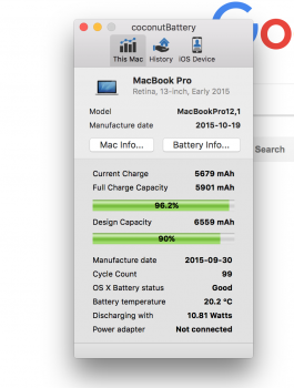

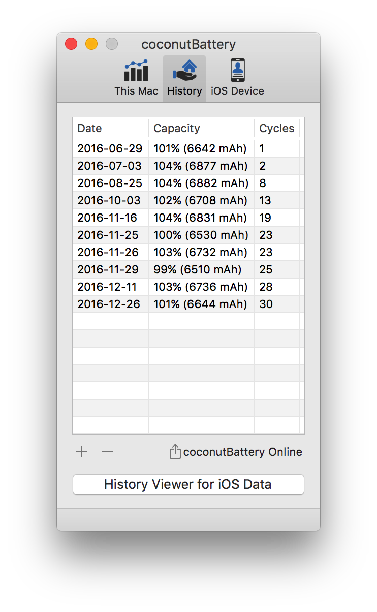

Hey guys. Ive been reading this thread b/c I am concerned about the battery capacity of my rMBP 2015 13". Is 10% of the design capacity being degraded within a year a reason to be concerned?
