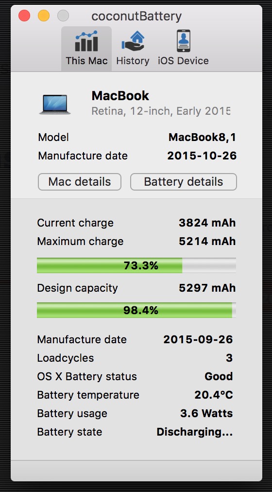

How does Coconut determine battery health percentage? My new rMB, built in 10/26/2015, now with 3 cycles on the battery, went from 99.6% health yesterday to 98.2% today.
Hey, it went from 98.2 to 98.4 to 98.5 as I'm typing this 😵
Are you talking about the Design Capacity % shown in the bottom green bar? That comes from the maximum charge divide by h design capacity. So for example if you had a maximum charge of 6000 and a design capacity of 6300 that would be a 95% "health" (6000/6300=.95).
It is normal for that to fluctuate around a little even when new.
Yes, and thanks for the explanation how Coconut makes that calculation.

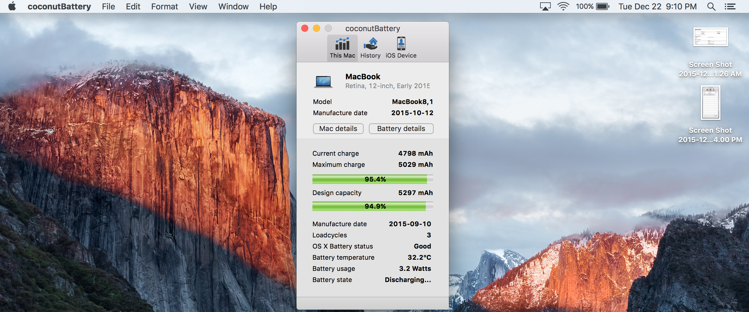

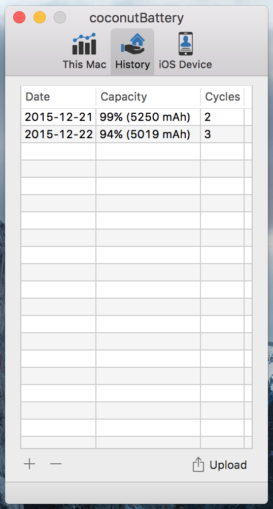

There's no way this can be right...right? From the 2nd to 3rd charge it went down to 94%?
That's 1 day!
That's 1 day!

if your mac is underload and warmer the battery health will de down by a few percent
if you let to charge it and cool down the battery health percent will rise

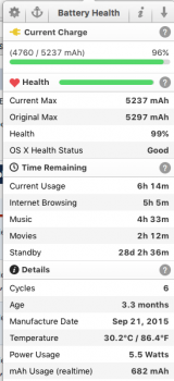

Just got my gold MacBook 2 weeks ago. Only 6 cycles so far (I think 3 were out-of-box) and reporting 99% battery life. We'll see how it goes over time.
My guess is that age of the battery is a huge factor too. My MBr was only used for 20 days today and only at 7 load cycles now... I'm at 96.1% already but my computer is nearly 6 months old based an manufacture date and the battery is even older. About 7 months.
