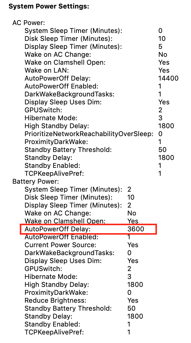

I've had several sleeping issues (but with my 2015 rMBP).
For me, AutoPowerOffDelay was the issue. If your timer is set to 28,800 in seconds, that's 8 hours of time before it actually goes to sleep.
So if you only go to sleep for 7 hours then it will not go into deep sleep before you even wake up in the morning. My suggestion is to change the values like mine: 7,200 or 3,600. I have had no issues since changing the values. I'll attach my battery rain from last night as well.
I'll edit the post when I find the terminal command.
***Edit: Copy this command into Terminal between the quotations: "sudo pmset -b autopoweroffdelay 3600"
1) Copy into terminal
2) Press enter
3) Enter admin password
4) Press enter
5) You should know be ok
Notes:
"-a" is ALL power management systems
"-b" is just BATTERY management systems
"-c" is just AC power
3,600 is 1 hour before it enters deep sleep
7,200 is 2 hours...
14,400 is 4 hours...
28,800 is 8 hours... aka WAY too long before it enters deep sleep...
