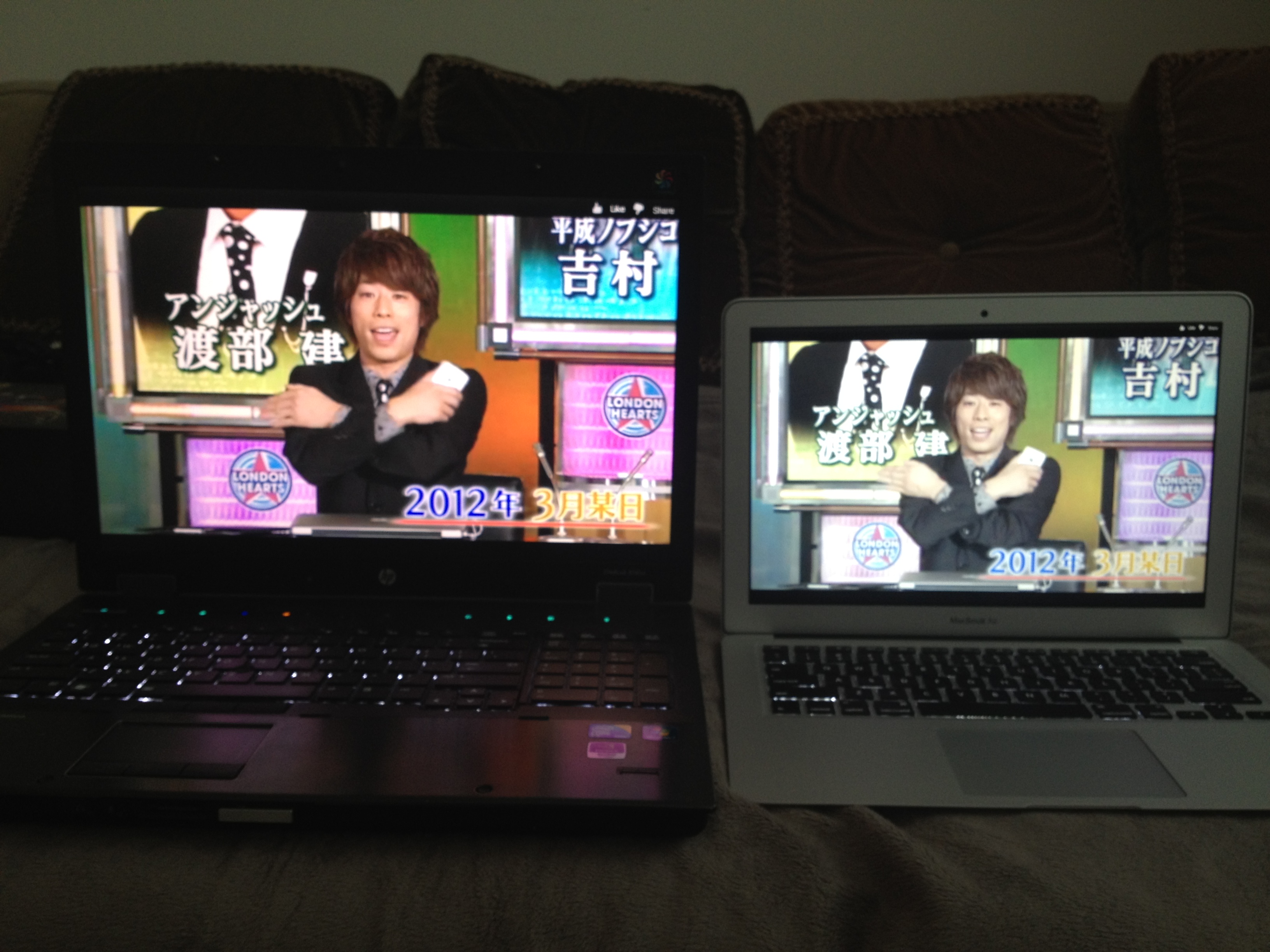

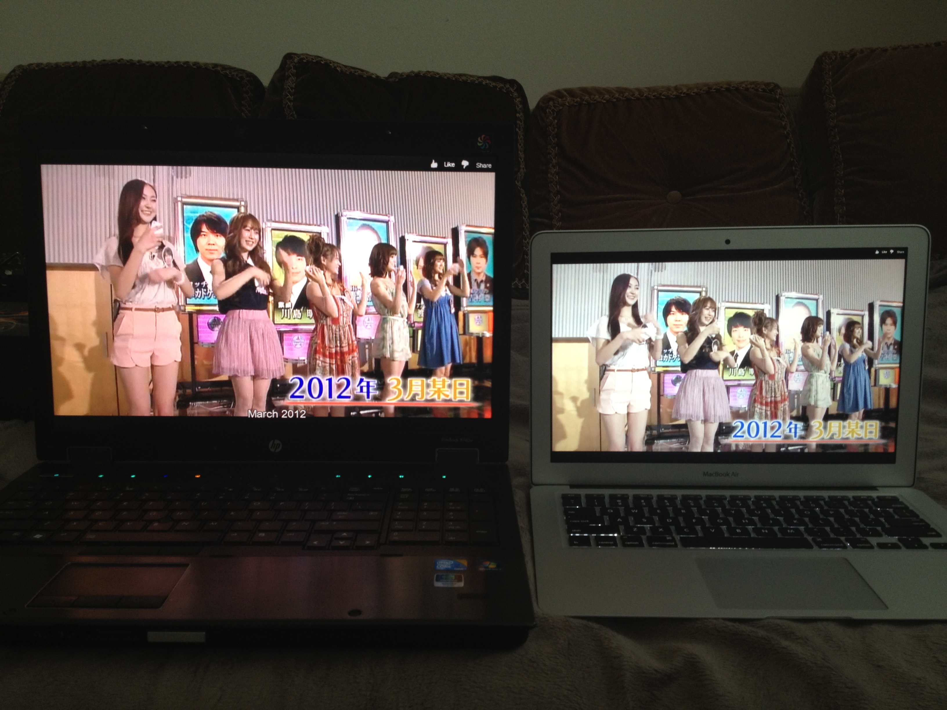

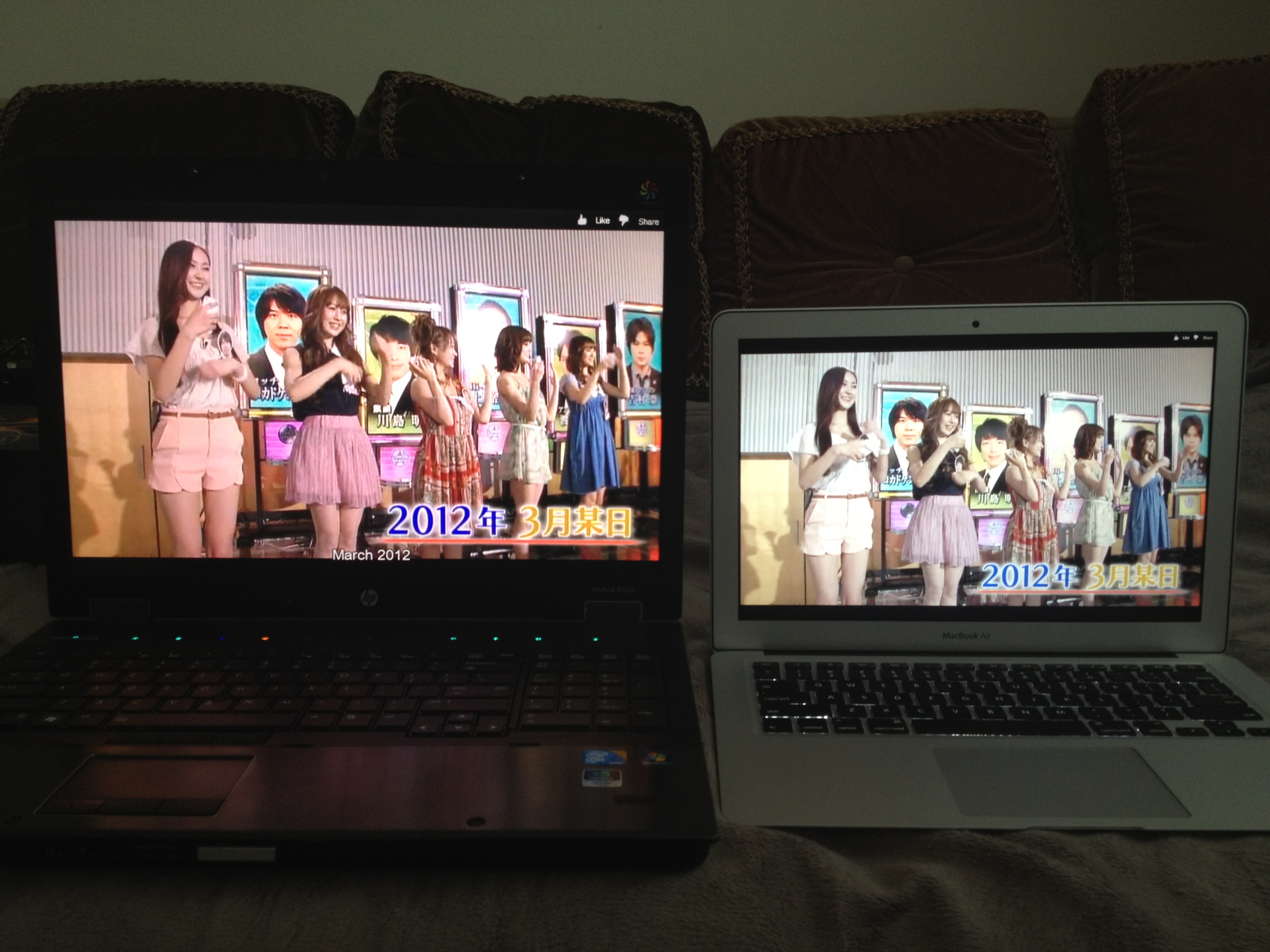

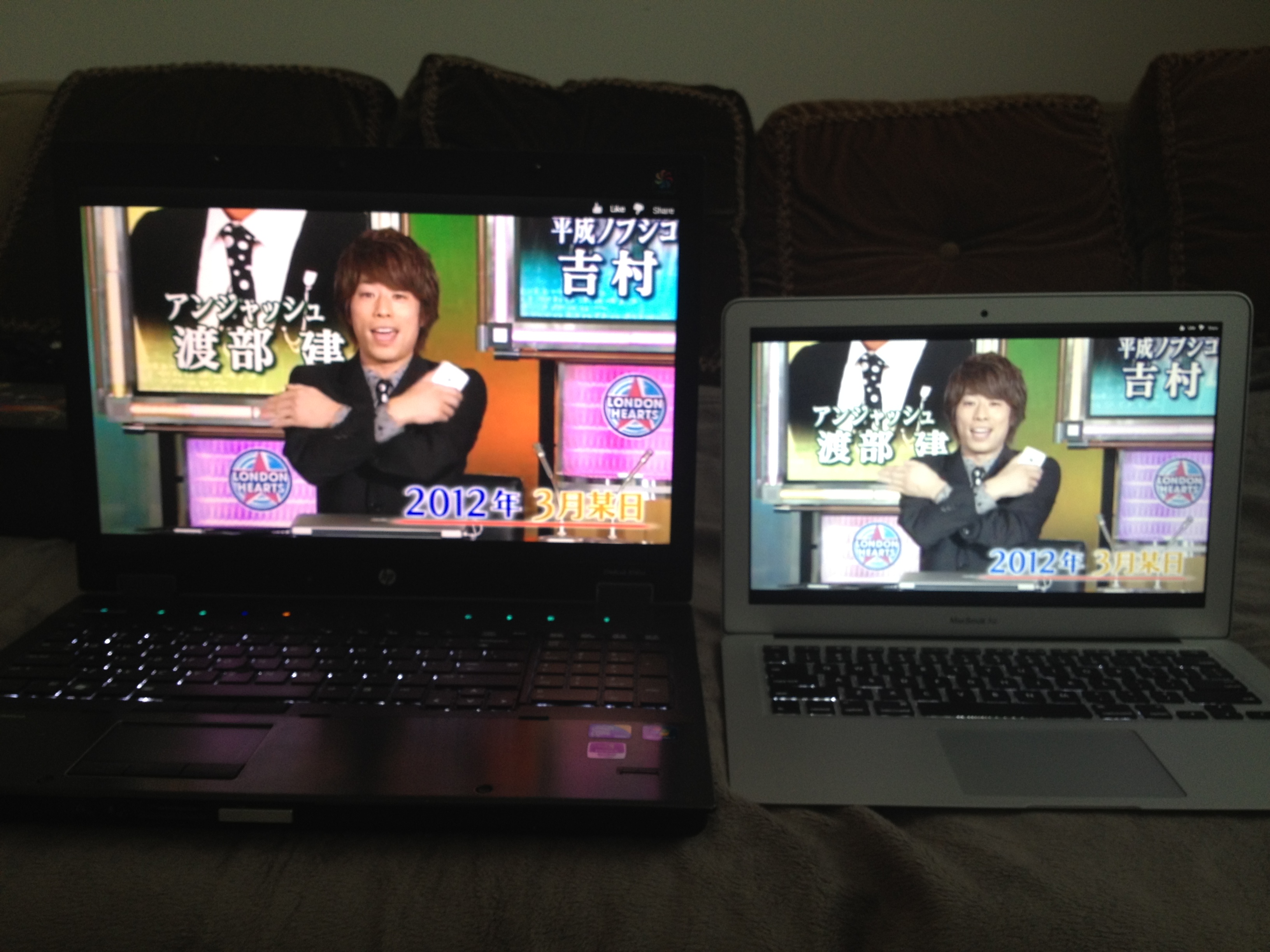

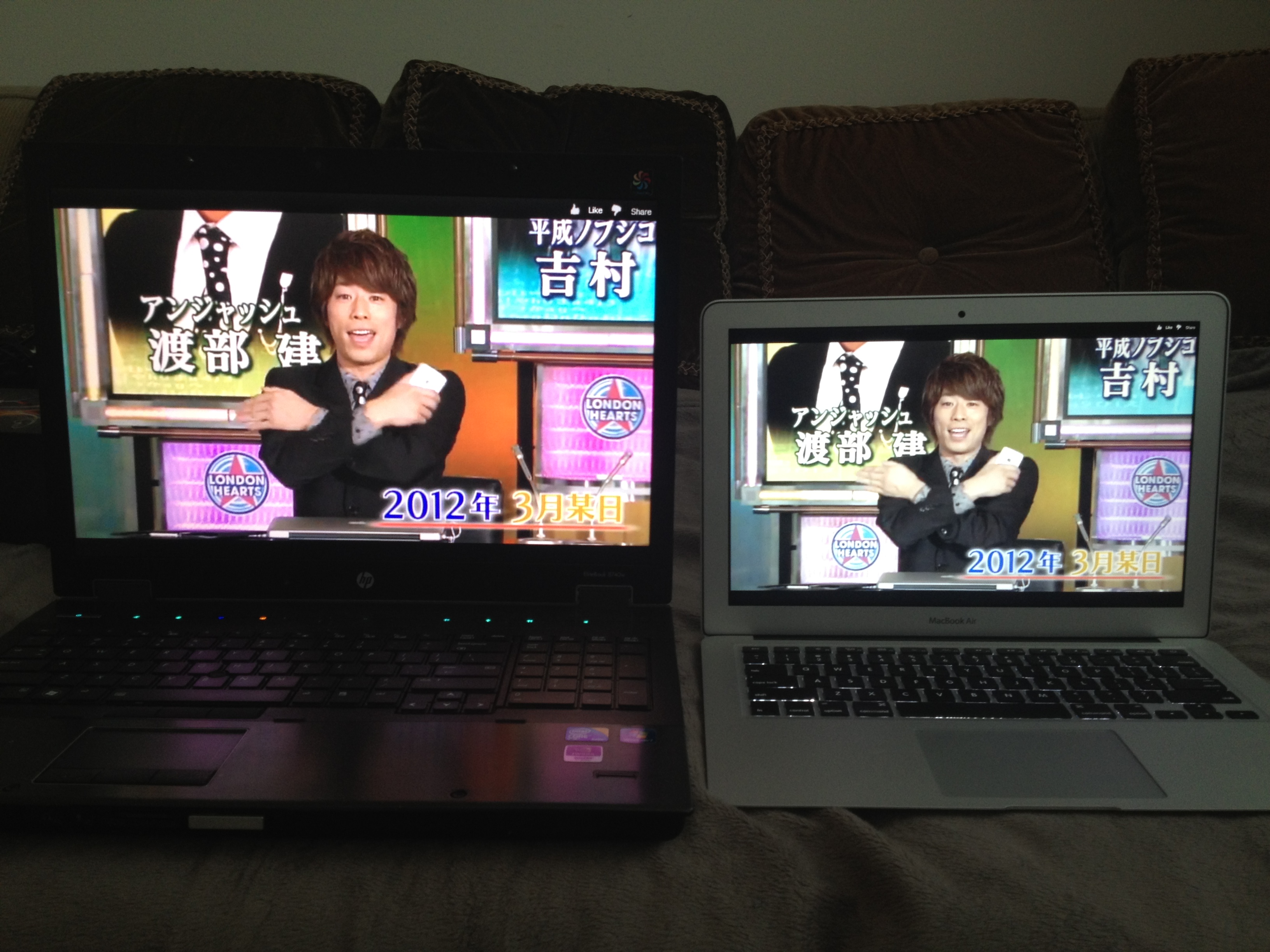

After playing with the profiles, the LG screen does look quite a bit better than stock, but I still won't be keeping it.
I know it's not comparing with another Apple product, but I just posted some pics of what we'll be coming from. (17" HP notebook with a DreamColor screen)
First picture is stock, and the second and third are using the profile found here - http://osxdaily.com/2011/10/30/how-...lay-in-a-macbook-air-and-make-it-look-better/
It was able to get somewhat close, but it's hard to go backwards in display quality. (Please excuse the poor pictures!)
I think I'll need to get a Apple store sometime to check out the Retina Pro in person. Which is what I "should" have done before actually purchasing the Air.
