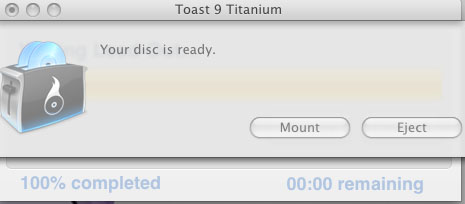

The only problem I have experienced so far is burning DL DVD's with the Macbook. Toast 9 and Disk Utility work for burning both single layer DVD's and CD's.
DL DVD problem may be the generic DL DVD's I'm using.
On the PC side absolutely no problem burning everything, even the generic DL DVD's.
Confirmation that the alleged power issue is "bunk".
Updated 9-15-08 The Macbook burnt DL DVD's perfectly using Toast 9 and TDK DL DVD's in place of the generic DL DVD's.

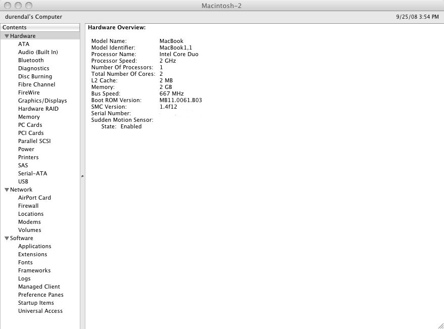

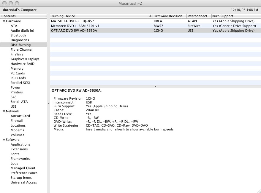

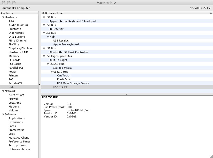

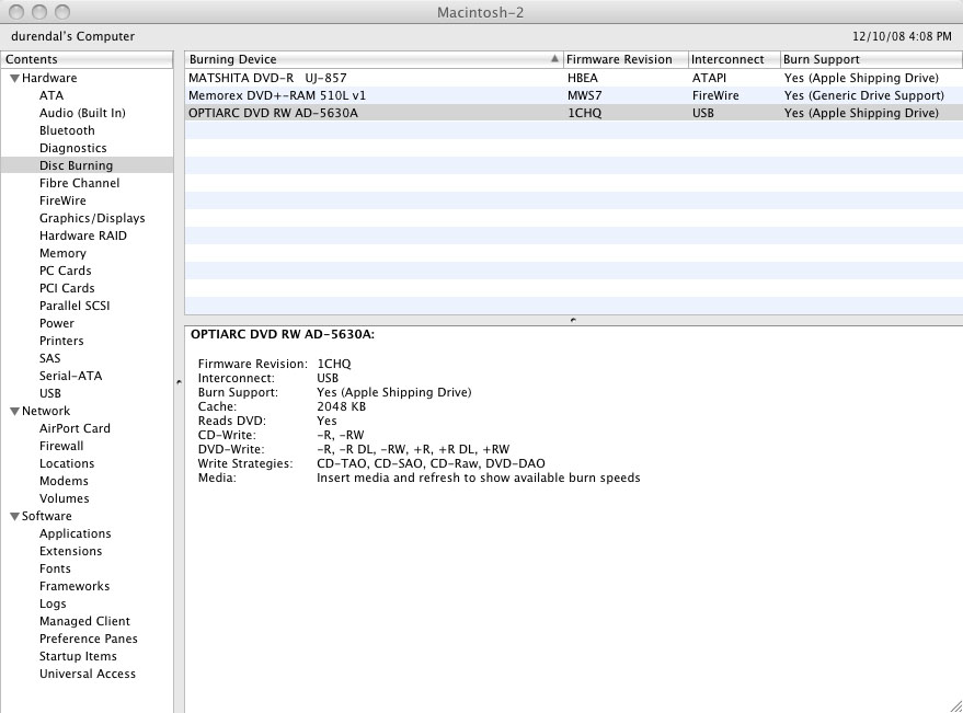

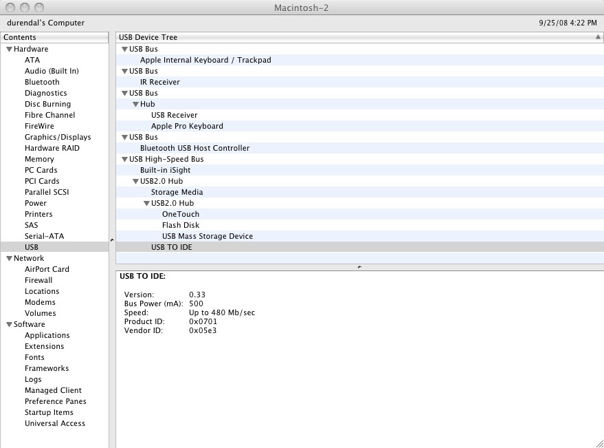

Herewith are some .jpg from my MacBook's System Profiler:
MacBook Air Superdrive 1.jpg:
The Hardware shows under Disc Burning that the OPTIARC DVD RW AD-5630A (MacBook Air Superdrive) is connected through the USB Interconnect.

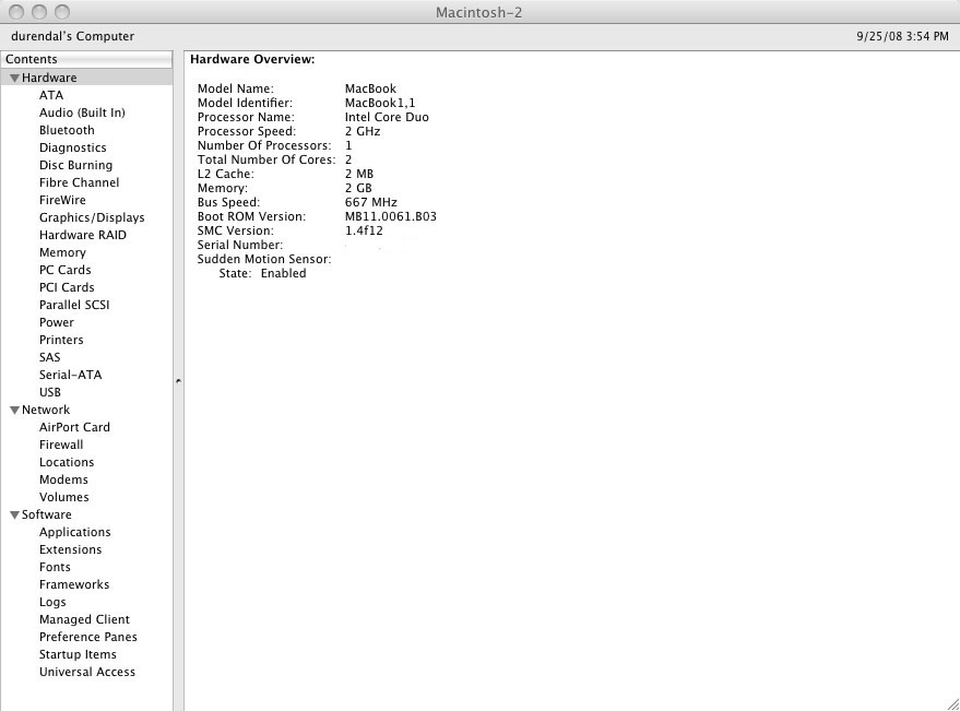

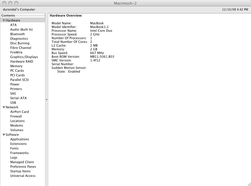

MacBook Air Superdrive 2.jpg:
The Hardware Overview shows that the computer is a MacBook 1.1 not a MacBook Air.

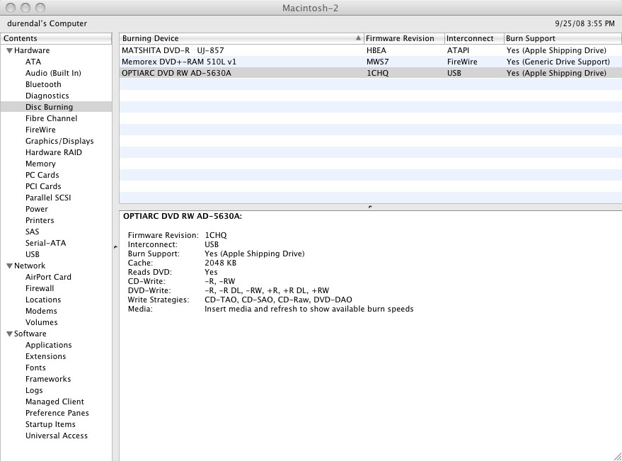

MacBook Air Superdrive 3.jpg:
The Hardware shows under USB that the USB TO IDE is recognized and I am running it through a Hub. Please Note the Bus Power (mA): 500
Hopefully this puts the alleged High-Power USB Port issue finally to rest once and for all.

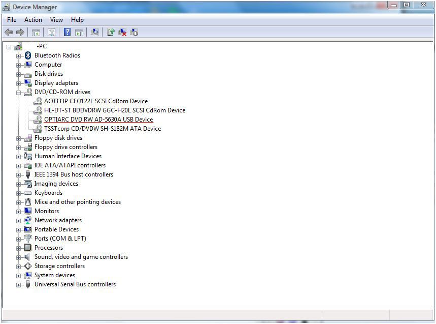

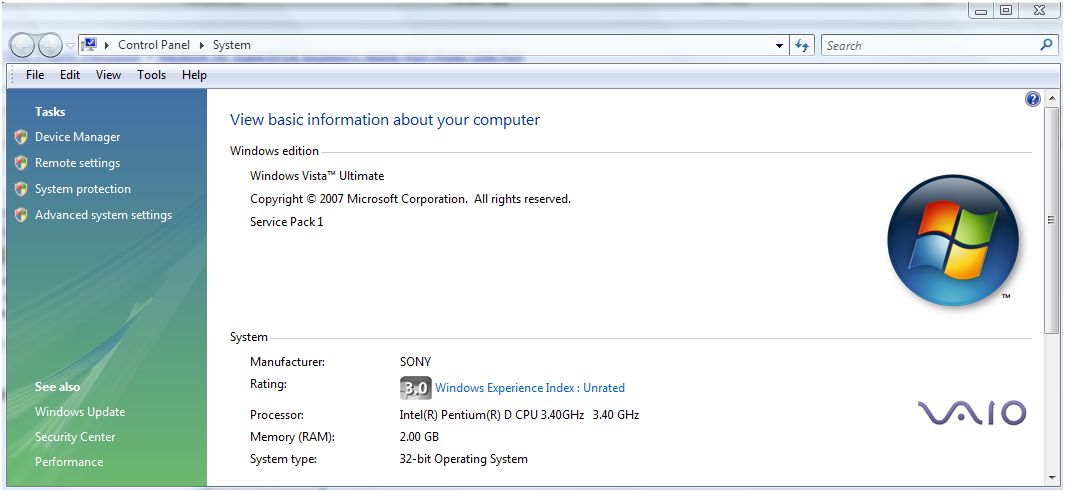

I attached a couple of more pictures from the VAIO showing the MacBook Air Superdrive recognized on the PC side:
VAIO MacBook Air Superdrive 1.jpg:
The System Profiler shows that the computer is a Sony Vaio running Windows Vista Ultimate Service Pack 1
VAIO MacBook Air Superdrive 2.jpg:
The Device Manager shows under DVD/CD-ROM drives that the OPTIARC DVD RW AD-5630A (MacBook Air Superdrive) is connected as a USB Device.

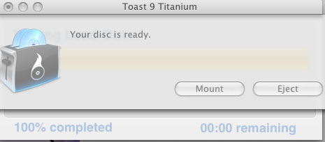

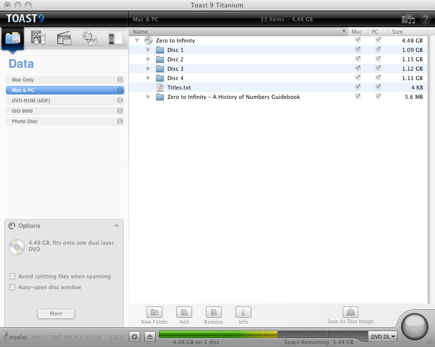

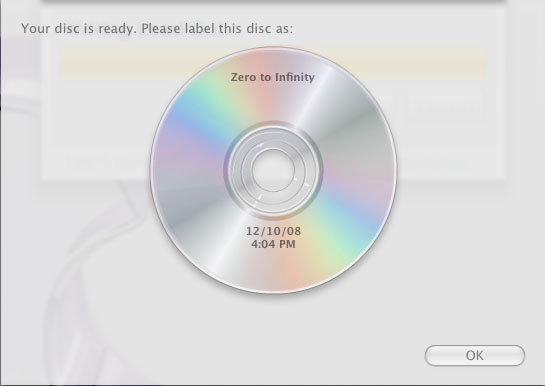

Some System Profiler and Toast Burn pics of a DL DVD showing the Optiarc DVD (MacBookAir Superdrive) being used successfully with my First Gen MacBook!😀

The tnkgrl hacked MacBook Air Superdrive works fine on a USB hub (see above posts)

Update on my status:
Thank you very much for the detail, it is very, very helpful.
It has kind-of worked for me. My MBP recognizes the drive and it will mount a CD I put in it.
But Toast (8, update) will freeze on startup when the drive is plugged in to my machine, and when I tried to burn a test disc through disk utility, that froze too.
My solder points are a mess, so I'd guess I've got a bad connection. I'm going to resolder it, but I haven't had time. Hopefully I haven't fried the board by overheating it.
Also just to note, getting the case off the drive was very tough. My drive barely had enough room for a credit card to fit and I had to use a screw driver to help nudge the old credit cards in place. Once you get one side off, the whole thing just pops off.
