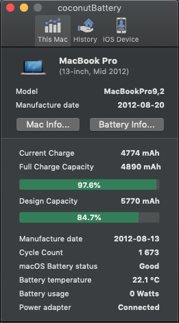

This is a good example of an Apple battery that has not seen much Windows. It can still give you 8-10 hours with light usage:
