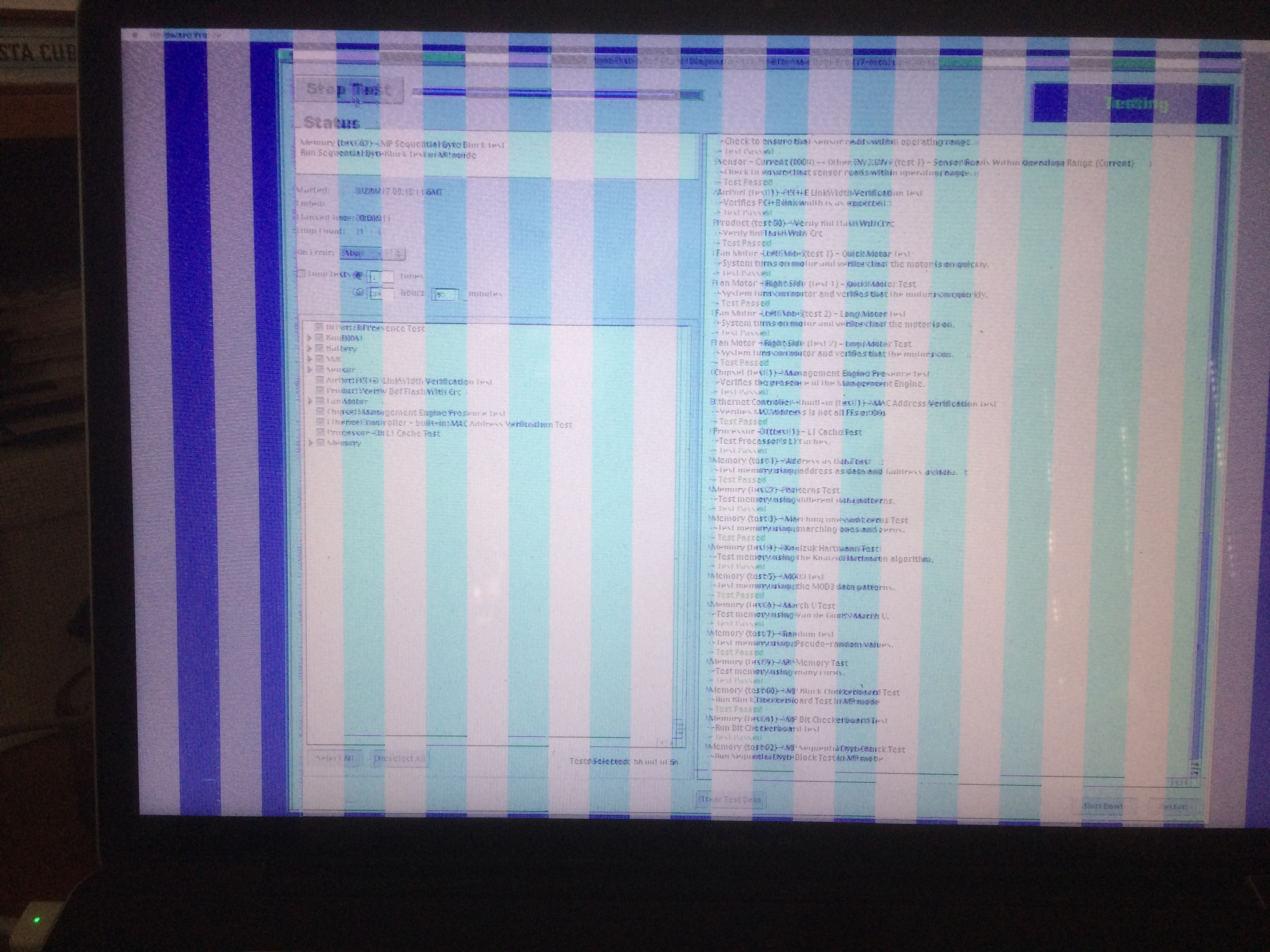

Last week, unbeknownst to me, my MacBook Pro woke up from sleep and crashed, overheating for several hours by itself. When I found out, I tried to wake it up, but I had to force it to shut down. I powered it up again, no problem. I put it to sleep. The next day, I decided to do some stuff on it so I logged in and I launched a few things. Suddenly, as I was in the next room, I hear the start up chime "your computer has restarted because of a problem". Okay, then, why not. But then, I got more and more random crashes through the day. On Friday, I decided enough was enough and I would seek what the problem was.
Apparently, there was some issues with permissions, so I fixed that, but I could also see that there was some GPU restarts. Also, I had a very nice "too many failures, system is giving up". A AHT gave me a false positive in the name of the Sata error (don't have the code name right now) but it can appear if you have an SSD inside the computer.
At this point, I have to say : the first time I did the AHT, it crashed during the test, freezing the screen and pushing the image to the right with a gray veil on top of it. Weird. Second time, it passed with that weird error.
With the help of some friends from the French forum, we decided it was the hard drive (also, when I opened the computer, I could see it was slightly unplugged). I removed it, to leave only the SSD I place. I then used a brand new session. It worked fine for hours. I was sure the problem was fixed and my computer was saved. It passed the AHT with flying colors.
I decided to plug in my thunderbolt screen.
It crashed instantly. On reboot, it would get stuck on the chime in a loop. Only a SMC reset got it past the chime. Then it booted normally. I thought, no more thunderbolt for you.

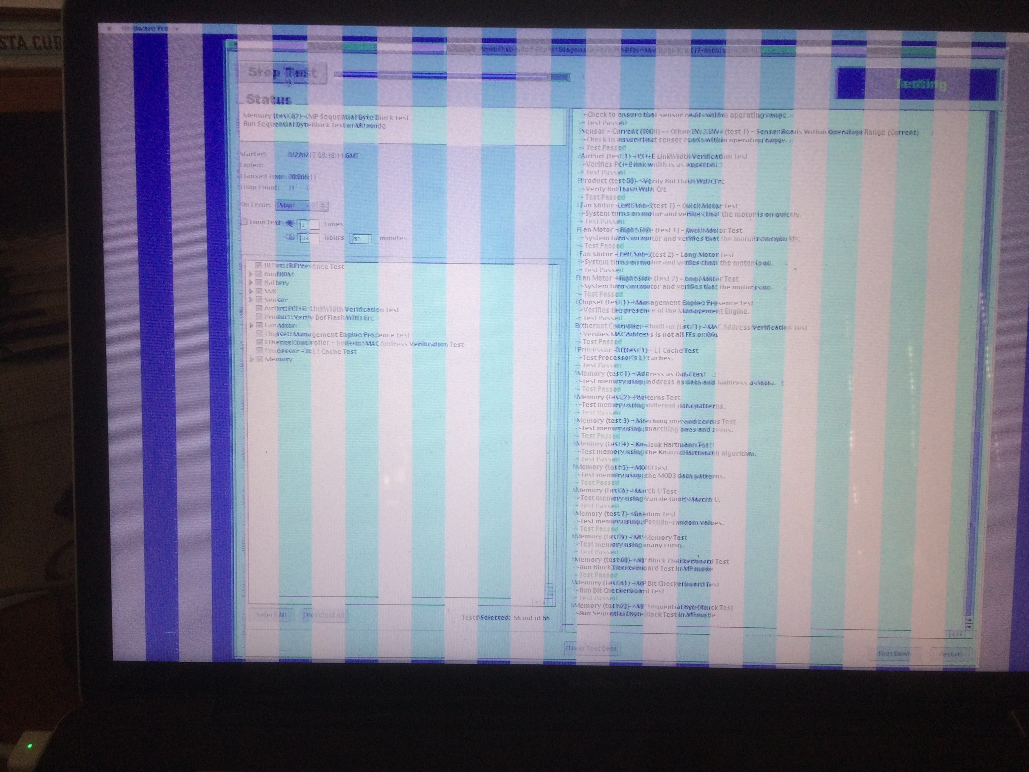

So at that point, we were pretty much sure the problem was with the graphic chip. I ran the Apple Service Diagnosis. Which began by crashing in EFI mode after completing about 99% of the test successfully (it crashed on the memory test. I know my memory is perfectly fine. I tested it already, and I had just replaced it with the original ram I got with the computer). It crashed with nice vertical lines in the screen. Graphic chip, right?
I ran it again, in OS mode. It PASSED. All the tests were successful. I decided to run the user interactive tests, because why not. All went well, and one of the last test is "successful wake up from sleep". It never woke up. It tried and got stuck in limbo, started to overheat (with a black screen) and was unresponsive. I had to force it to shut down.

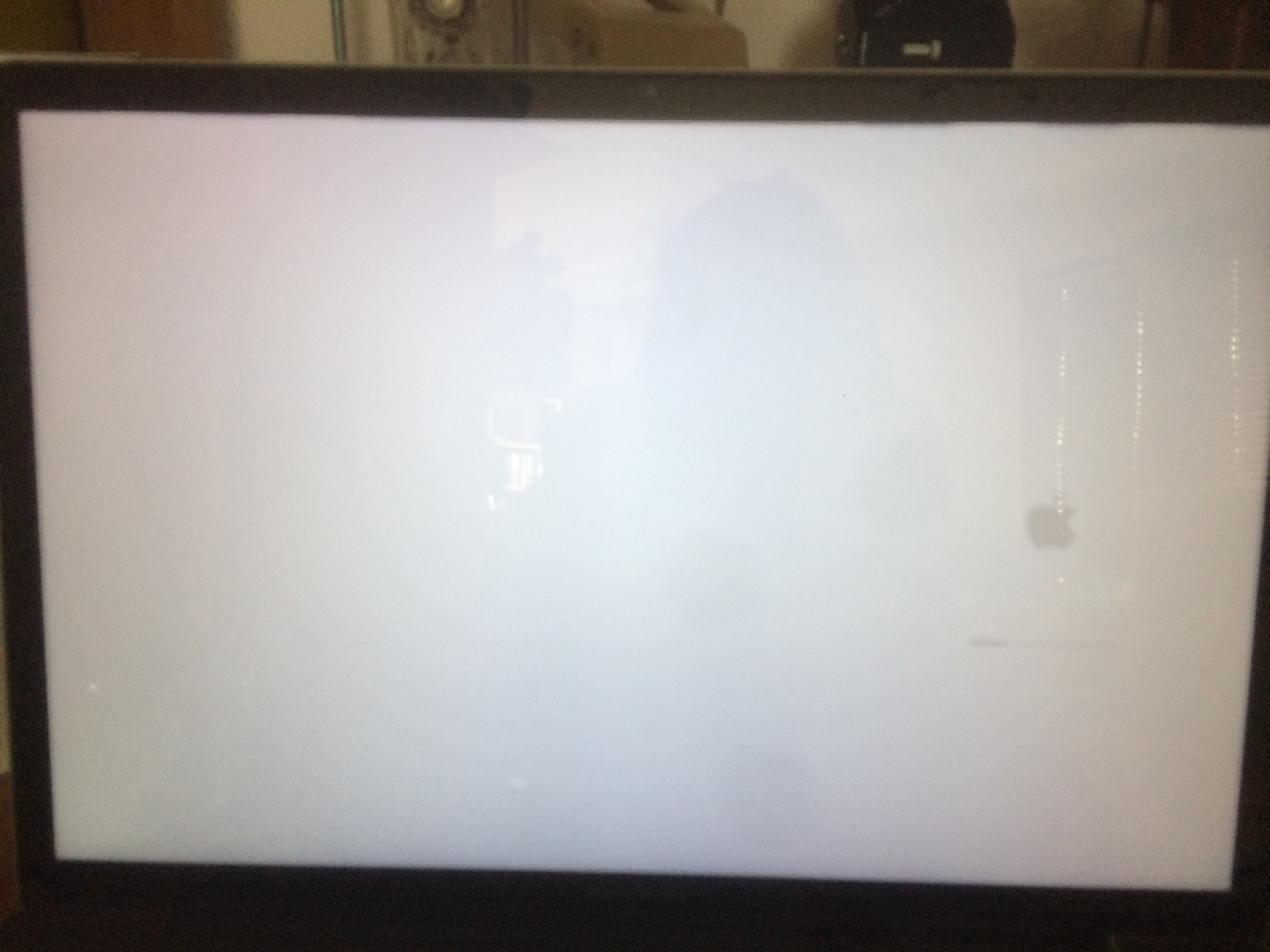

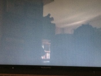

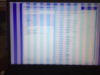

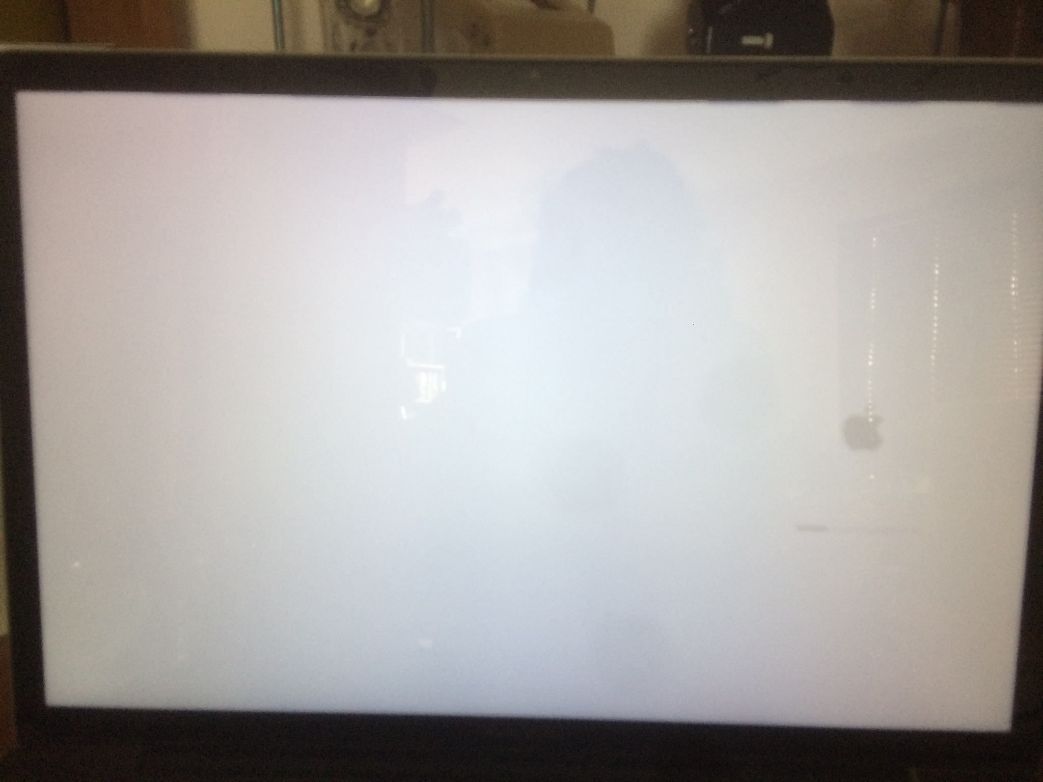

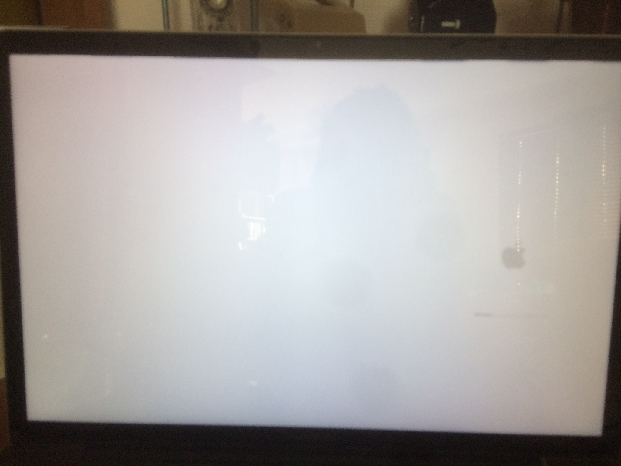

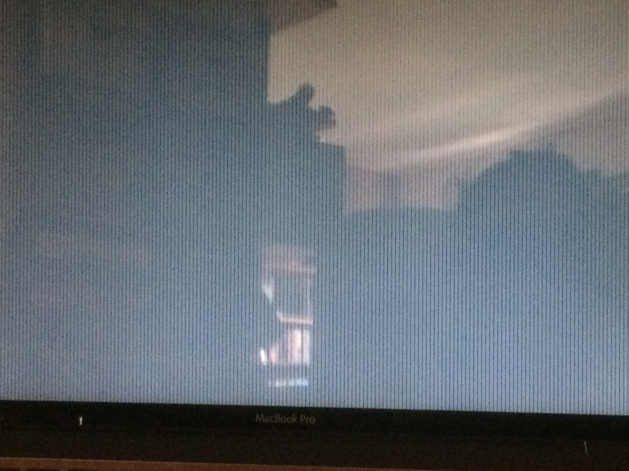

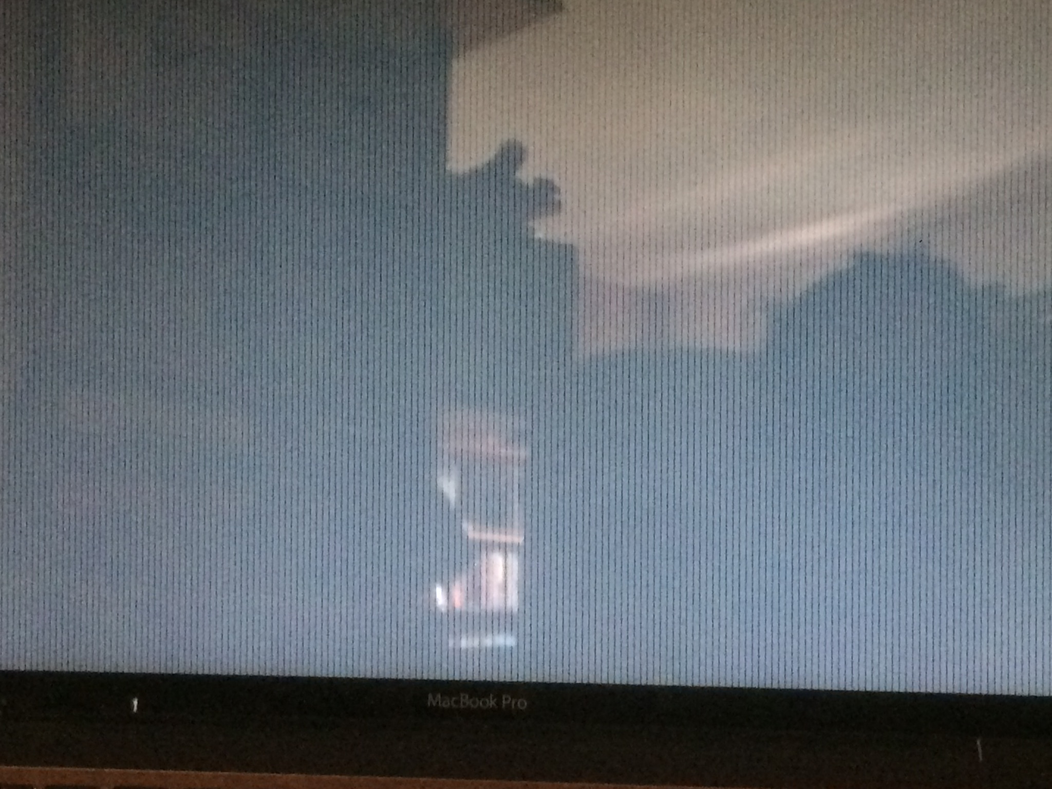

After that, I was never able to boot it again. It would either loop chime, either chime then show a screen filed with horizontal lines (I made a video =
), either with vertical lines, either do nothing. No chime, no lines, black screen, but still it was powering on (a plugged in hard drive would light up and one could here a very faint hum coming from inside the computer. Also, the led in front of the computer would light up). SMC reset would sometimes make it switch between these three states.
By leaving it alone for hours, I could get the one chime white screen with moving horizontal lines followed by a gray screen back. Once, I even got the apple (except it was on far right side of the screen) and the boot progress bar stopped a third of the way.
I forgot to mention at that point I had also removed the SSD and had tried booting from an external system, both in thunderbolt and USB (I have a LaCie thunderbolt SSD with a clean El Capitan OS) to rule out anything OS or internal SSD related. Before I had the problems with the thunderbolt and the whole system not booting again, I could work fine with the external disk.
Right now, it's not doing anything anymore. No chime, no gray screen, nothing. Just the faint hum, nothing else, powering on any external drive that's plugged in, an external display is obviously showing nothing, SMC reset doesn't do anything anymore. I tried unplugging the battery for two minutes and plugging it back, because why not, it didn't change a thing. Battery is charging, battery status light are working perfectly, I changed the MagSafe adapter twice already to rule out a bad power brick.

That does look like the GPU failure. Mine failed differently, but I have seen that one as well.
The short version is: no, not really. You can't really disable the chipset.
I wouldn't put any money into getting fixed, either.
I also have a love of the 2011s, but this one appears to have met its end.
🙁 Is there no way to get it to at least boot again? Why isn't is making the boot up chime? Is there a reason?
There are people who replace the GPU when it's the Radeon that failed, and it's not that expensive. This Mac is an old machine but it's still the most powerful machine I own (I'm quite poor ^^ I really have no money for a new laptop. I do have a MacBook Air 11" mid 2012 that I use to write and go on the Internet, but the 17" was the one I was working with for InDesign and Photoshop, and I can't really do that with the smaller guy, it's not powerful enough).
So if there's the slightest chance that it could be the Radeon and that I could get it to boot one way or another, I could send it for repair and get my computer back for less than $200 (if found a guy in Germany, I'm waiting to hear back from him). But I don't want to send him my computer and pay for shipping to and from Germany if it's not possible to repair it (if he doesn't manage to repair it, he doesn't make you pay anything).
Look for graphics card reflow services. It's definitely the dedicated chip. Once reflowed you can use https://gfx.io to keep it to integrated only.

The GPU chip is soldered onto the motherboard. It is not easy to replace, and I would be hesitant to trust any company that claims they can replace them.
The replacement for the GPU is to replace the logic board, which is around a $3-400 part, not counting the labor. It is not booting or chiming because the failure is most likely causing a short on the logic board.
I would not put any money into this laptop. Even laptops Apple replaced the GPUs on have a recurrence of the problem. iI would take that money and at least buy a more recent used Macbook Pro or Air. It will not be fun coming off the 17" screen.

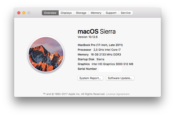

If you could get it fixed somehow I recommend upgrading to (High) Sierra. Not sure if this is also the case for El Capitan, but I tried Yosemite for a while a week ago and after upgrading to Sierra again it was using the dGPU much less, also the fans kick in much later.

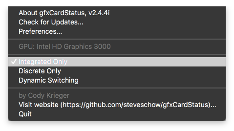

As already written by someone else you should also install this if you don't depend on the dGPU:
https://github.com/steveschow/gfxCardStatus (It's a fork of the original one by Cody Krieger who does not update it anymore for new macOS versions.)
And have a look at this thread if you can't fix it:
https://forums.macrumors.com/thread...ntel-integrated-gpu-efi-variable-fix.2037591/

Oh, yes, I already did and it gave me some hope, but I can't get it to boot 🙁 That's why I was trying to see if you guys had any idea how I could get it to do the beloved chime again...
you can throw away even $1000 for repairs and still don't have fully functional laptop or after few weeks GPU can die second time
also these Radeon chips it's a grey area and there is no brand new chips on the market, Chinese guys selling used or refurbished chips which they doesn't have long life time span or even they are faulty "out of box"
I did not try it yet because it looks a bit complicated but I'll let you know if it works when I have done it.

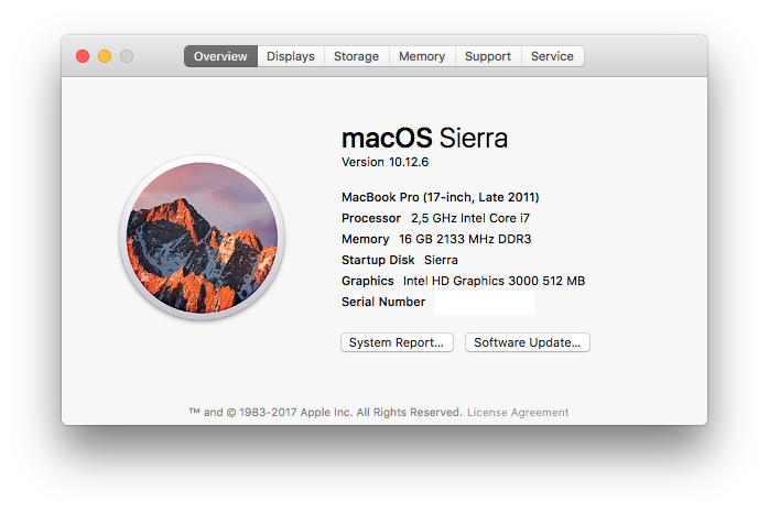

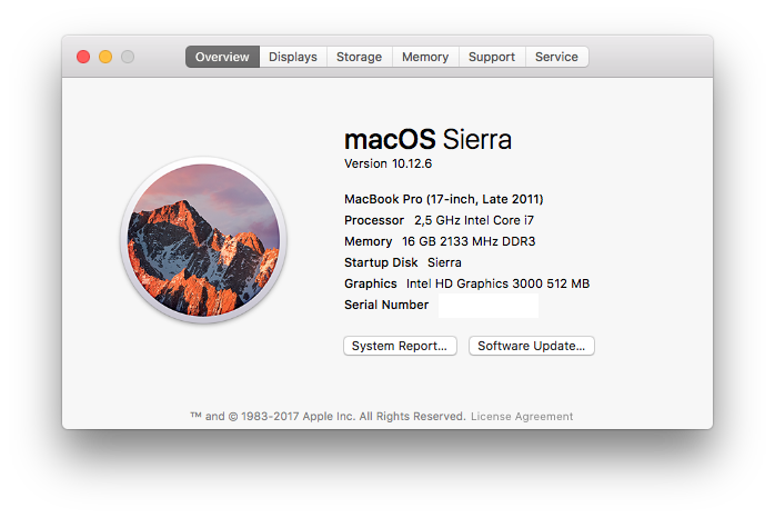

My MBP is the same as your's:
Thanks!
At the moment, if something is wrong with the soldering, I guess even deactivating the chip won't change my problem, though (reflowing might. I'm starting to consider it... ).
There is a whole thread on how to force these machines to disable the dGPU and use the integrated GPU. Although it describes the 15" model I believe it is exactly the same process for 17". This should at least allow you to use the iGPU and get some more life from the machine.
Force 2011 MacBook Pro 8,2 with failed AMD GPU to ALWAYS use Intel integrated GPU (EFI variable fix)
edit: I didn't read far enough in your post to see that it no longer chimes :-( The fix above requires you to be able to chime and boot.
