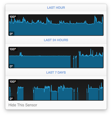

It feels like over the past year my MacBook Pro (Retina, 15-inch, Mid 2015) has been running hotter and hotter.
Here's a graph of the last 7 days for CPU Core 1:
It has the Radeon M370X GPU but that seldom goes above 60C. The CPU itself seems to average 70-99C. Are the temps above normal? Anyone experienced their Macbook getting hotter and hotter over time?
If you live in a dusty area, may be well worth having the cooling system cleaned out. Thinner systems generally have less
surface area for cooling and more prone losing efficiency. Can also be related to software updates.
You will also get a better quality of response if you can detail the applications running, around 70C doesn't surprise me for a 15" MBP with dGPU. If the monitoring App is looking at solely CPU core temps I wouldn't be concerned, unless a sustained 80C+

What do you do with it? My 2014 MBPr 15 is usually between 80-100C in terms of CPU temps when doing work, although at idle with one display + built-in display it sits at about 55 C and at idle with 2 displays + built-in around 60 C.
Software dev work mainly. IntelliJ, Sublime, Docker and a zillion Safari and Chrome tabs. Always connected to a 3440x1440 external display.
From the above info you've both given seems my temps are about normal then. Thanks.

It sounds that way. My work is more CPU-heavy than GPU-heavy, and it sounds like your work has the same CPU-heavy usage to it as well.
It couldn't hurt to clean the fans/ducts with some compressed air if they have tremendous dust accumulation. I did this with my 2014 last month and, while it had minimal difference on overall temps, there was a ton of dust in it and I am glad I removed this buildup.

Thanks I removed the bottom plate and blew out a fair bit of dust (keep my Macbook on a stand 24/7 so surprised at just how much there was). The fins on the heatsinks are very finely spaced so I can certainly imagine them getting clogged in dusty environments or if you're inclined to use your Macbook on a table cloth or bed.
I also replaced the thermal compound with Arctic Silver 5, this helped a little but I wouldn't recommend it if your Macbook is in warranty or if you're not very handy - I'm seeing maybe a 5-6C drop in temps which is nice but nothing to write home about.

That sounds about right. Your computer wasn't overheating and operating within guidelines so you won't see much of a difference. If it's shutting down and stuff then it's getting too hot, otherwise it's just normal.
