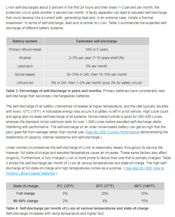

According to that link:
"Li-ion self-discharges about 5 percent in the first 24 hours and then loses 1–2 percent per month; the protection circuit adds another 3 percent per month"
A lot depends on whether you are putting the computer to sleep or actually shutting it down. But this isn't something you should concern yourself with really. Why don't you leave it plugged in at night? Is it imperative you are able to charge it one day and then not use it for a week, but then must use it on battery?
Between 80-100% battery capacity is effetely 'overcharged', so that range depletes the fastest. At around 80% the battery is at an optimum level. So I'm guessing you are taking it straight off charge and turning it off, and then becoming concerned about percentage loss the next day?
"Self-discharge is not a manufacturing defect but a battery characteristic"
And
"The energy loss is asymptotical, meaning that the self-discharge is highest right after charge and then tapers off"
And

The self-discharge curve of batteries is not linear. A 1% drop in the first day after charging does not mean there will be a 30% drop over 30 days. There is a sharp drop in discharge right after charging then it levels out considerably as shown for lithium ion batteries in Figure 5.
http://batteryuniversity.com/learn/article/elevating_self_discharge
