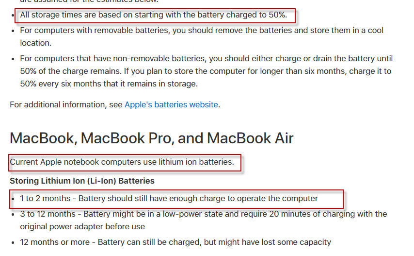

Pulpe, I would use the Apple link peraspera provided to support your claim. 50% charged MBP should last up to 60 days and still be able to be powered on which means discharge rate should be within ~0.8%-1.5% per day. If your 50% charged MBP discharges entirely to the point you can't turn it on in less than 30 days there is definitely an issue.
Pulpe, I would use the Apple link peraspera provided to support your claim. 50% charged MBP should last up to 60 days which means discharge rate should be within 0.8%-1.7% per day.
