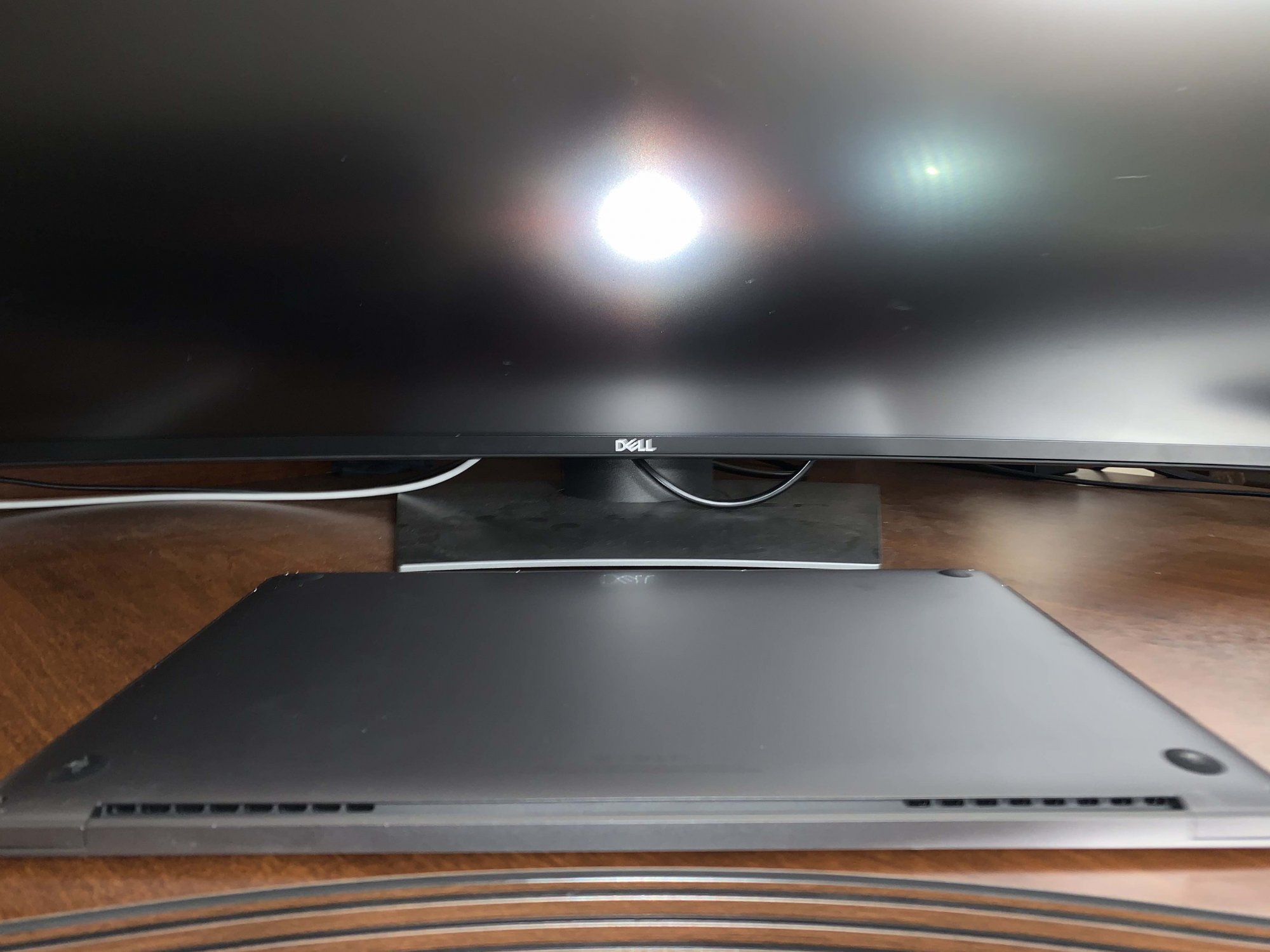

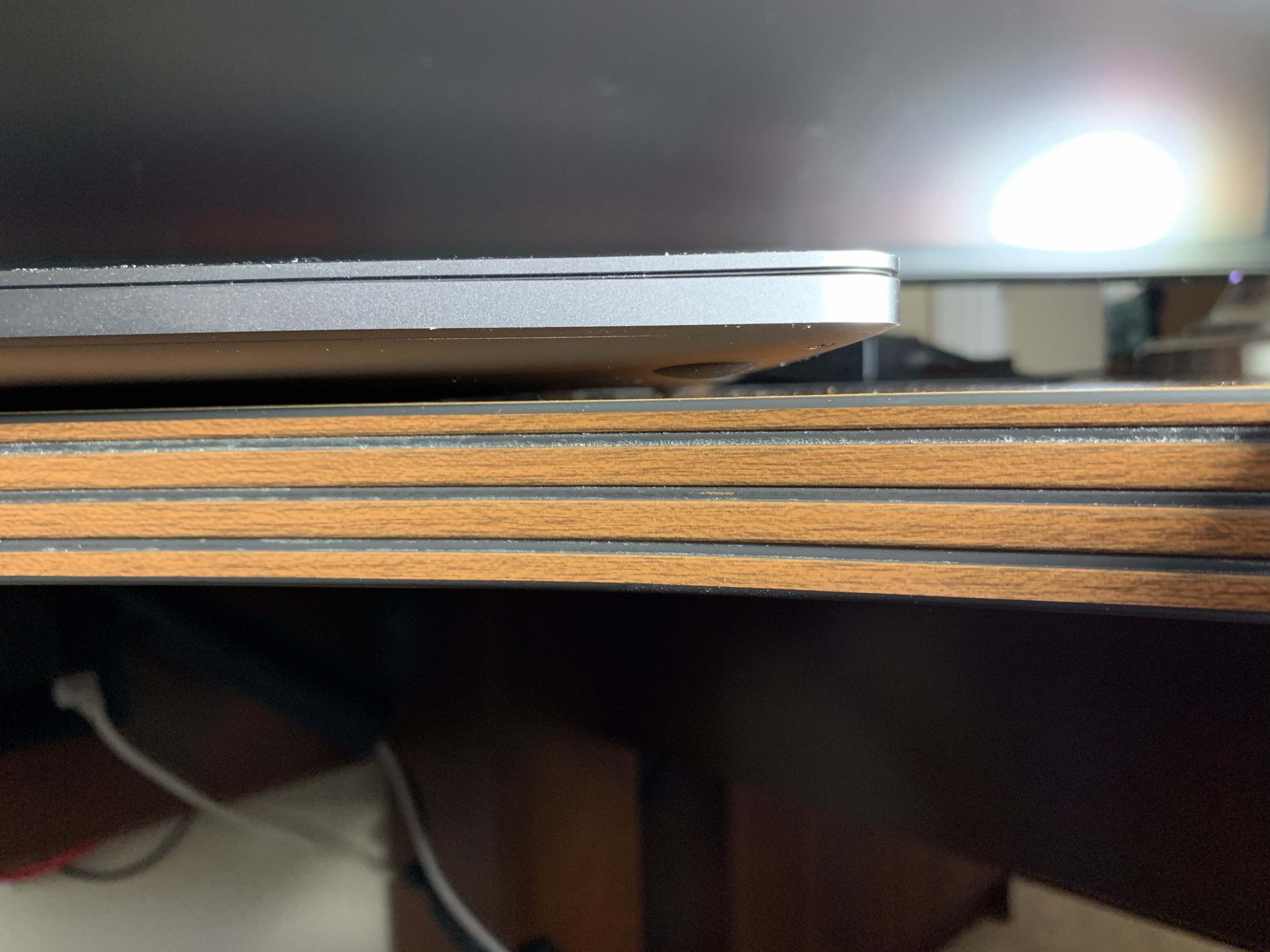

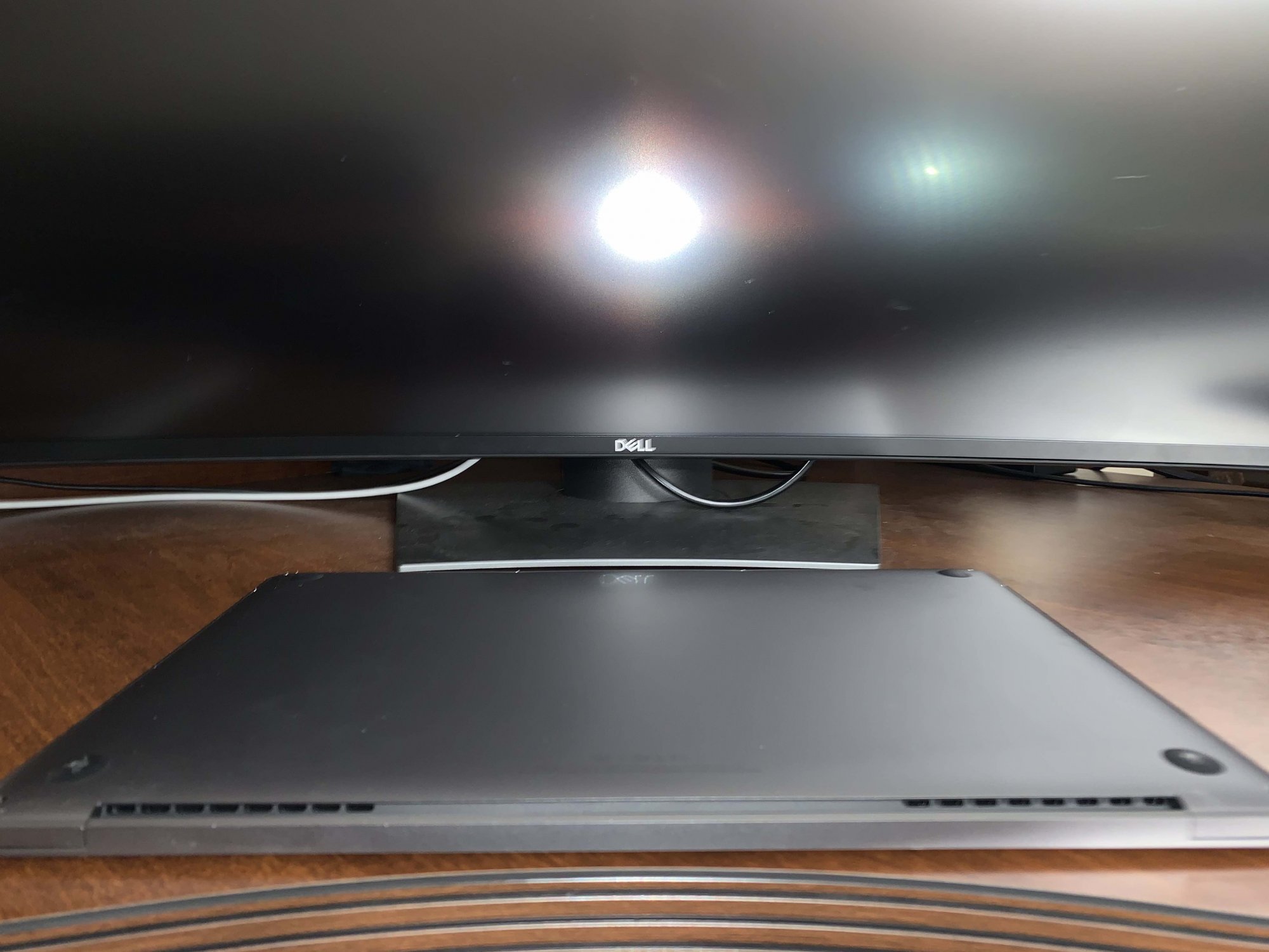

Is my MBP 2018 (2.9GHz 32GB) about to explode? See what I just noticed today:
I have most of the time the MBP connected to its charger, closed and used with an external monitor and keyboard/mouse.
Is my case unique or are there other reports of MBP2018 swelling after one year of use?
You need to have Apple check it out as soon as possible. Appears to be your battery swelling. That can cause damage to the keyboard and other components.

Going in tomorrow, thanks for the reply. Yes, there are cases related to swollen batteries, but most of them are relative to different hardware (MBP2015, etc.). Could not find substantial examples of swollen MBP2018 (yet).

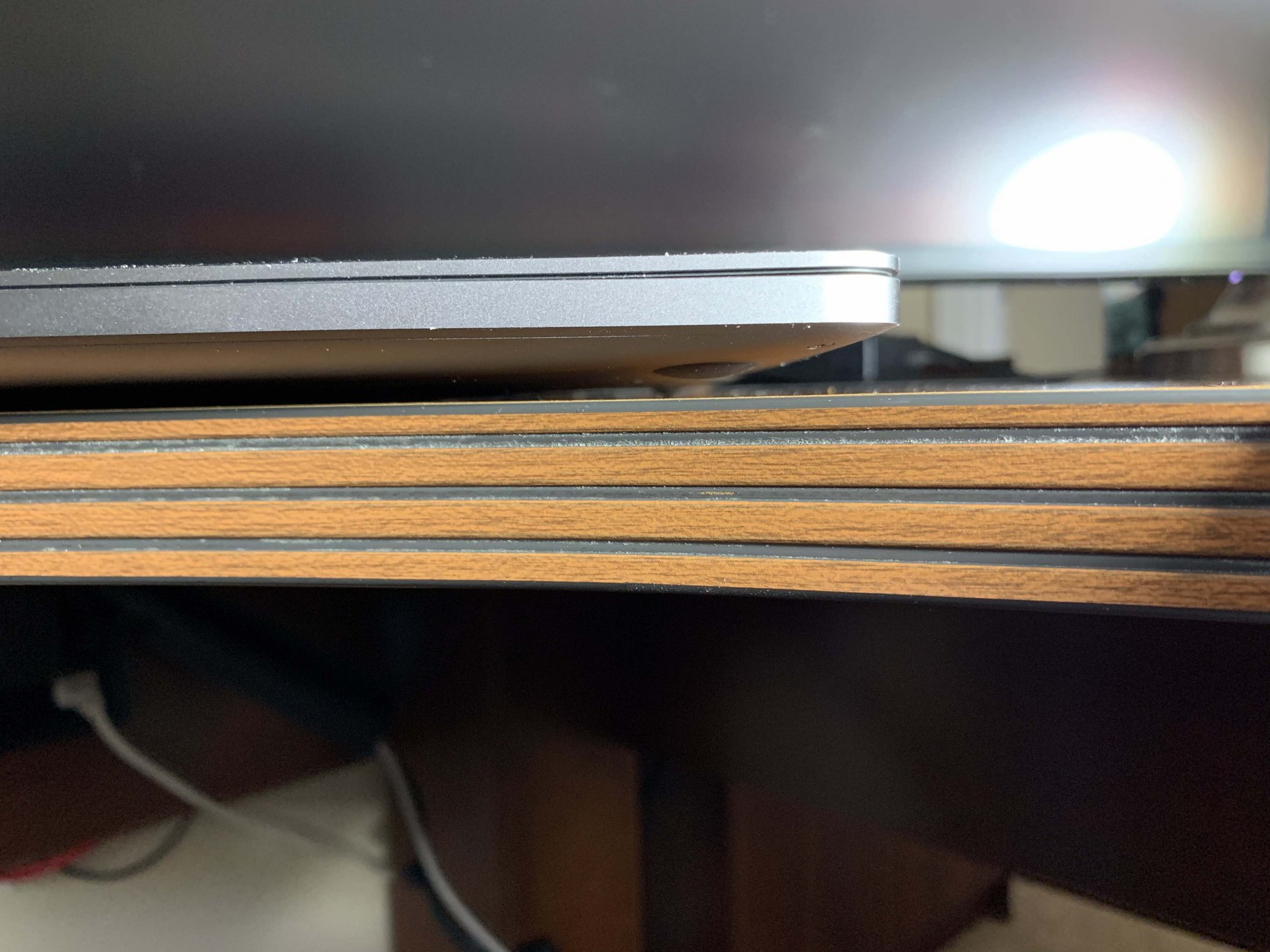

It's in. Top case, keyboard and trackpad need to be replaced. Bottom case probably, given the amount of pressure. According to the Apple technician I spoken with, the probability of getting battery swelling is quite low with this line of 15 inch MBP.

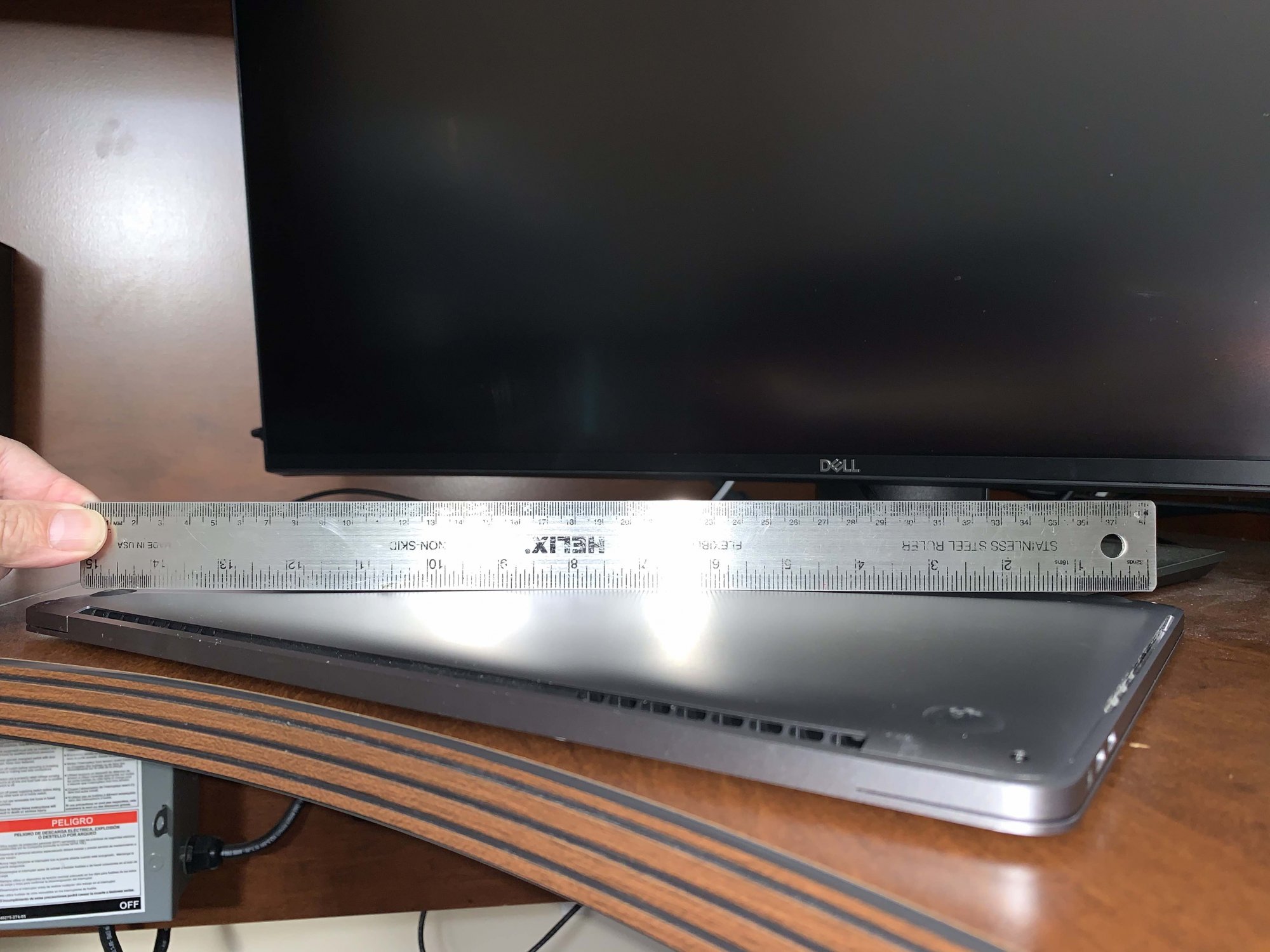

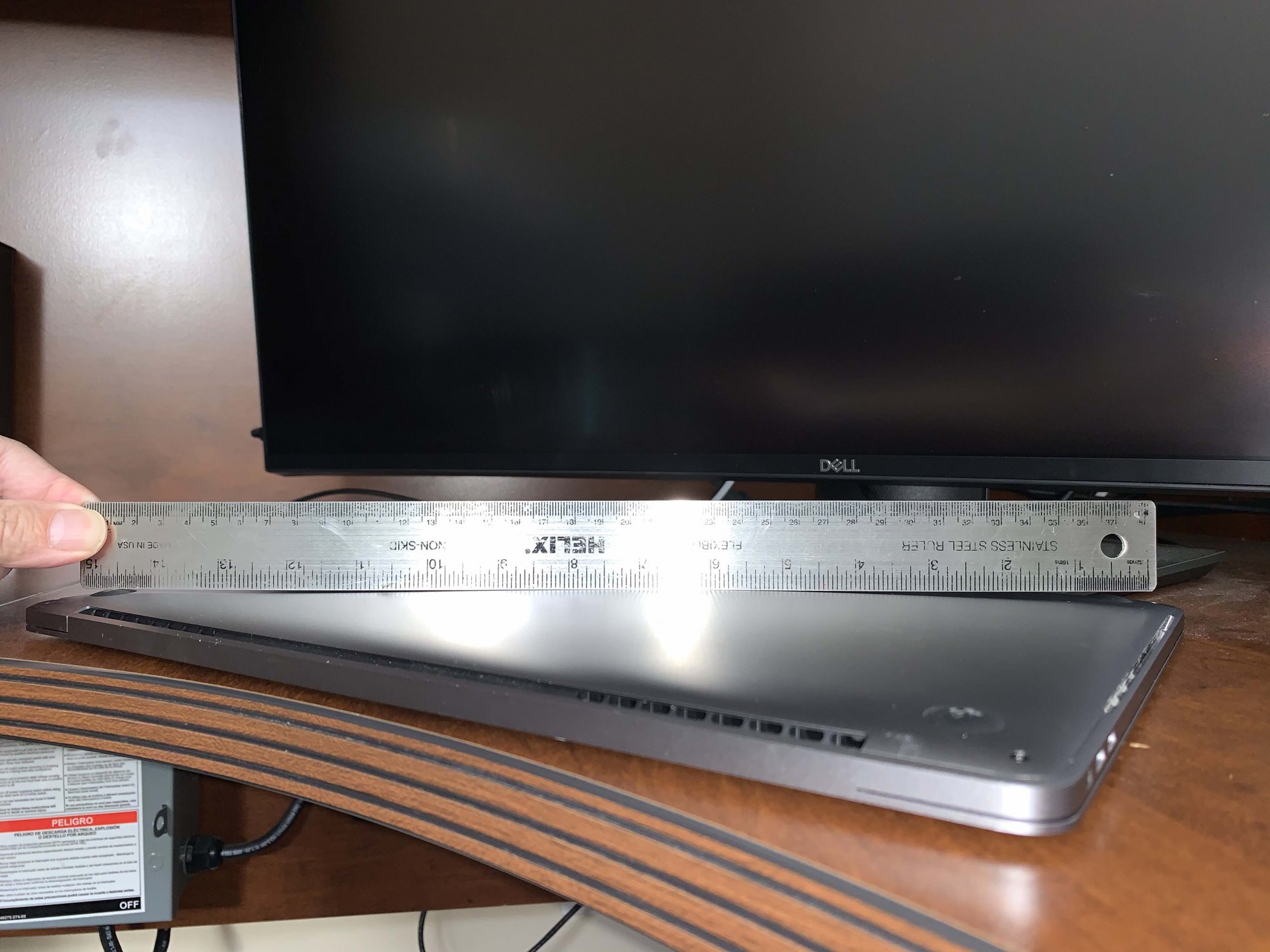

After reading the thread you are referring to, I went ahead and "ruler-tested" another MBP 15 inch (2016 model) that I use at the workplace (owned by my employer). Guess what I found?
My work machine is also (slightly) swollen!
I did not realize it before because all the 4 feet still touch the flat desk surface.
Anyone else dare to ruler-test your own MBP?

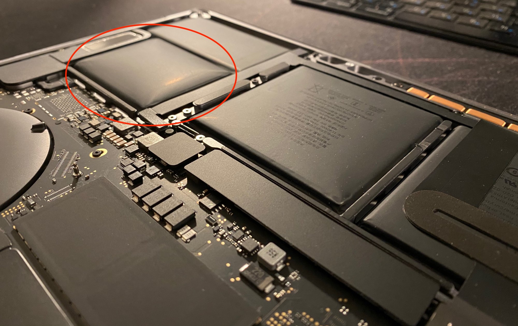

I discovered one of my battery cells had started swelling when I took the bottom off to clean it out for dust on monday this week, delivered it for repairs on tuesday, estimated to have it back on friday.
New top case with keyboard and battery, free of charge even though outside Apple's warranty, I'm happy I noticed it before any damage was done to other components, also MBP 2018.
What a surprise... Has anyone seen swollen battery from other battery vendors than the one in the photo?

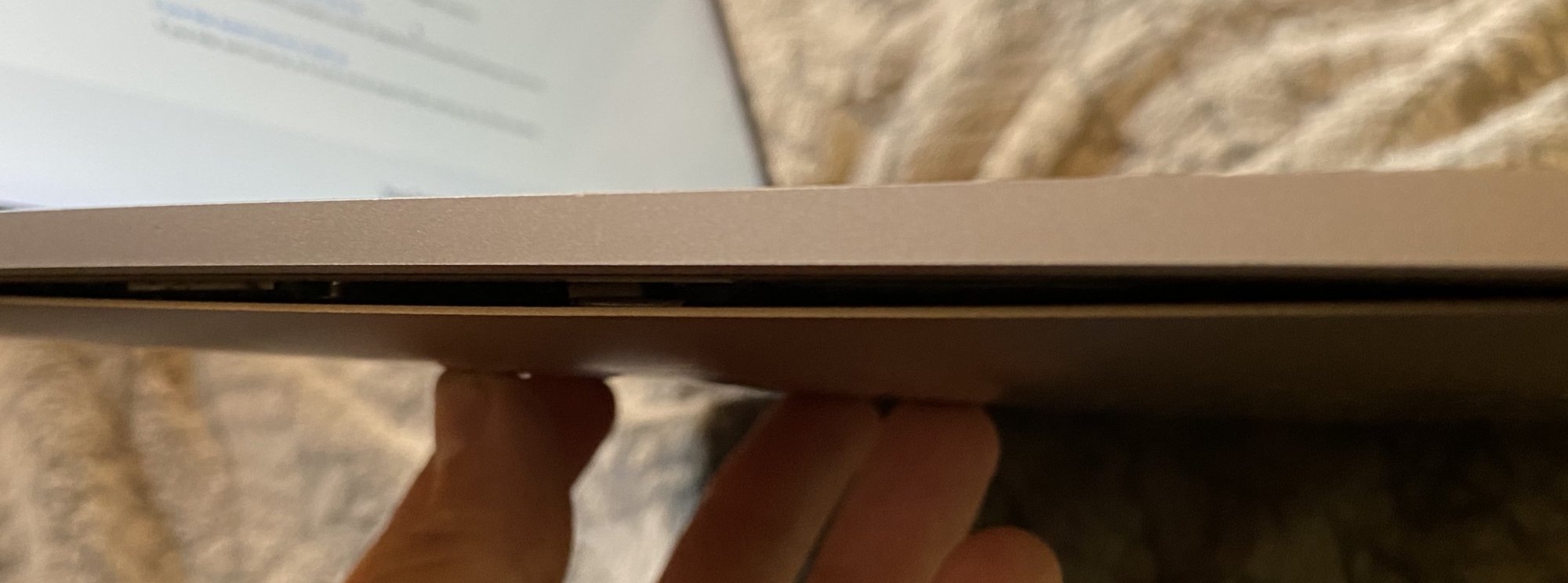

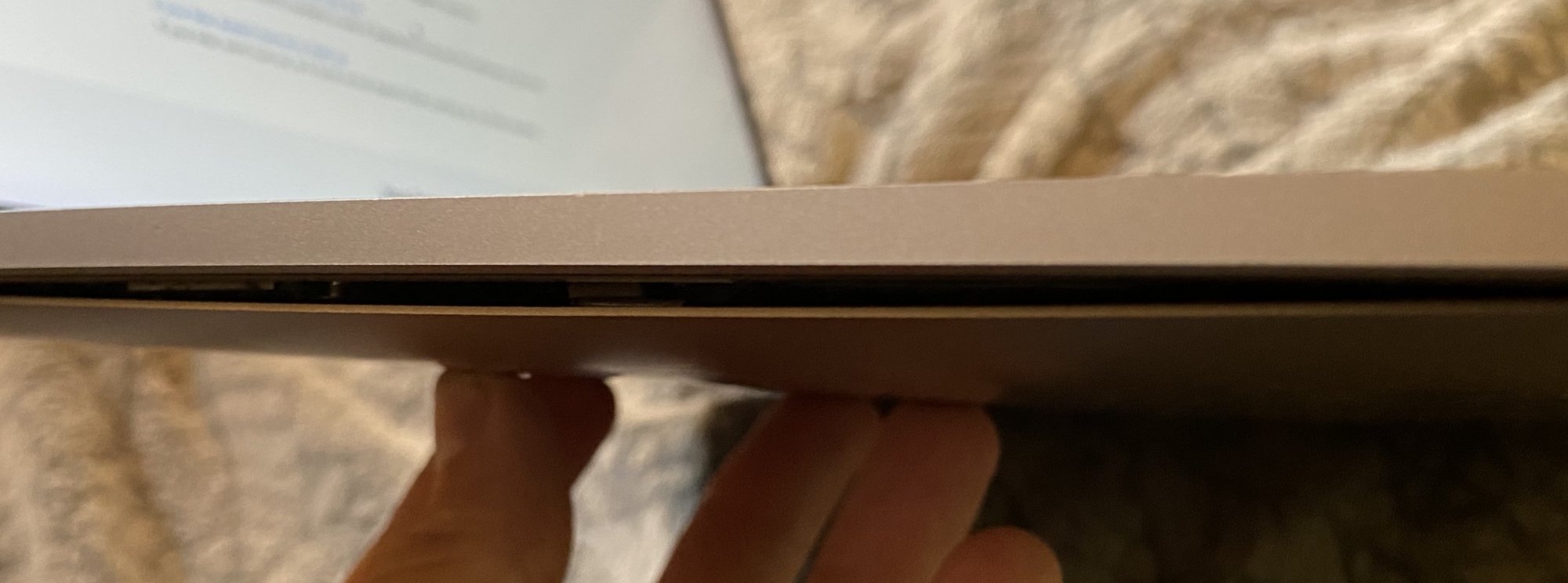

Mine is in a state. 2018 max spec MBP. Already had the motherboard replaced, and now this. Battery swollen so much the back case is popping out and can’t close the lid. Runs stupid hot even when no tasks running I live on a small island so can’t get this in to an Apple store till near the end of the month :/
  • Wow
Reactions: DeepIn2U
Mine is in a state. 2018 max spec MBP. Already had the motherboard replaced, and now this. Battery swollen so much the back case is popping out and can’t close the lid. Runs stupid hot even when no tasks running I live on a small island so can’t get this in to an Apple store till near the end of the month :/ View attachment 877314
Apple authorised resellers repair it for free if it's still under warranty.
Thanks. After the logic board went I got Apple care. There is one on another island which takes a days travel each way and they will take weeks to fix it. Popping home to London soon, and turn around time will be much faster from an Apple store 😉
