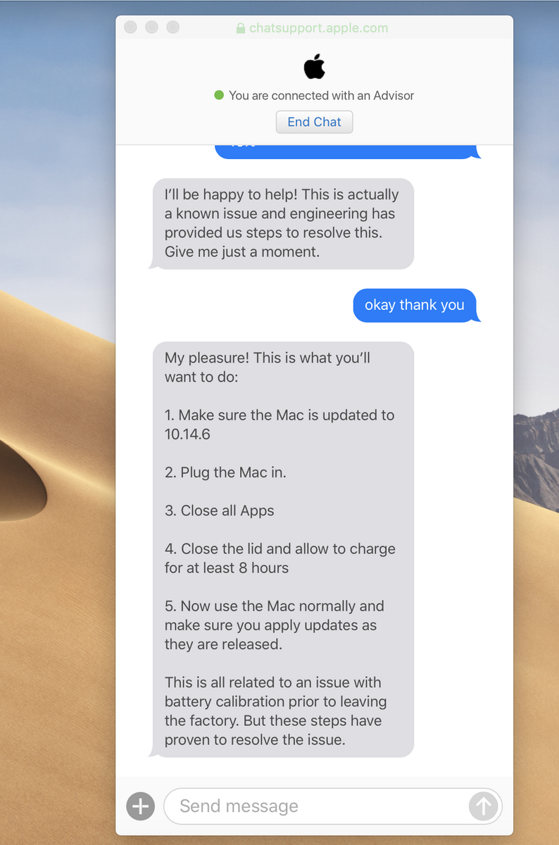

Anyway, this is likely just software or firmware issue. Some have fixed it by doing SMC reset and it was working fine after that, but lately I have heard about the case where the problem came back again later. So hard to say if it is still just bad battery or what.
Another way might be OS update. Have you already installed the latest Mojave OS version it offer in auto updates when you go check there? If not, install it first before trying SMC, then use the machine a while and charge the battery fully and after this you may or may not see difference. In my unit something definitely changed in the way battery meter is working after this update but on the other hand mine never suffered from the unexpected shut downs. Also it seems that battery life is reduced after this update in my unit, so I'm not sure what it does actually or was that just coincidence. Hopefully they did not just solve weak battery issue by limiting how low it tries to run the battery as it definitely seems like part of the capacity is thrown away… For example in my unit before this update I get to use it about 1,5 to 2 hours before battery charge started to drop from 100% the first time, but now just after two hours of use after full charge battery is already down to 77-78%. Seem to get only about 4-5 hours of use with keeping battery still at the reasonable level (I mean not drive it empty but to about 30-40%).
Instructions for the SMC reset you find from Apple site, just follow the instructions for the T2 chip versions, but I suggest you first try that OS update and see if it fixes it and if not, then SMC reset. But again, the new unit should not be doing anything like this and you should not be required to do all kind of tricks to make it work as it should, and if you really should, it should come with instructions telling what to do exactly… So as this issue has not been confirmed by Apple and none of us really knows for sure what is causing it, you may also want to consider keep exchanging the machine until you get one that works as it should right out of the box. Mine did but you are not the first one saying went thru more than one machine and still getting the same issue. Because if it eventually turns out to be a hardware issue after all needing a trip to service center, it is not very nice for the new machine….
EDIT. also make sure that you try leaving the machine plugged to charger at least once for additional few hours (at least 2 hours, preferably overnight) even after it show the battery charge reached 100%.
Here is my solution that finally fixed it for me. Have been going strong for around 1 month.
Just charging it 8 hours straight overnight then performing a SMC reset, I have gotten no issues after!
Battery ranges from 9-10 hours from 100% -> 0%. Doesn't shut down randomly anymore. I am quite happy. Will update if problem comes back.

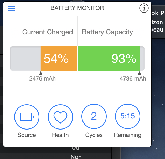

Hello can you give me your battery heath on conocut battery and some other software because mine its running 37 degre all the time I think is too much
My battery health fluctuates currently (in rest or just light load) between 5150-5210 or so. At the moment mine is again in a mood where it does not drop FCC under load but like I said that happened before but was only temporary, so I expect it coming back in a week or two. So far I've had mine about 3 months, and for 2,5 months of that time it has been dropping FCC under load (to around same levels (depending on battery charge level) you posted here)...
Battery does get rather warm even under light load and if keeping it on lap and/or warm environment.
Your 37c sounds pretty similar to mine. Mine maybe around 35c lately when running Youtube videos or charging, but I've been using it in a room temp around 21c. It was warmer during hot summer days.

Could you take readings from CoconutBattery (or similar tool that shows that) how many watts power consumption is usually during your normal usage? As the reading vary depending on load, it would be good to check it few times under different situations.
Anyway, in simple task, like running few to 5 tabs open on Safari and one of the tabs is Youtube playing music to my Airpods can easily take 7-8W to 15W, so if the machine is really using that much power under such simple task, no wonder why battery is draining so fast in my unit but there is something seriously wrong in power management if machine made in 2019 has such bad battery life due to high power consumption in simple task. Not something I'm used to see with similar Windows laptops.
Anyway, I had somewhat better battery life sometime ago, so maybe it is simply aging this fast. I have over 30 charge cycles already. I haven't seen published ratings for endurance for this model, so I have no idea if the battery is rated for typical 300 to 500, or should it still be 1000 charge cycles as in previous models.
