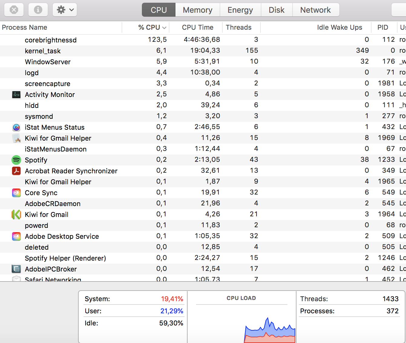

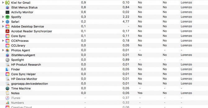

here's a screenshot of the energy consumption and of the CPU activity.

problem solved. I noticed just now that there was a process that was using 120% of the CPU(corebrightnessd) and after some research I found out that it is related to the nightshift mode. After disabling it the temperature dropped at once and the energy consumption is apparently back to normal. Thanks for your help
