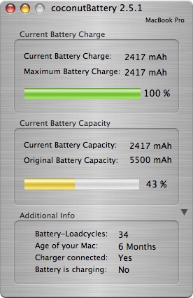

I've had the new battery for about a month now.. check out the reduced power! What is up do you think?
Battery down to 2417 mAh or 43% (if you can't see my attachment)
