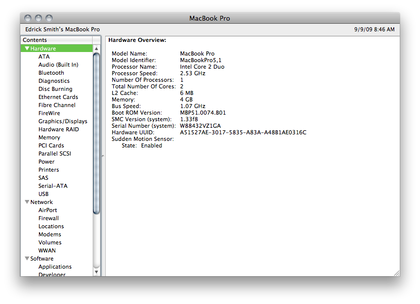

have you had to update the 1.7 firmware update? AS far as i know it only affects newer machines, the reason your getting an circle with a line thought it is probably because you do not have the firmware 1.7 its supposed to roll back. personally i would visit an apple store.
I'll be going in tomorrow as far as the firmware issue goes I'm not sure which one I'm running I tried looking in system profiler but perhaps im having tunnel vision since im pissed at the computer.

Btw, yes, you do have a late 2008 MBP which shouldn't have EFI 1.7 firmware issues.
Nope its a Seagate 7200 RPM Drive but from what I've read people with this MacBook Pro have also had the issue. From System Profiler am I running 1.7 or 1.6?
