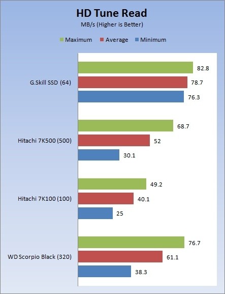

Can i ask what the read / write speed for a 7200rpm drive should be?
Earlier this week i posted a screenshot showing a read/write speed of about 71mbs.
After updating to EFI 1.7 and applying the Performance update i am still only getting 71mbs . .
The read/write speed for 7200rpm drives may vary greatly. It may even be less than a fast 5400rpm drive in some cases. What's missing is the bit density on the platter. A 7200rpm drive spins 33% faster than a 5400rpm drive, but if the bit density on each platter of the 5400rpm drive is 33% or greater than on a given 7200rpm drive, the 5400rpm drive will be faster because more bits are passing under the head.
So, it's hard to make a blanket statement of speed for 7200rpm drives. What is safe to say, however, is that conventional laptop hard drives never reach the bitrate ceiling of the SATA I interface, so it makes sense that you didn't notice any change. For some SSDs, however, this is a different story.
