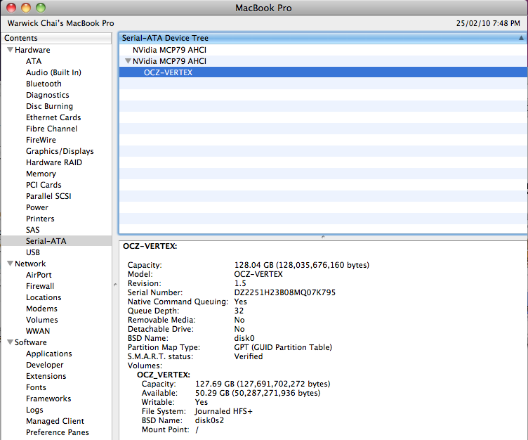

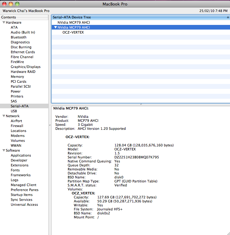

Hi All
I have been experimenting with an OCZ and a CRUCIAL M225 which has refused to work in my brand new MACBOOK 5,3 15inch MID2009
I have tried
- EFI 1.6 and 1.7
- SSDs (OCZ and CRUCIAL)
- SSD in SDD bay and in the OPTIBAY
And i can tell you this will not work (well it doesnt work for me) IF
- you have EFI 1.7 running at 3GB/s
- SSD or other drive that can push the 3 GB/s channel
- and you use the HDD bay
I personally think the cable is the problem, as i can get this to work fine on the OPTIBAY controller port.
Am going to try to insulate the cable on the HDD bay, some users have reported success with this. But if you are looking for a solution in the interim, looks like the options are
- roll back to EFI 1.6 (files can be found online - contact me if you cant find them - this works!)
- buy an OPTIBAY hdd kit to put the HDD where the DVD drive is (this also works!)
- insulate the cable with foil/insulating tape. Am going to do this on the weekend.
I am getting 230MB/s READ, 161MB/s WRITE on the EFI 1.7 at 3GB/s. You can see the full write up here
Hope this helps people who were pulling their hair out like i was trying to get this to work.!
