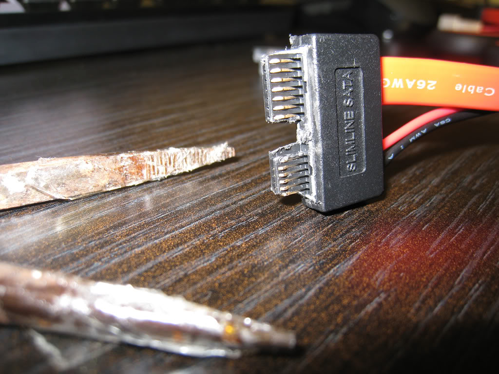

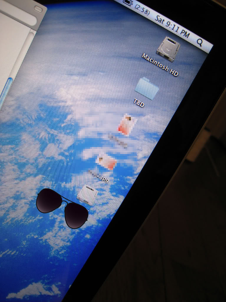

It appears that the other SATA port isn't affected...
I did some DIY to get the optical drive sata port to run my intel ssd. And it works fine.
The black specs isn't suppose to be there. just to censor out my drive name.
