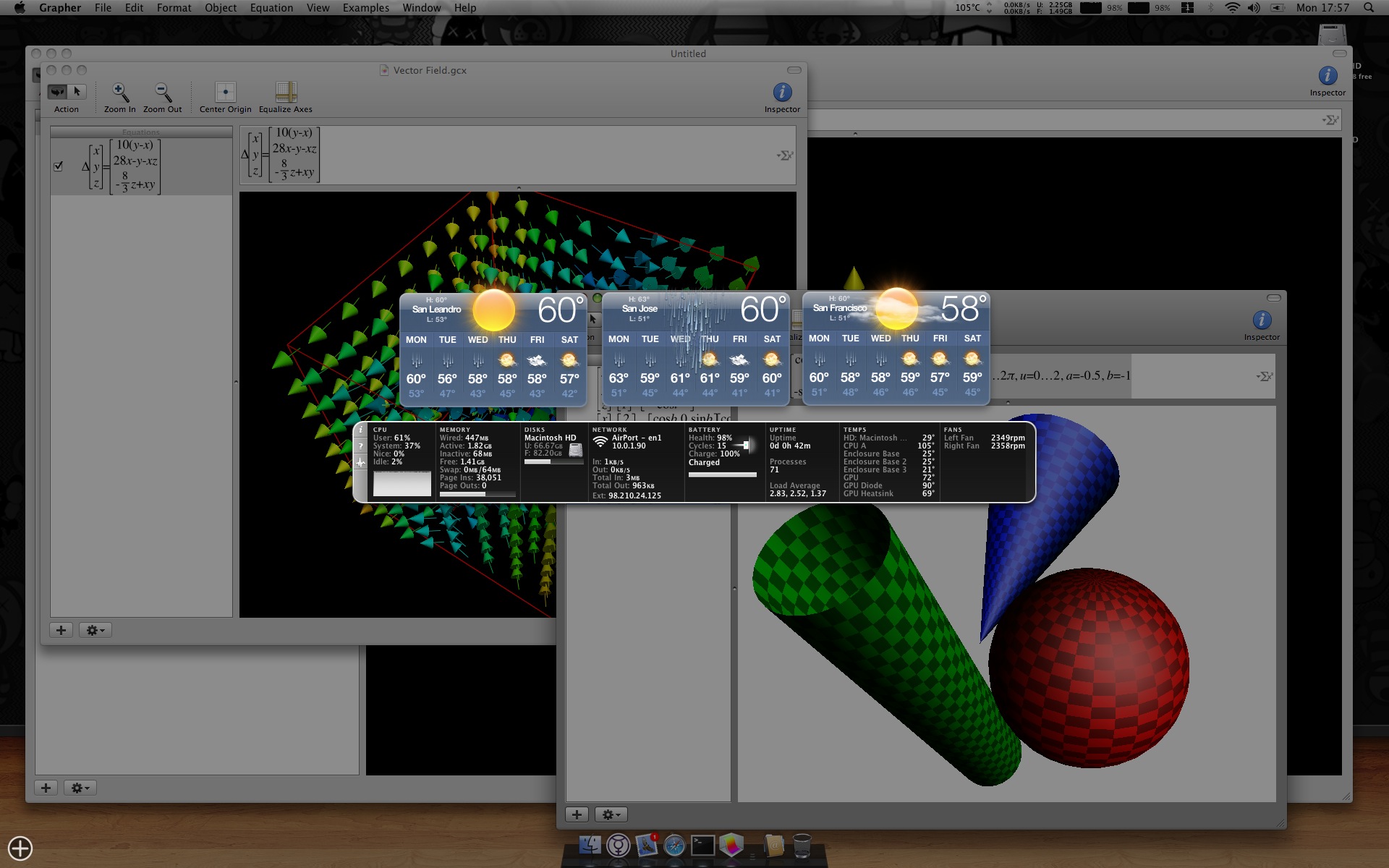

My 17" MacBook Pro hit 110 deg C before it started revving up the fans. w00t. I beat ya'all. lol. I think this "yes dev > null" is somewhat confusing OSX. I can watch a youtube video and it'll rev up the fans way before 100 deg C.
Here's a pic after the fans started going up.
With those temps the fans should be working at 6000 rpm.
Try resetting SMC and make another test, the fans should rev up around 75 C.
The problem is after a restart/pause, fans stay lazzy again.
