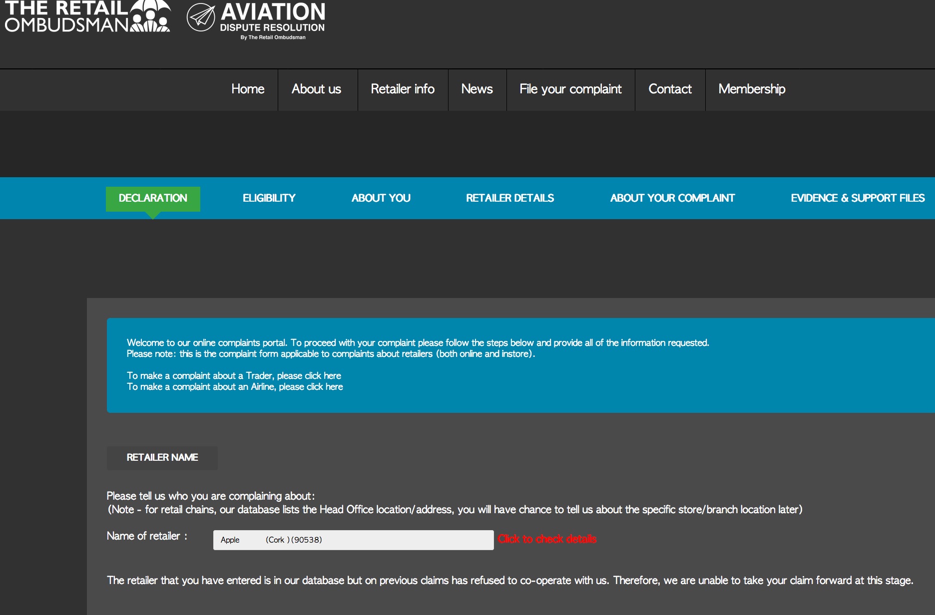

So in my case I went to the Apple Store and got told to **** off basically. So I went home, called Apple Care and said I'd like to make a consumer law claim, I was then transferred to a senior advisor.
He explained the process, I needed a to get a report confirming the issue and my proof of purchase and then they processed this interbally. 1 week later they agreed the decision to replace the machine.
Referring you to the body is useless, they're walking all over you and or you haven't gotten to the right people.
What have you done so far that resulted in you getting a response from Apple Legal?

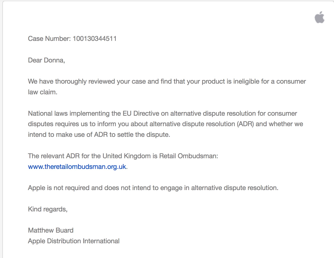

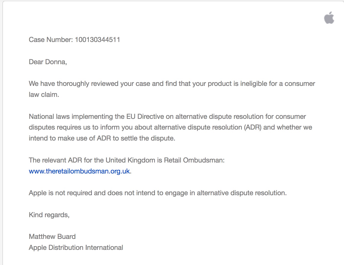

I'm actually not that convinced that the reponse is even from their legal team and that this above message might just be a generic "fob off" to get me to go away!!
Did you respond to ask how they came to that determination?
Ultimately the rules for a consumer law claim are simply there has to be a manufacturing fault from the start, their replacement program indicates this.
I think you need to ask their reasoning for that responsive and set out exactly why your claim meets the criteria as defined by law.

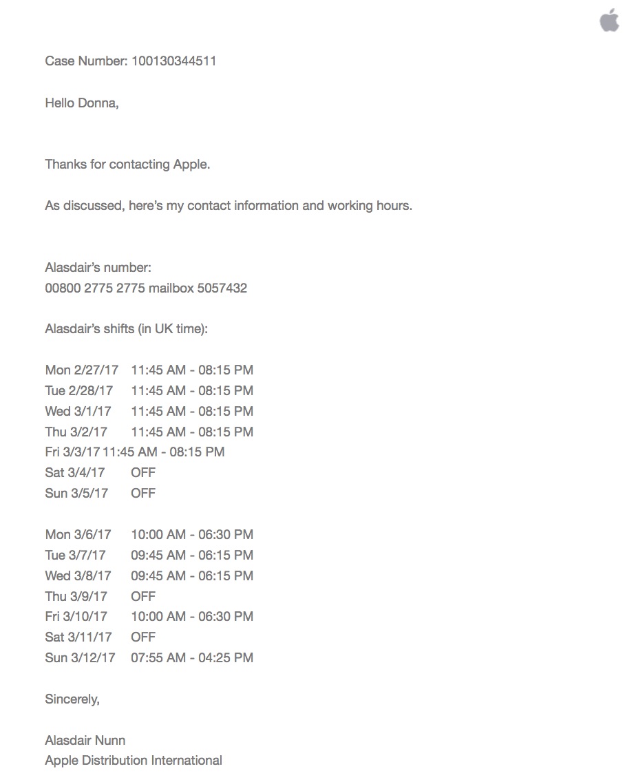

Any pointers on which team I should ask for, I'm pretty certain the last person I spoke to claimed he was Senior but the automatic email you get after talking to support didn't have it outlined under his sign-off 😉

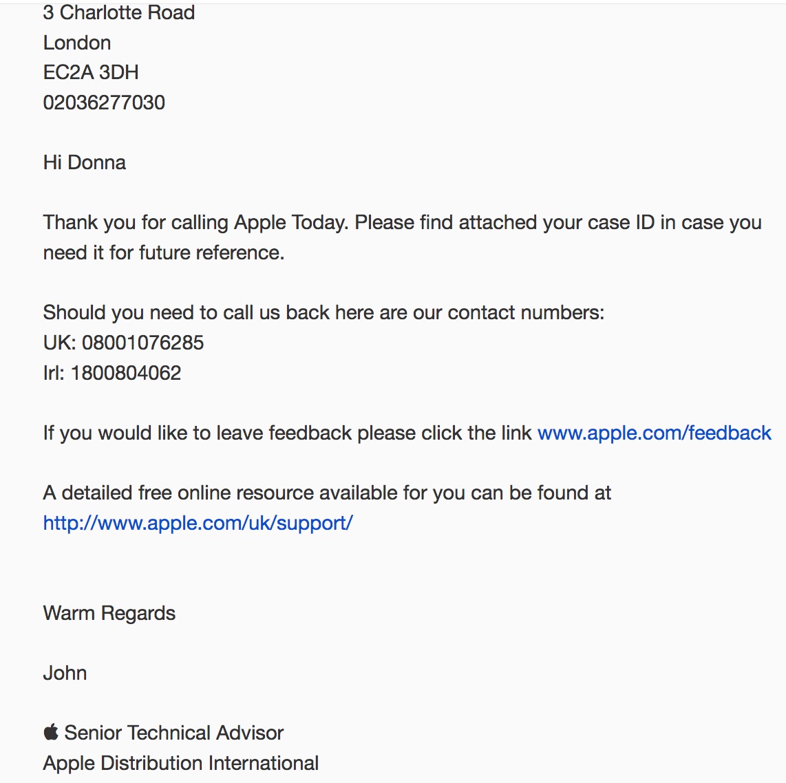

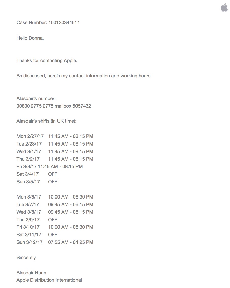

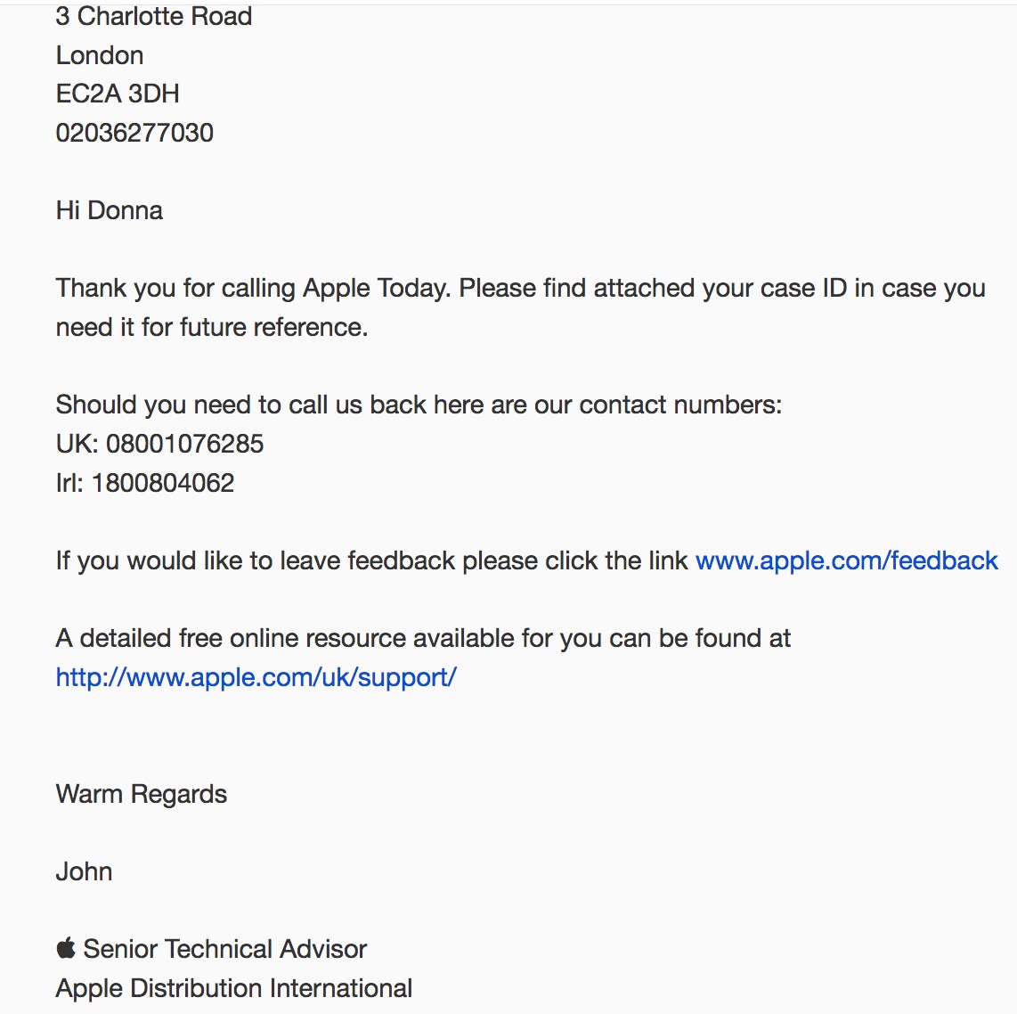

heres a screengrab of an email from a senior tech I've spoken too and then below that is an email from the last guy I spoke too who told me to only get in touch with them through lawyers from now on.
You can clearly see John's says Senior and Alasdair's doesn't, yet he was quoting all sorts of law info to me.
BTW I have it all recorded too as I was told to make a claim I might need it, since they've been messing me about.

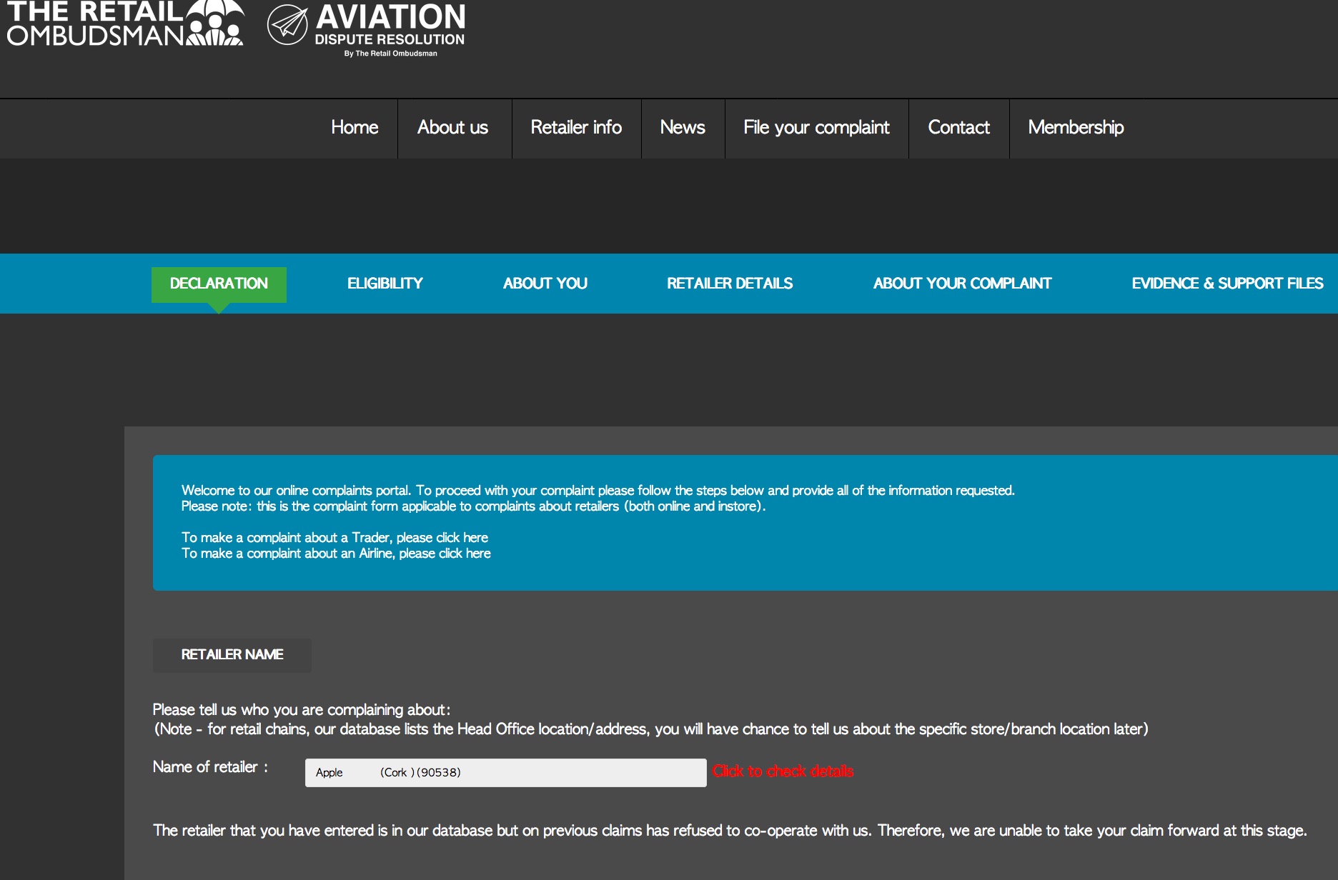

Just checked out the Onbudsman website - does anyone work with them? Tried Argos, Tesco and Currys.
@hotmetal @brandscill Hi there, so I called Apple back this morning and after an hour of going through my case and me repeating all the reasons why I have not received a similar outcome to you guys they basically said that I can only get a different resolution if I get my own lawyers/solicitors involved (at my expense) to make a claim against their decision to not act upon the consumer law of a Replace or Refund outcome. I'm not allowed to contact them myself.
When I asked Apple what were the reasons given from the lawyers to refuse my claim, he suggested that it was because I had never complained about the issue in the last 4years.
Obviously I then retorted back to them that as my applecare had expired and the fault was very intermittent I thought it would cost me just to call Apple for any help as I have never used them before and just presumed any support given would come at an even futher cost to me, so just put up with it crashing every now and then.
Plus as I was using it for 16hrs+ a day I just thought it might have been overheating and was a simple fan issue.
The support guy also suggested that even though you had both been given better outcomes from legal thus far it was most likely because you had probably complained or had your laptops in for diagnostics checks prior to the December 2016 cut-off of the repair program, is that correct?
Where'as my first complaint and then diagnostics check wasn't until February 7th regardless of the fact I have proof (crashplan reports) that it had stopped working since early December.
So essentially there's no point me contacting technical support/applecare anymore their lawyers decision is final.
I can only go via a civil action claim or try and find some sort of 'ambulance chaser' solicitors that may give me some free advice or even want to take on a corporate bigwig on my behalf, and all the usually free government ombudsmans and trading standards can't help either.
Okay so it has worked for 5years but with the known manufacturing fault apparent it feels as I've been sold a machine with it's very own built in obsolescence.
I really am just utterly bereft that they are refusing to honour a better outcome.
