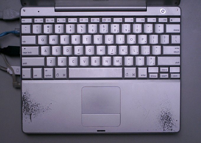

It's called pitting. When the anodizing gets rubbed and eroded away by your hand and the oils, it leaves the aluminum exposed. Aluminum itself does not hold up well when directly exposed to air, which is why it is anodized to give it this protection. This reacts with the air and causing "pitting". Not really anything you can do about it.

Anodizing is a very complicated chemical/electric process, its not something you can just paint on. You could put some very small amounts of clear paint in those holes to stop the metal from reacting with the air.
Once the anodizing wears off you will start to get little holes like these, which looks pretty similar to what is going on with his edges. Poor design imo.

Metal polish not only shines but protects bear metals from air as well. With this being on the edge i dont think there is much you can do.
I would put clear nail polish so that it fills in the holes and then wipe the rest of it off. Hopefully it will dry and fill in the holes.

then aluminum is worn out.. when i touch i can feel the roughness through inside. You think this is normal? Or should i send this back to service?
This is the image
