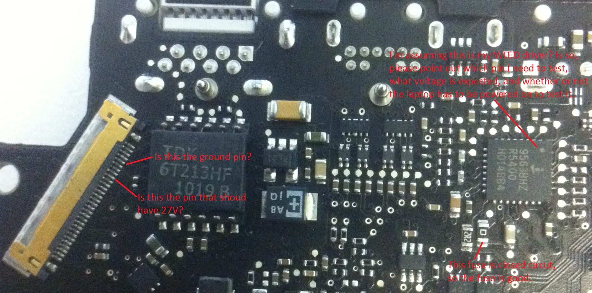

I have an A1342 with a similar issue - no backlight. I checked every fuse on the entire board, and they're all good, but still no backlight. I'm thinking the WLED driver is the culprit, but want to figure out exactly which pins I need to test to verify that the problem is the WLED driver. Also, if this is a blown driver, are there any compatible parts that I can use, or does anyone know where I can buy one?
I don't know for certain but I would be surprised if they did not use the same pinout on the LVDS connector as they do on the other 13" models. In that case the backlight voltage is on pins 21 and 22. See if you can find a better place to measure that voltage since you don't want to slip with your probe while you have power on. I usually measure on the cathode of the boost diode if it is on the top.
In that image I uploaded, is the chip on the right that I'm suspecting to be the WLED driver actually the driver? And what pin on that should I be testing. Would the previously listed pin voltages be the same even if that is a different driver? Luckily, those pads seen around the driver are large enough to get at with a regular probe, so I can measure those much easier. For checking the toes of the LVDS connector I would need much thinner probes.
I just noticed a new symptom now that the board is clean; After disconnecting and reconnecting the battery and powering on the macbook, the screen flickers and then goes black, so it's turning on the LED backlight but only for a fraction of a second.
