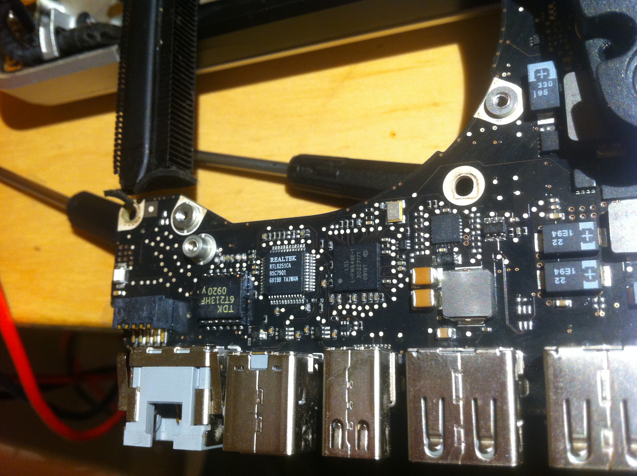

So, my 15" mid-2009 Macbook Pro (2.8GHz CTO, A1286) suffered a spill...
And here's a photo the bottom of the logic board near the LVDS connector. The WLED driver (a L8543SQ) is the square chip below the screw hole, and I'm pretty sure the fuse is the little guy with a dot a bit over to the right. I checked the resistance on the fuse and got 0.3 Ohms, I think. Or my probes were touching, who knows. They're not nearly precise enough to be doing this. But I'm pretty certain the fuse is fine as I wouldn't get any backlight if that were blown. LVDS cable connector and the connector on the board looked perfect to me. Gave the whole WLED area another once over with alcohol and a brush now that I know where that is. I see some tests others have done but unfortunately this is all on the bottom of the board and not easy to get to when the system is running. Is there anything I can do to diagnose this further from the top, with the clunky probes that came standard with my Fluke 114?

You probably shorted that cap, or flux/solder shorted something surrounding it.
Yes, thanks again for this. Try going back a page and looking at my linked image. The part I replaced was a fuse, located directly underneath the bottom of the start if the arrow. I understand the pic is pointing to a cap, I justaren't reused the image. The part I took off had a dot on top. And if I am completely wring, and the part with a dot on top is a cap, would you be so kind as to tell me the values of it?????
That's wonderful, but it's an IC, just make sure no flux or solder got past and shorted other components, and make sure your botched fuse is connecting to the board on both ends, not just to the faulty fuse.
Eventually got the faulty one off, no problems there (now). Fuse is connecting to board and multimeter checks out fir both sides. I got a 1.2k resistance between the left side of fuse and the lower "ground plane" ( I am assuming it is that)
As for flux, used none, I was able to solder on to the pad verrrry carefully. Took me a while, but hey, it worked 🙂

I managed to repair my fuse using a $20 soldering iron and a $6 tips package. I use a MAKE: branded iron, its on their website. Got it as a gift.
That, coupled with magnification and a friend holding a flashlight, a pair of tweezers, and some 91% alcohol, it turned out fine.
Basically, if it works right now, and you got the fuse off, you did the hardest part. It took me ~1 hour to remove the fuse, and 5 minutes to get it back on. If you arent willing to spend much money on it, look for someone local...
